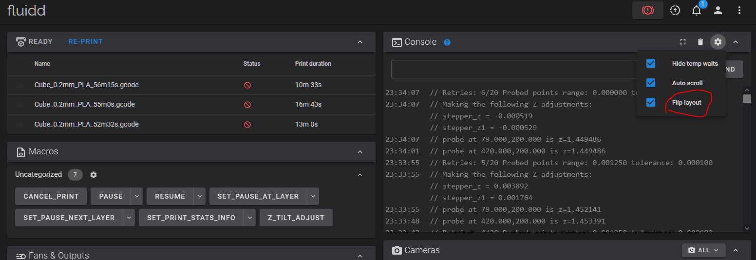

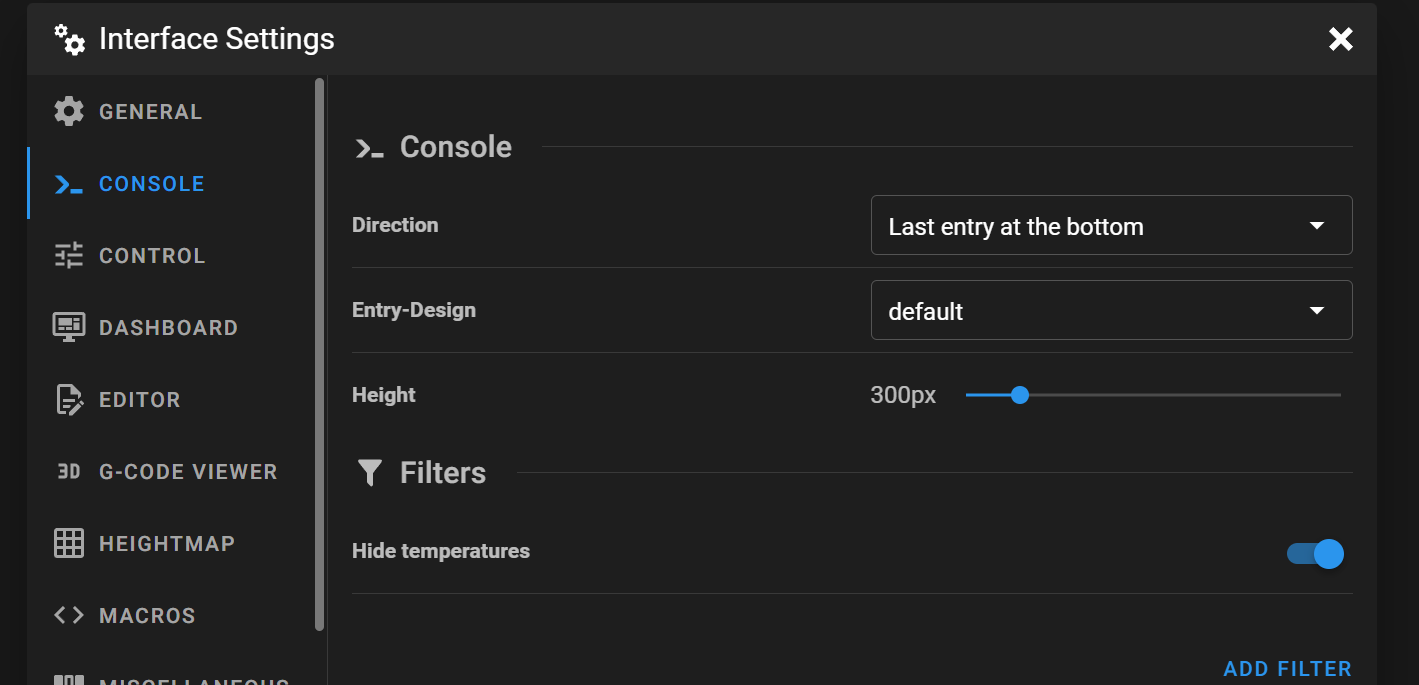

Side note: What disturbs the most is that Mainsail/Fluidd terminal list in reverse order. Oldest bottom, newest top.
Everything is timestamped. You can also reverse the order with a simple setting.
Well hell, You can in Mainsail too.
I’m with Eddy, I was always annoyed by it but never looked to see if I could change it.
Good to know.
