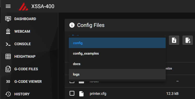

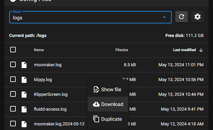

And it’s not in /tmp/ it’s in ~/printer_data/logs
So, what’s this klippy.log that I have in /tmp?
I don’t have a ~printer_data folder…
Maybe you’re not using the same Klipper as the rest of us… :thinking: :thinking: :thinking: :thinking: :thinking: :thinking: :thinking:
I’m just kidding, I was semi mistaken, it can actually be located in either one.
That thought had occurred to me…

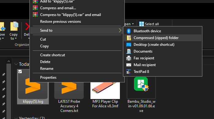

Are you using Fluidd or Mainsail? If in mainsail, you can select the log section then download to your pc. then right click it and compress it. If in Fluidd, I am not sure (I havent taken the time to figure that out yet).
