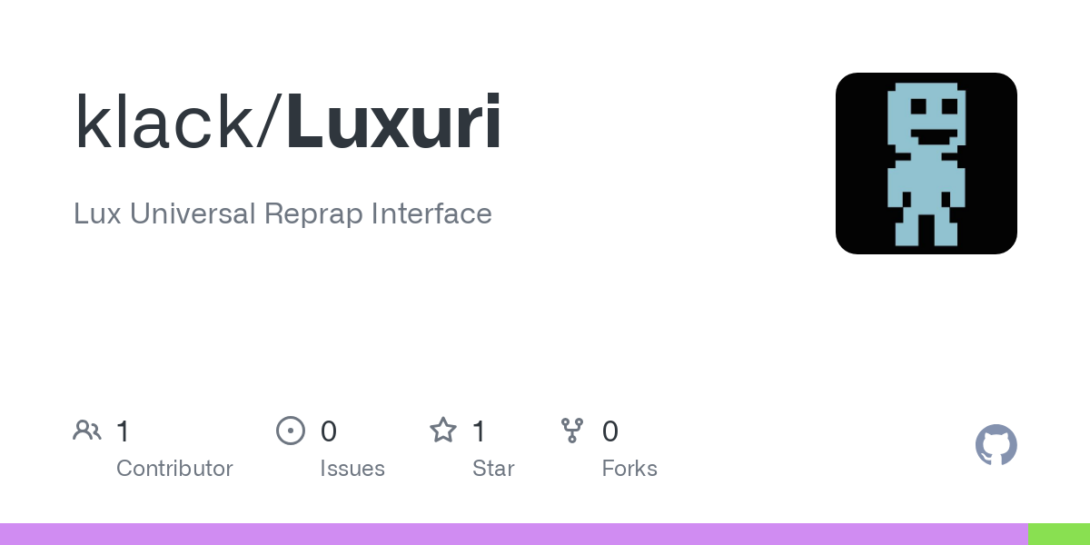

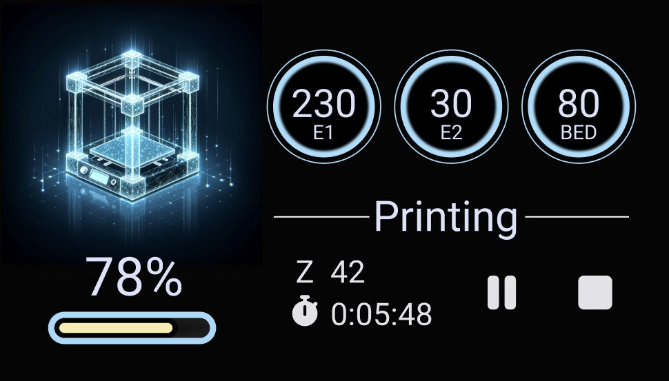

The primary end goal is to port my existing 3D printer interface to Klipper. A proof of concept can be seen here:

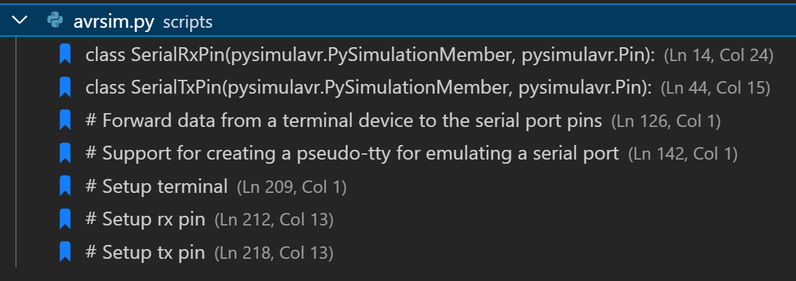

This file has a lot of interesting things in it. It appears to be doing exactly what I want but instead for pysimulavr.
I’ve made the following bookmarks as I go through the code:

Instead of integrating any specific screen, I aim to provide a small, foundational feature that will support a variety of use cases.

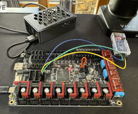

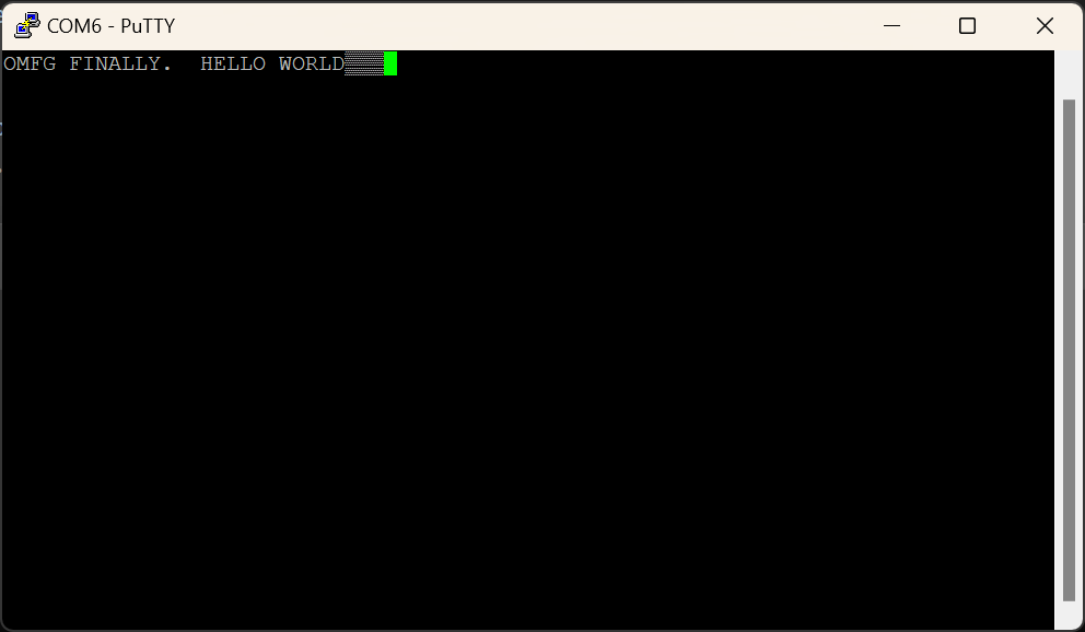

Last week provided a great success. This output is using UART2 on the Octopus to send serial data to my FTDI USB to serial adapter.
Could you share the details or do you have a git?
I may have another use case for this.
Thanks
Let me know if you have any questions. Currently this is hardcoded to a Octopus Pro H723. It should work with any SMT32 board.
