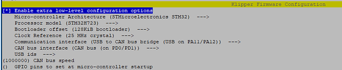

Hi,
I have been using my Voron 2.4 using a Stealthburner with a EBB SB2209 CAN (RP2040) without problem for months but I wanted to use now a H2 V2s Revo extruder connected with a EBB36 board.
I run into a problem flashing Klipper and Katapult on the M8P.
Everthing worked fine until I tried to query to see if M8P shows up with a UUID:
`biqu@bigtreetech-cb2:~$ python3 ~/katapult/scripts/flash_can.py -q`
`Resetting all bootloader node IDs…`
`Checking for Katapult nodes…`
`CANBus UUID Query Complete`
Checking for Katapult nodes… CANBus UUID Query Complete No UUID detected while the CAN bus seems configured:
biqu@bigtreetech-cb2:~$ sudo ifup can0
ifup: interface can0 already configured
I tried to reinstall everything from scratch, including the SD card but I still get the same problem.
Would you have any suggestion

I created a new SD card using CB2_Debian12_Klipper_kernel6.1_20250429.img
Checked it with KIAUH
Updated all the packages from Mainail
First thing strange
sudo systemctl restart networking.service
does not report any service !
I nevertheless installed Katapult
git clone https://github.com/Arksine/katapult
sudo nano /etc/network/interfaces.d/can0
allow-hotplug can0
iface can0 can static
    bitrate 500000
    up ip link set $IFACE txqueuelen 1024
cd ~/katapult
make menuconfig
Create Klipper firmware for the M8P
Flush Katapult

cd ~/katapult
sudo dfu-util -a 0 -D out/katapult.bin --dfuse-address 0x08000000:force:leave -d 0483:df11
File downloaded successfully
dfu-util: Error during download get_status
Flushed Klipper
cd ~/klipper
sudo dfu-util -a 0 -d 0483:df11 --dfuse-address 0x08020000 -D ~/klipper/out/klipper.bin

IIRC, this command may not return correctly
  • when multiple nodes are connected
  • when Klipper has already configured a node
On the contrary, it might even force nodes into an error state that requires power-cycling of the node. There is a warning in Katapult’s readme.
Did you stop the klipper service?
Finally I reflashed all boards with CB2_Debian11_Klipper_kernel4.19_20240716.img, there were too many weird problems with Debian12 and I prefered to revert to version 11 I was sure to work.
I have been able to flash the EBB SB2209 CAN (RP2040) and then the EBB36.
It seems it is indeed necessary to stop the klipper services before flusing Katapult.
I was not sure if the EBB36 could work with a speed of 1000000 but it seem ok.
Thank you for your help.
