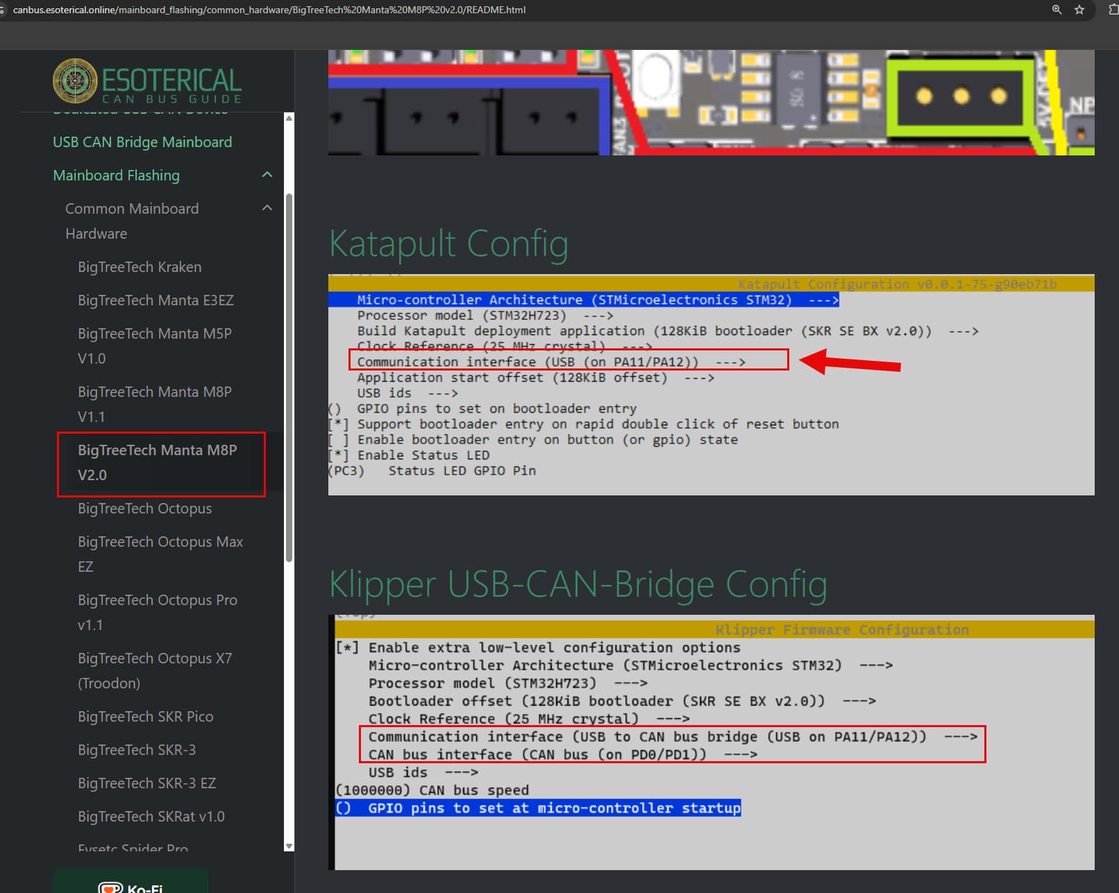

I followed this but can get the board into CAN mode…
Is this correct config?
That’s what I use for my printer that uses a Manta M8P V2.0.

I am following steps from this https://canbus.esoterical.online/

I referred the website https://canbus.esoterical.online/ and successfully installed OS image and other stuff on Manta 8P V2 + CB1 + EBB42 V1.2.
Thanks all for the help you provided.
