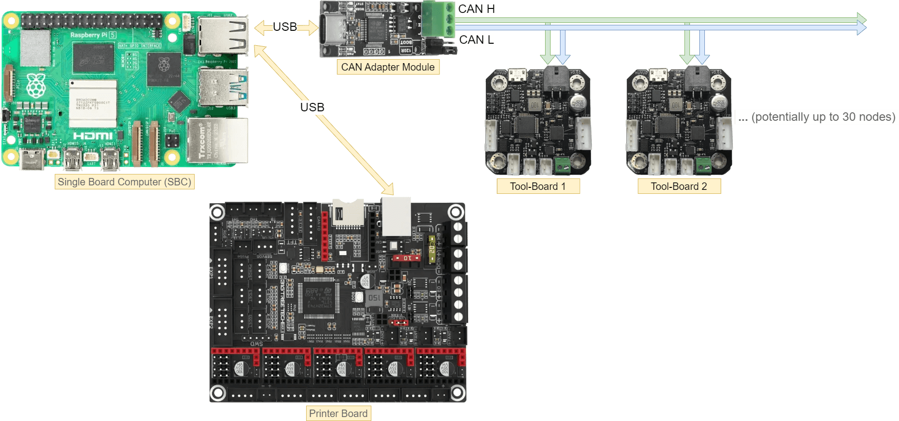

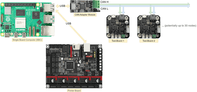

2.1 Standalone CAN
Description:
  • A CAN Adapter Module is connected via USB to the SBC and is the “start” of the CAN bus.
    • This adapter needs to be terminated to 120 Ω by setting respective jumpers on it.
    • From this adapter, two wires (CAN H and CAN L) will start the CAN bus.
  • One or multiple further CAN boards, e.g., tool-boards, are connected to this adapter.
    • The boards “in the middle” of the CAN bus must not be terminated.
    • The last board at the end of the CAN bus must be terminated to 120 Ω by setting respective jumpers on it.
  • Another printer board that supplies the rest of the printer’s hardware is traditionally connected via USB to the SBC.
  • Not shown: The printer board and all the CAN boards need a connection to the main power supply unit of the printer.

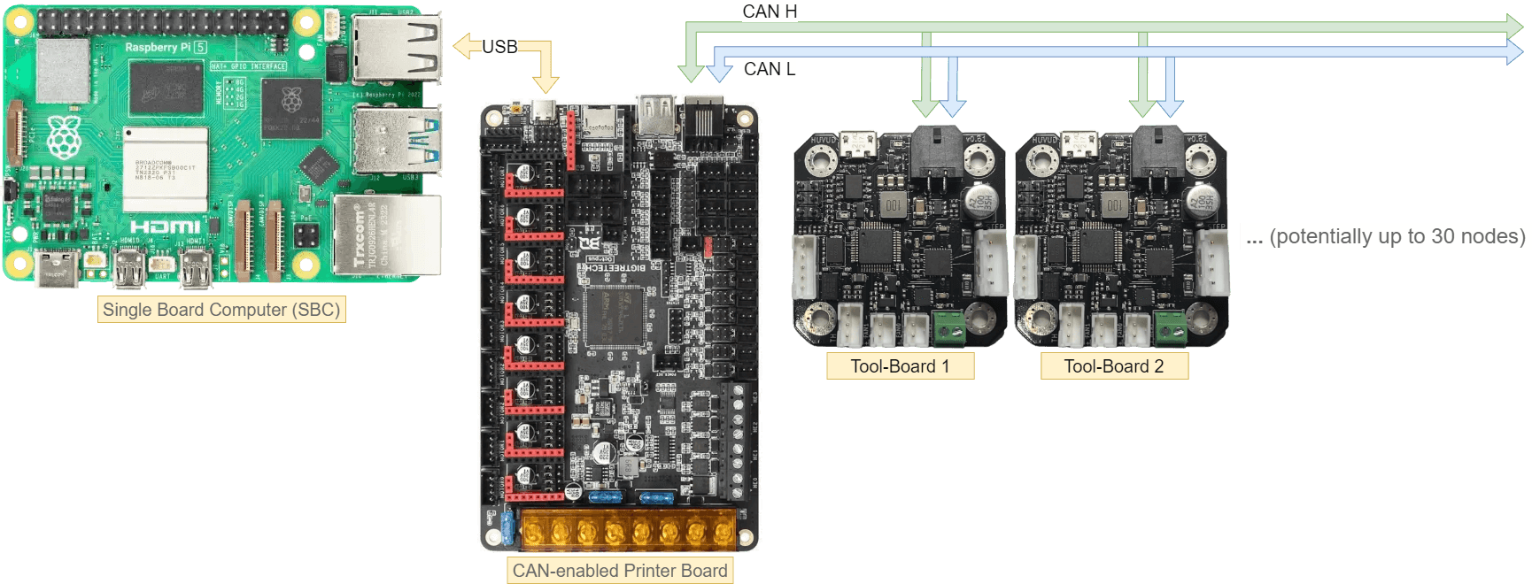

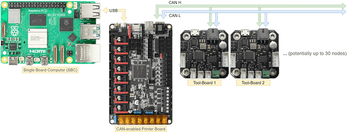

2.2 USB to CAN Bridge
Description:
  • A CAN-enabled “master printer board” with a dedicated CAN connector is connected via USB to the SBC.
  • This “master printer board” supplies the most printer peripherals and also serves as the starting point of a CAN bus.
    • From its CAN connector, two wires (CAN H and CAN L) will start the CAN bus.
    • This board needs to be terminated with 120 Ω by setting respective jumpers on it.
  • One or multiple further CAN boards, e.g., tool-boards, are connected to this “master printer board.”
    • The last board at the end of the CAN bus must be terminated with 120 Ω by setting respective jumpers on it.
