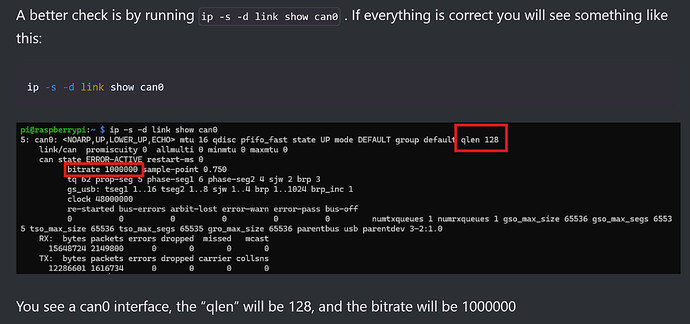

Did you do this step to verify baud rate?
yes i have that,
-BX:~ $ ip -s -d link show can0
4: can0: <NOARP,UP,LOWER_UP,ECHO> mtu 16 qdisc pfifo_fast state UP mode DEFAULT group default qlen 128

And you went through https://canbus.esoterical.online/troubleshooting/no_uuid.html?
Your CAN data wires go from the hat to the hermit crab? I don’t think with your configuration the mainboard is on the CAN network.
  • Make sure the board is indeed flashed with the correct firmware and settings, especially CAN pins and speed. Flash in bootloader (BOOT button on the board) mode using make flash FLASH_DEVICE=2e8a:0003. After setting the board into bootloader mode, verify with lsusb befor flashing.
