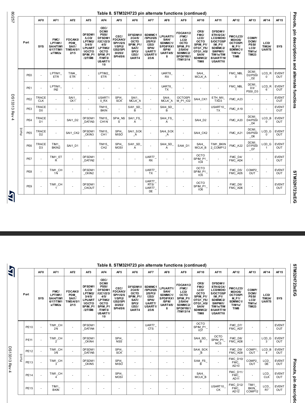

I am trying to use a FYSETC V2.1 RGB Mini 12864 Graphic LCD Screen, but it wouldn’t work without defining SPI in the configuration. I don’t know yet if it would work with SPI defined, because I cannot add the “spi_bus:” parameter. As far as I see from the klipper source, the name would indeed be “spi4”, and BUS_PINS_spi4=PE13,PE14,PE12 shows up in the log.
In stm32h7_spi.c:
#ifdef SPI4
DECL_ENUMERATION("spi_bus", "spi4", __COUNTER__);
DECL_CONSTANT_STR("BUS_PINS_spi4", "PE13,PE14,PE12");
#endif
What am I doing wrong?

I am realizing though, that I missed something else. SPI4 in an STM32H723 is a “dual” interface. There is another set of pins used as SPI4 (PE2,PE5,PE6).
And so, now I am getting a different error message.
pins.error: pin PE14 is reserved for spi4
Since I don’t see any “a” and “b” of SPI4 in the source code, and no trace of those pins, I guess I have to fall back to spi_software_ …
Yes, with spi_software it works. Here’s my final configuration.
