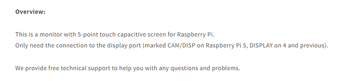

is it this Freenove 5 / 7 Inch Touchscreen Monitor for Raspberry Pi 5 4 B 3 B+ A+ one?
Is it meant to run with Klipper-Screen?

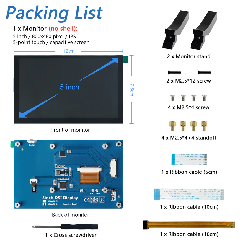

So just to also clarify, I had to find a 15 pin to 15 pin FFC ribbon connector to connect the screen so i went an ordered this one:
It was really the only 15 pin to 15 pin FFC ribbon connector I could find but now that I go back and look at it, these may not even be compatible as the title says ā€œModule Cameraā€. At the time I read the description and it said ā€˜external displays’.
This leads me to my next problem. Where do I source a FPC ribbon connector that work for LCD touch screens (DSI) that is 15 pin 1mm pitch on both ends as the regular 15 pin to 22 pin wont fit on the Manta M5P (the DSI connector on both the Freenove and Manta board are both the 16mm wide ones). I have look everywhere and seem to only find the 15 to 22 or the 15 to 15 that are only for cameras.

Didn’t the display have cables included in the package?
That’s a pretty reasonable way to approach things.
That needs clarification - as @cardoc asked, what were you given in the Freenove kit?
Also, I can’t see the page as Amazon here won’t access the Australian version and just goes to Canada where the link doesn’t work. Regardless, a straight 15 pin to 15 pin should not be an issue.
Not really. I guess I didn’t ask explicitly enough in my last post. What you need to provide:
  1. What were you given in the Freenove kit? When I looked at the product website it says that cables come with the display.
  2. What exactly happens when you connect the display to your M5P and turn on the power? You said that it flashes and the backlight comes on. Is there an LED to indicate that there is power on? I’m asking because the LCDs I’ve worked with have them.
  3. What exactly is the process you used to set up the CM5 (including loading the bt-blob.binfile) and where did you get this process and the files that you used?
The ribbon cable I linked from amazon is a Type B (reversed) FFC cable where the stiffners are on the opposite side, I read over some forums and people have mentioned they had it working with the Type A (straight through) FFC cables where the stiffners are on the same side. I found a spare Type A FFC cable from a camera module kit but I still didnt have any luck.
  1. The freenove kit simply came with 1 cable which is the reason why I bought the FFC from amazon, because the cable that came with the Freenove dosent fit into the manta since the 22 pin 0.5mm pitch end of this cable (thinner end) is too small for the Manta M5P dsi port which seems to have the 15 pin 1mm pitch connector (wider end) - See the image in this link since I cant share images, this is pretty much how the ribbon cable looks like - DSI Display Screen Adapter Cable for Raspberry Pi 5 - 300mm, 22-way to 15-way

If I get it right, you want to connect a BTT Manta M5P with a hooked on RPi CM5 to ā€œDSI1ā€ or ā€œCAM1ā€ connector on your Manta to your display? …and make it working.
Again, is this your display?
Why was this discussion started about FPC connectors and cables before we know what display we are talking about?
Hi, I am very sorry for not replying, I had alot to do recently and havent had time to go through all the replies. I really appreciate offering to help as well it means a ton!
Yes that is the screen I bought.
