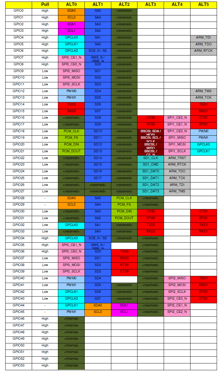

Let’s take a closer look at the BCM2835 pin function documentation to understand why.
As seen in the table above, the chip provides multiple UART-capable pins (TXD0-1 and RXD0-1). However, on the Pi Zero 2 W header, only GPIO14–15 are routed. This means that whichever UART we use, the only useful external pins are GPIO14 and GPIO15. Now that this is clear, let’s explore how we can work around it.

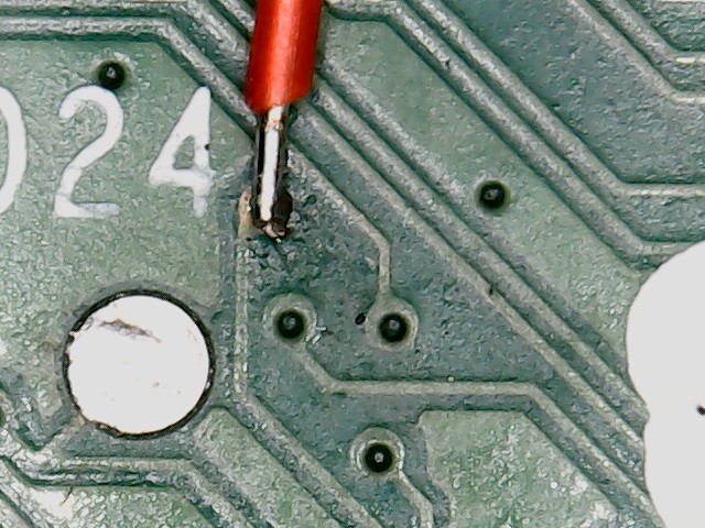

Following the PCB Traces
Thanks to Jonathan Clark’s reverse-engineered PCB layer images, we can trace the BGA balls and see exactly where each UART pin is connected.
I first selected one pair of pins that already has UART functionality — the ones used by the onboard Bluetooth chip (not routed to the header). By tracing these pads from the top layer down through the vias, I found that they do not connect to inner layers before reaching the Bluetooth module. Instead, they pass through a via straight down to layer 6 (bottom), then back up to the top layer under the Bluetooth IC.
This is very fortunate, because it means we can “harvest” these UART pins with a bit of soldering, a few wires, and some careful work. Below you can see images of the BGA ball map and the UART trace locations on layer 1 and layer 6.
I have highlighted the UART pins with green and red boxes in both the BGA map and the layer images.

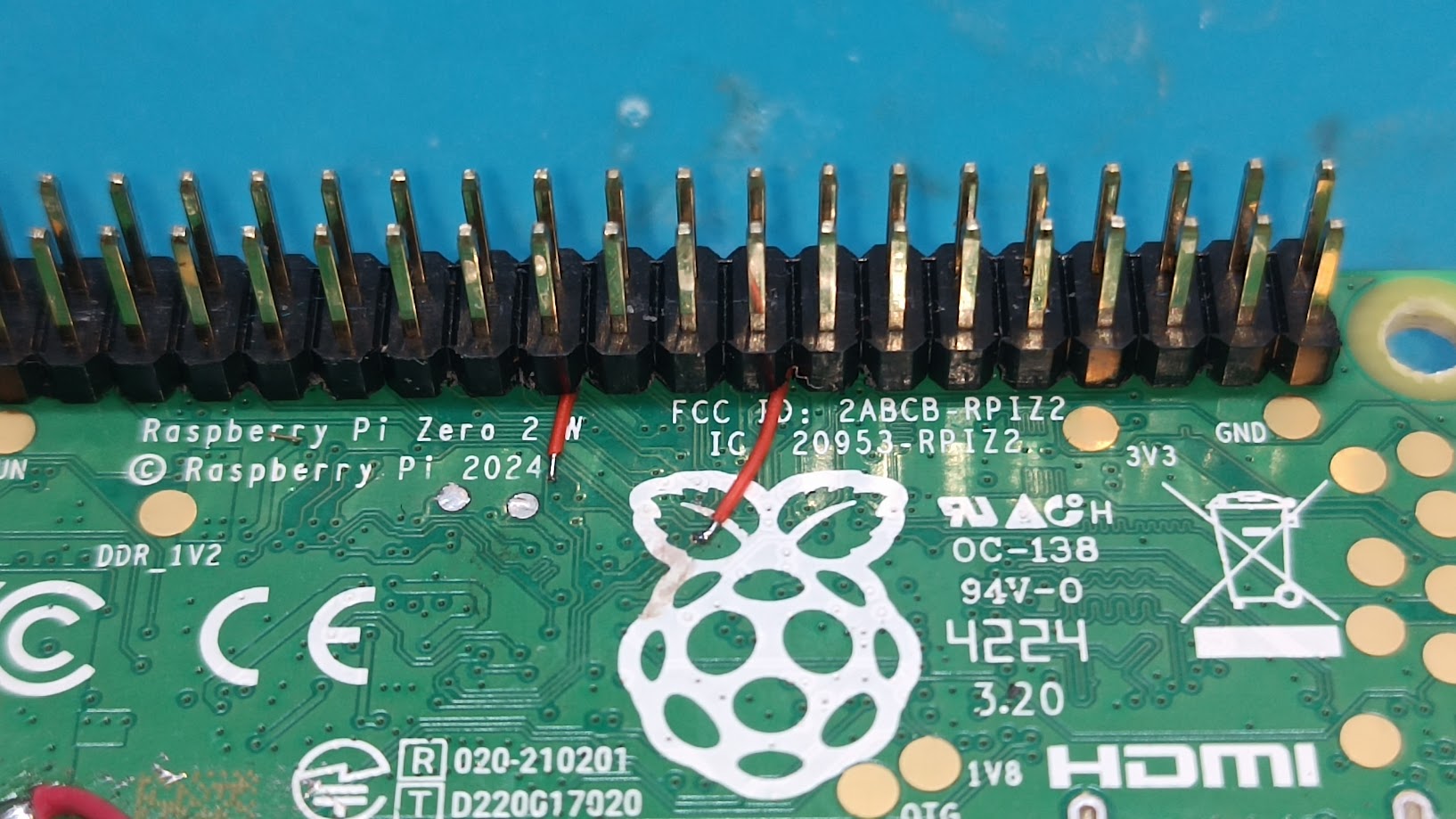

Re-routing the UART
I chose to re-route these harvested UART signals to GPIO23–24 pins on the header. I picked these because they have fewer alternative functions and are less likely to be required in my projects. Below you can see the soldered wires from the vias to the GPIO23–24 header pins.

What about the original GPIO23–24 signals?
If we never configure GPIO23–24 as OUTPUT, they will remain in High-Z state and electrically harmless. However, as an extra precaution, you can cut the original traces to GPIO23–24. Conveniently, these traces are also located on layer 6, making them easy to isolate if needed.
