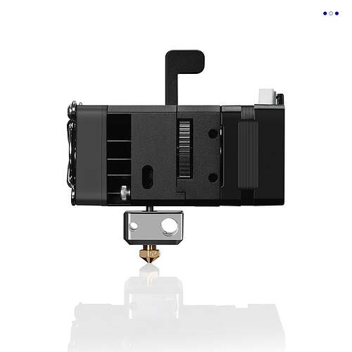

E Steps and ratio?
Hello!
found for my new BIUQ Extruder H2 this description
932 steps/mm at 16 segments (further correction required)
how can I setup the config of the spider v2.2 ?
[extruder]
step_pin: PD5
dir_pin: PD6 # Tronxy !PD6 BQ PD6
enable_pin: !PD4
microsteps: 32 -->> 16?
rotation_distance: 23.89816 #22.478 # Titan Extruder Clone Rotation Distance BQ ?
THX! for help
https://www.klipper3d.org/Rotation_Distance.html#rotation-distance
Read the entire article. In brief:
  • Convert the esteps to rotation_distance as detailed in the link above, using 16 microsteps
  • rotation_distance in Klipper is then independent from microsteps, so you can just keep 32 as per your current config
Gear ratio is 7:1
[extruder]
gear_ratio: 7:1 # Titan Extruder Clone Gear Ratio 66:22    BQ 7:1
is that fine?
by measuring driving the filament 100mm, the ratio is 10.7
Iam fine with these settings, or do I have to check more?
[extruder]
step_pin: PD5
enable_pin: !PD4
microsteps: 32
rotation_distance: 10.7 #23.89816 #22.478 # Titan Extruder Clone Rotation Distance    BQ 10.7
nozzle_diameter: 0.400
filament_diameter: 1.750
min_extrude_temp: 10
heater_pin: PB15
sensor_type: Generic 3950  # Tronxy ATC Semitec 104GT-2    BQ NTC3950 100k  Generic 3950
sensor_pin: PC0
control: pid
pid_Kp: 18.831  # Tronxy 18.831
pid_Ki: 0.821  # Tronxy 0,821
pid_Kd: 108.044  # Tronxy 108.044
min_temp: 0
max_temp: 270
max_extrude_only_distance: 350
about the calculation of the rotation_distance
rotation_distance = <full_steps_per_rotation> * / <steps_per_mm>
rotation_distance = 932 * 16 / ? → how do I get this value?
found in the description:
circumference of extrusion wheel: 24,5mm
24,5*3,1415/7=10,99525
  • Kick out gear_ratio
  • Use rotation_distance = <full_steps_per_rotation> * <microsteps> / <steps_per_mm> = 200*16/932 = 3.433 as rotation_distance
  • Fine tune rotation_distance as per Rotation distance - Klipper documentation
Am I missing something maybe.
The rotation distance is more or less correct for my setup but the motor is turning way too fast. At a feed rate of 14 mm/s, the stepper is losing steps.
This was working for my stock ender 3 extruder but I tried to print a part which worked with stock extruder but now the H2 stepper just kept skipping steps.
