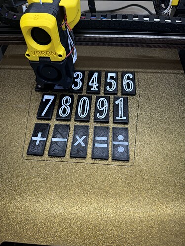

Very happy to report that everything seems ok now.
Cannot thank you enough for taking your time to help out beginners in klipper like me.
:hugs:
