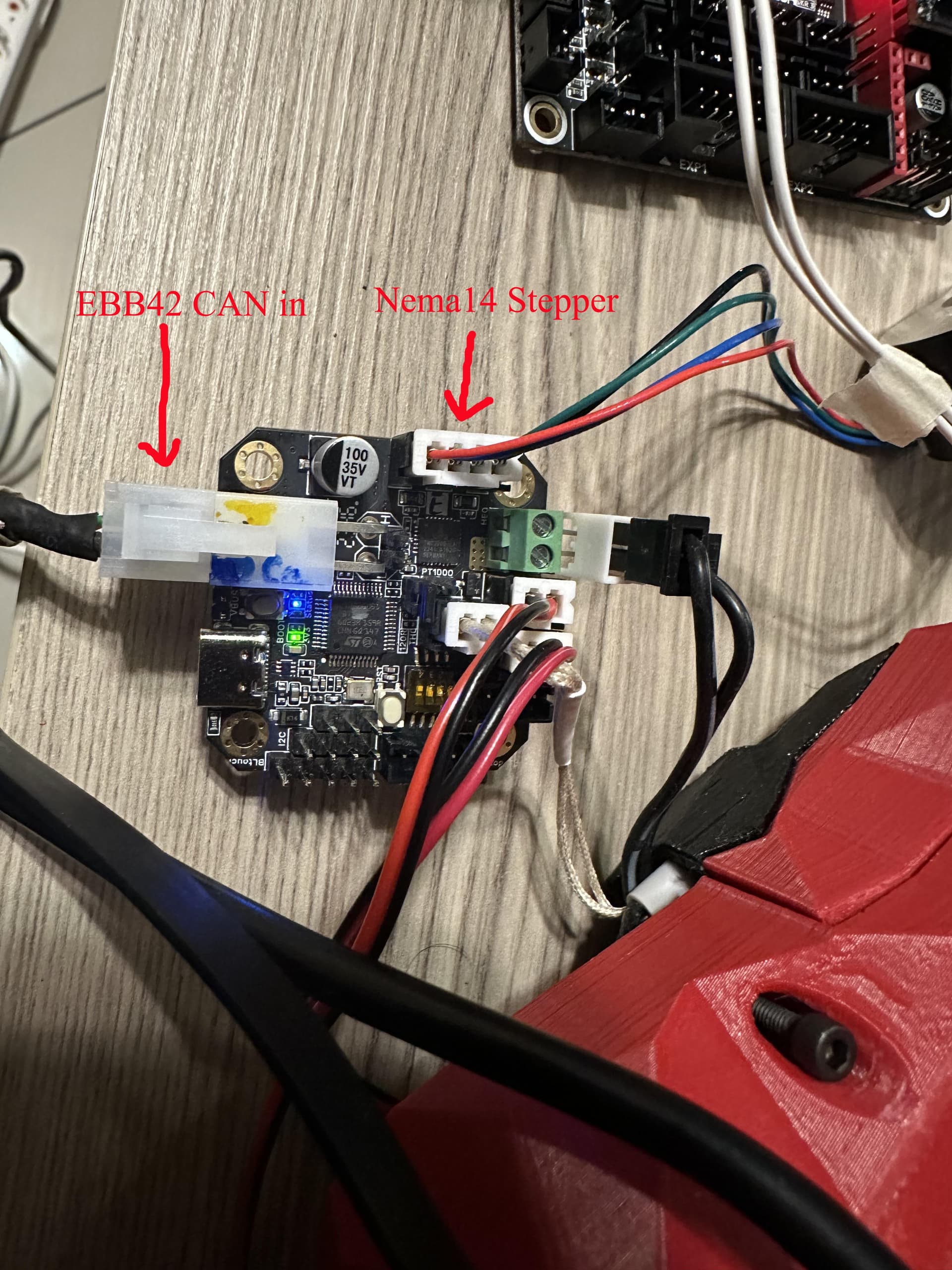

EBB42 CAN and Nema14 stepper heating problem
I’ll ask again; have you tried making the stepper motor turn (both through the EBB42 and the SKR)?
I’d also like actual pictures of your motor, your EBB42 and the wiring - not catalog images.
Hi Myke,
These are real pictures.
Looks good - thank you.
Now, can you get the extruder stepper to turn? You will need to heat the nozzle to at least 170C, but that looks like it’s possible with your setup with the Stealthburner wired in.
Do you go with separate 24 V and GND to the EBB42 from your PSU or how is it powered?
How thick are those wires?

There is no problem in the rotation of the extruder motor. is turning. I can turn it when I increase the temperature above 170 C.
The only problem is that the temperature increase continues even though the stepper motor is stopped.
The cable may seem thin, but there is no heat etc. in the cable.

EBB42 has powered from SKR3 CAN-FD port.
There is no heating in the cable.
The stepper and hotend working properly.
I think to change this cable to 22AWG.
You asked before. I am sorry Myke. I forgot to write.
When the stepper motor stops, it cannot be rotated by hand.
But sometimes when the stepper motor stops, there is a strange micro vibration. When this vibration is present, the temperature rises faster. It is as if a current that is too low to turn the motor continues to flow.
After adding sense_resistor: 0.100 to the [tmc2209 extruder] section, these vibrations decreased. (I’m just doing trial and error now)
That vibration that went away with setting the sense resistor is normal, That’s the chopper in the driver working to keep the driver still. It was probably have compensation issues cause you had resistors in the path but they werent defined (that’s an assumption though I’d have to look at the internal circuit of the driver).

This isn’t normal as it seems like the TMC2209 is being commanded to be on and hold the position (what @TheFuzzyGiggler indicated).
BUT this shouldn’t be happening if things are just sitting there and you’re not printing (or even started a print).
Could you show the make menuconfig parameters that you are using for the SKR and the EBB42 along with your current printer.cfg and klippy.log?
There’s still something that isn’t right. You could try swapping out the EBB42 but I suspect you’ll have the same problem. Let’s see if we can figure out what’s going on with the software and configuration.

Since the sense resistors weren’t defined the driver was most likely trying to use it’s internal sense resistors and was expecting a direct connection to ground on the BR pins.
But there were resistors on those pins so I imagine it looked like a “high” (relatively speaking) trace resistance. Could have easily caused the asymmetries it warns about.

Try powering the EBB42 from the power supply and not through the board.
This would eliminate the chance that the board has a power trace issue with that connector, BTT in the past has made errors in design of PCBs, for example GTR not connecting the diag jumpers to the motor diag pins this made the daig jumpers useless.
