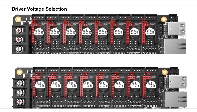

Can you share how you set the jumpers on the Manta M8P (ideally with pictures) for the X Axis driver with the TMC2209?
See attached picture on the A Axis driver, I have removed the TMC2209 to beetle see the jumper. I have on jumper in position 2 upper and one for the sensorless homing.
I forgot to say it is a M8P V2 and I have the same issu for all axis and the extruder.
Not sure from the picture, but is the jumper for motor voltage selection missing?
Good eye - you’re right.
Thank for your answer.
I did not put the jumper for voltage selection.
I have understand that, if I power only the the power connectors I need to put a jumper on vbb (right side). Then I could remove the connection between power and motor power connectors.
You have to have a jumper placed for each motor driver no matter what.
From the user manual, you can select to use the motor power or the board 24V power using a jumper on the left two or right two pins for each motor driver:
For your situation, I would recommend just adding a jumper in each position and leave the wiring as is.
Thank for your support. All is working now.
