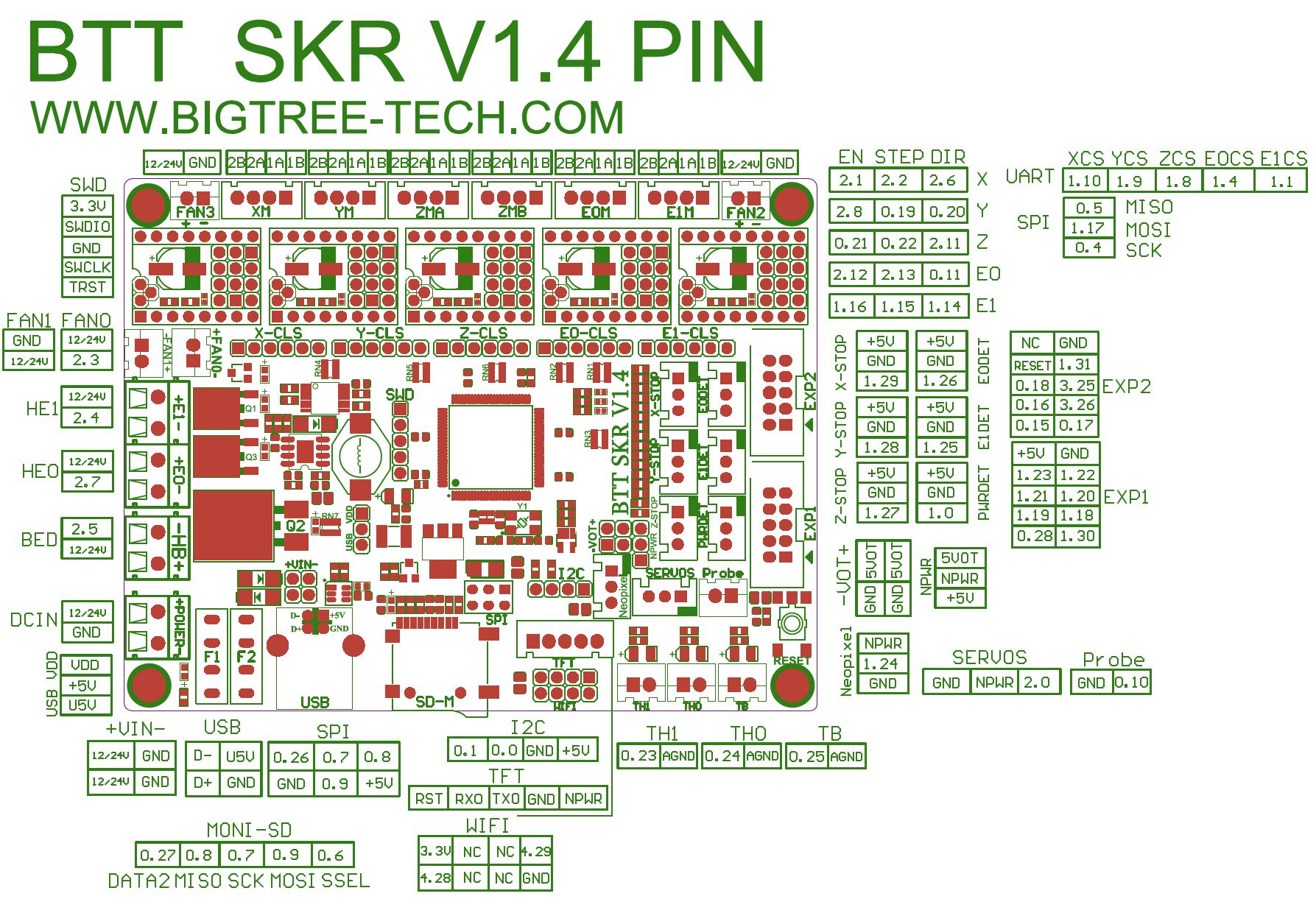

Z1 is on E0 (E0-CLS/E0DET), extruder is on E1 (E1-CLS/E1DET)on the SKR 1.4 Turbo
Here’s the SKR 1.4 Turbo pins
Working through my first Klipper install
When I try to extrude filament, it moves the Z1 motor instead, what have I done wrong please?

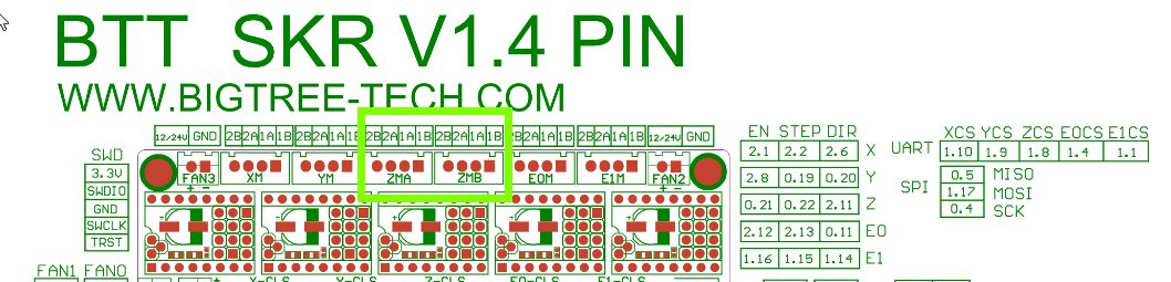

Make sure not to have accidentally connected the two Z-ports.
Thanks but the 2nd one ZMB is empty
Haven’t changed the wiring since I was running Marlin, but I did double check everything before installing Klipper
Thinking about it, there’s always the possibility I have Z1 in E2 and the extruder in E1, I need to double check, ,will report back
Doh, thanks for the post, it made me double check.
I had the Z1 in E1 and Extruder in E0, once switched all is fine
