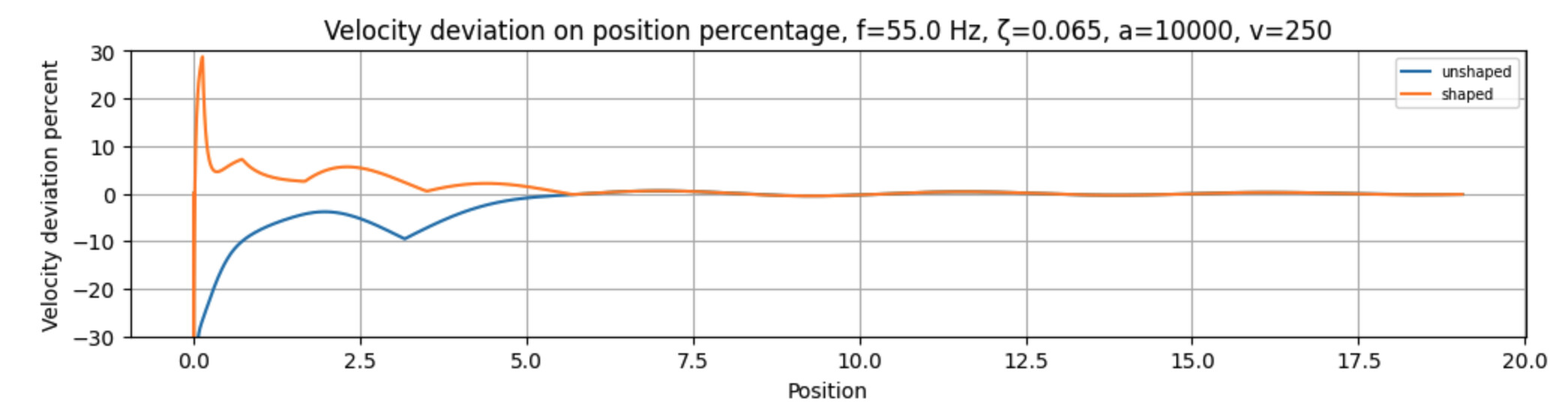

Preface: the post got actually too large. So, I’d recommend reading the principles of extruder input shaping and then skip the justification part and take a look at the experiment results because there are some interesting findings there, in case you want to save some time.
From the implementation point of view, the exruder input shaping is done as follows:
  • extruder motion is split into 3 ā€˜fake’ axis E_x, E_y, E_z in certain proportion for each move;
  • the configured input shapers are applied to E_x and E_y motion;
  • the pressure advance calculation (with smoothing) is applied on top of that (in fact, integrals and sums can be swapped in this case, so it is actually implemented in reverse: IS_x(PA(E_x)), IS_y(PA(E_y)), E_z (no PA or IS for z, retractions/deretractions are also implemented as a motion over this ā€˜fake’ z axis);
  • the final extruder position E is a sum of per-axis motion, i.e. E = IS_x(PA(E_x)) + IS_y(PA(E_y)) + E_z.
If you are curious, here’s some justification on why this might even make sense at all, and how the moves are split into E_x, E_y, E_z.

Left to right are current Klipper PA code (with PA=0.04 and smooth_time=0.02), original extruder input shaping code (with PA=0.04 and smooth_time=0.01) and the fixed code (the same PA=0.04 and smooth_time=0.01). Input shaping in all cases is 3hump_ei at 70 Hz for X axis and 2hump_ei at 52.6 Hz on Y axis. The extruder shaping differs from mainline substantially, but the fix itself is pretty cosmetic.
Another example of PA behavior from the same test run (just a different GCode location):
This one is pretty interesting actually. Again, the extruder shaping differs from mainline substantially, but the fix itself is pretty cosmetic, though this time there are a bit more noticeable differences.
Specifically, there’s this jitter with both extruder input shaping versions at the range of supposedly constant extruder velocity. So, I tried to trace it down to see if it’s some kind of fluke. In GCode, this corresponds to the part of 3D Benchy perimeter that faces outwards including the Benchy nose (basically that velocity dip in the middle of velocity chart is the Benchy’s nose):
So, while cruising velocity stays constant, the motion on X and Y axes isn’t - the toolheat prints a smooth curve and turns all the time. I wanted to check the actual toolhead velocity from the steppers, so I wrote and additional motan data analyzer that can be used as ["norm2(derivative(stepq(stepper_x)),derivative(stepq(stepper_y)))"] to compute (v_x^2+v_y^2)^(1/2). Here’s the result for that part:
test_3db_extr_is_stepcompr_2_tv2
So, while the velocity of stepper_x and stepper_y is smooth and all, the resulting instantaneous toolhead velocity (after input shaping) is not constant, there are some velocity oscillations. And for better or worse, the extruder input shaping code can now pick up those oscillations and adjust the PA for the extruder accordingly. Also, comparing the two versions, extruder input shaping after the fix seems to better match the amplitude of the velocity oscillations to the PA adjustments: it is stronger where the actual amplitude of velocity oscillations is larger. Prior to fix, the amplitude of PA oscillations was more consistent across the whole curve, even though the actual toolhead velocity oscillations are much smaller on the sides of the Benchy far away from its nose. Whether the whole thing actually makes sense is another question, though in many of my performed prints I didn’t observe any degradation of the surface finish on smooth curves.

When running some simulations, I observed something interesting.
I have a hypothesis that this is more beneficial to longer duration input shaper but may actually be detrimental to shorter duration shapers. The extruder movement is calculated based on ideal toolhead states (position and velocity that klipper commands before input shaper and gantry dynamics), so the closer our estimate to the actual toolhead position, including gantry dynamics, the better.
With long duration input shaper such as EI, 2HEI, 3HEI, the actual toolhead states are closer to the shaped commands. But for well tuned shorter duration shapers at high acceleration, the actual toolhead states after input shaper and gantry dynamics can be closer to ideal toolhead states than the toolhead states with input shapers without gantry dynamics.
I ran a some simulations to compare the effects in different configuration and the results appear so support it. I have not run physical test since I’m still working out the math for another effect that I suspect to be significant. Inspecting the graphs visually, it looks like the effect is about equal around MZV, at least for the configurations that I tested. Acceleration, target velocity and the system parameters appear to have effects as well.
Note that my simulation assumes second order underdamped dynamics, which is a good estimate for my printer since the resonance measurement shows one sharp peak. I have also measured and verified the damping factor which I will use here.
The simulations are one axis, constant acceleration from dead stop to a target velocity.
Fig 1: Acceleration response for ZV shaper for reference
Fig 2: ZV shaper, note the shaped response is closer to ideal (unshaped)
Fig 3: ZV shaper, actual velocity - planned velocity vs position, as percentage of planned velocity. I reason that this deviation is what causes over/under-extrusion which may be somewhat compensated by PA.
Fig 4: Same as Fig 3 but for MZV.
Fig 5: Same as Fig 3 but for EI. Only half acceleration to prevent smoothing
Fig 6: Same as Fig 5 but at 10k acceleration. We can see slight ringing.
What Fig 3 to Fig 6 have in common, is that we are switching from slightly overextruding to slightly underextruding. Actual toolhead velocity lags unshaped modeI and leads shaped model for a given position. Lagging toolhead velocity for the same extrusion rate means overextrusion, in some cases up to at least 5% over 1mm distance. I suspect this may be one reason why the PA value needed to be re-tuned.
From these graphs, if we assume that PA perfectly compensates for extruder dynamics, there is still a quite significant under/over-extrusion that is mostly due to the toolhead dynamics. This deviation is dependant on the toolhead’s resonance frequency, damping factor, input shaper used, acceleration and target velocity. When printing at high acceleration and speed, a common recommendation is to use constant acceleration and velocity for all features and tune PA to that condition, a practice that works well in my experience. However, it makes me think that we are perhaps using PA to compensate for toolhead dynamics on top of extruder dynamics.
Let me know if there’s any issue with this line of thought.
Thanks for reading
