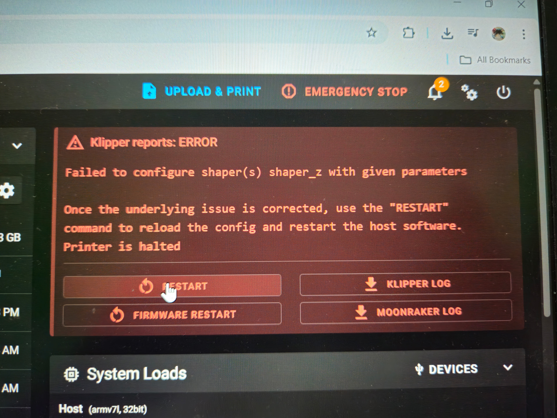

Failed to configure shaper(s) shaper_z with given parameters
Printer Model: voron trident
MCU / Printerboard: octopus pro h723 v1.1
Host / SBC rpi 3b+
klippy (3).log (256.5 KB)
did a shaper_calibrate command in console. everything worked well but when did save_config error shows as ‘‘failed to configure shaper(s) shaper_z with given parameters’’. i also tried to manually put [input_shaper]
shaper_type_x: zv
shaper_frequency_x: 61.4
shaper_type_y: mzv
shaper_freq_y: 47.2
still same error shows.
removing the input shaper config removes the error.

did that too but same problem persist. i think the issue is different. something related to shaper’s z axis though i only did shaper callibrate for x nd y axis. input shaper used to work before on my printer but when i reinstalled my printer firmware to latest version, it threw out this error.

ebb36 and its parameters not solving the issue…..the error throws the moment i add [input_shaper] to printer.cfg
Sorry, the “error throws”? Is this a new error that happens when you “SAVE & RESTART” or try the input shaper?
Please describe exactly what happens (and post screen shots if possible).
when i do SAVE & RESTART

i even tried adding
[input_shaper]
shaper_freq_x = xx
shaper_type_x = mzv
shaper_freq_y = xx
shaper_type_y = zv
shaper_freq_z = 0/50 (checked with both values)
shaper_type_z = zv/mzv/2hump_ei/3hump_ei
still same error showing
At first glance it does not look like your config has any problems. Perhaps when you pulled a Klipper update something got borked. You can try running on your Pi
rm ~/klipper/klippy/chelper/*.so
and restart the printer. This will rebuild the C part of Klipper, and perhaps this get the issue fixed. And at least resonance_tester has nothing to do with it.
