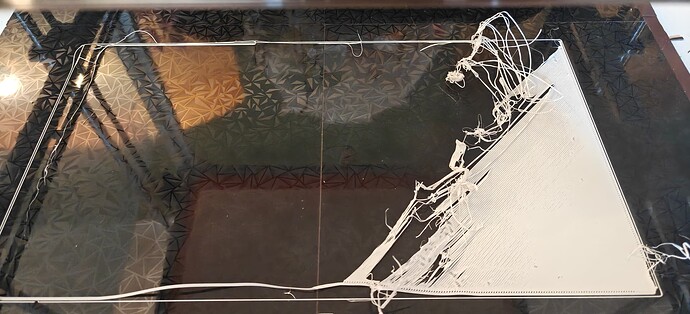

I’m having issues getting the printer to print the first layer properly. I’m currently using the BTT Eddy cartographer probe, but the same issue happened with the original probe (inductive), which leads me to believe it’s not a probe issue, but rather something else.
The print starts usually off good, but half way through, it seems to fail every time. I have tried to adjust the parameters in [bed_mesh], but nothing seems to work. Added mesh_pps, added move_check_distance, changed bicubic_tension, but the result is always the same.

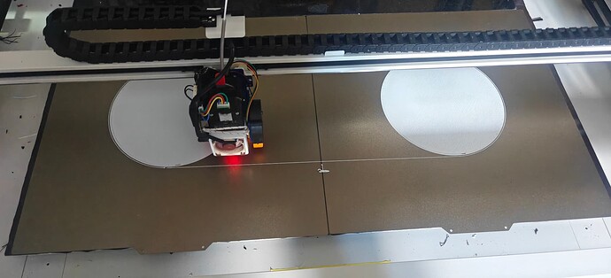

I was wondering if this could an issue caused by the very large print area, which consists of 4 beds and is 800x800mm in total. Might be that move_check_distance isn’t working as intended on such large print areas.
Due to the large and separate beds, it’s quite hard to level them in such a way, that they’re within 0.1 - 0.2 mm, and thus the bed mesh looks quite bad. But nevertheless it should compensate somewhat for it.

The mesh klipper generates interpolates between the measured points. It can’t handle a “step change” between the left and right plates.
You really need to adjust the beds to get close enough that Klipper has a chance.
Also check your flow rate. Picture looks under extruded even where it stuck.
You’re absolutely right, and I took that into consideration when first encountering the issue.
The fault doesn’t start on or neare the edge of a bed. It’s within two measuring points of the same bed, which leads me to believe it’s not caused by the hight difference of beds.
The underextrusion you can see is most likely caused by the nozzle height being off slightly. I have installed eddy-ng, but haven’t had the opportunity to dial it in.

I also noticed, that the print seems to get worse, the longer it goes. This could mean that either the motor is skipping steps when making those micro adjustments, or (even though it’s pretty unlikely) Klipper is not able to keep up properly on such large moves.
I prepared a different test to avoid crossing the bed boundaries and have a proper Z-move in-between.
The tests printed successfully, even though not perfectly. I might need to micro-step the nozzle down 0.05 mm.
I also tightened the belt which connects the two ball-screws for Z for either side of the gantry. There was some tension on them, but considering they have such a heavy load, I figured the slightest amount of play could have an effect.

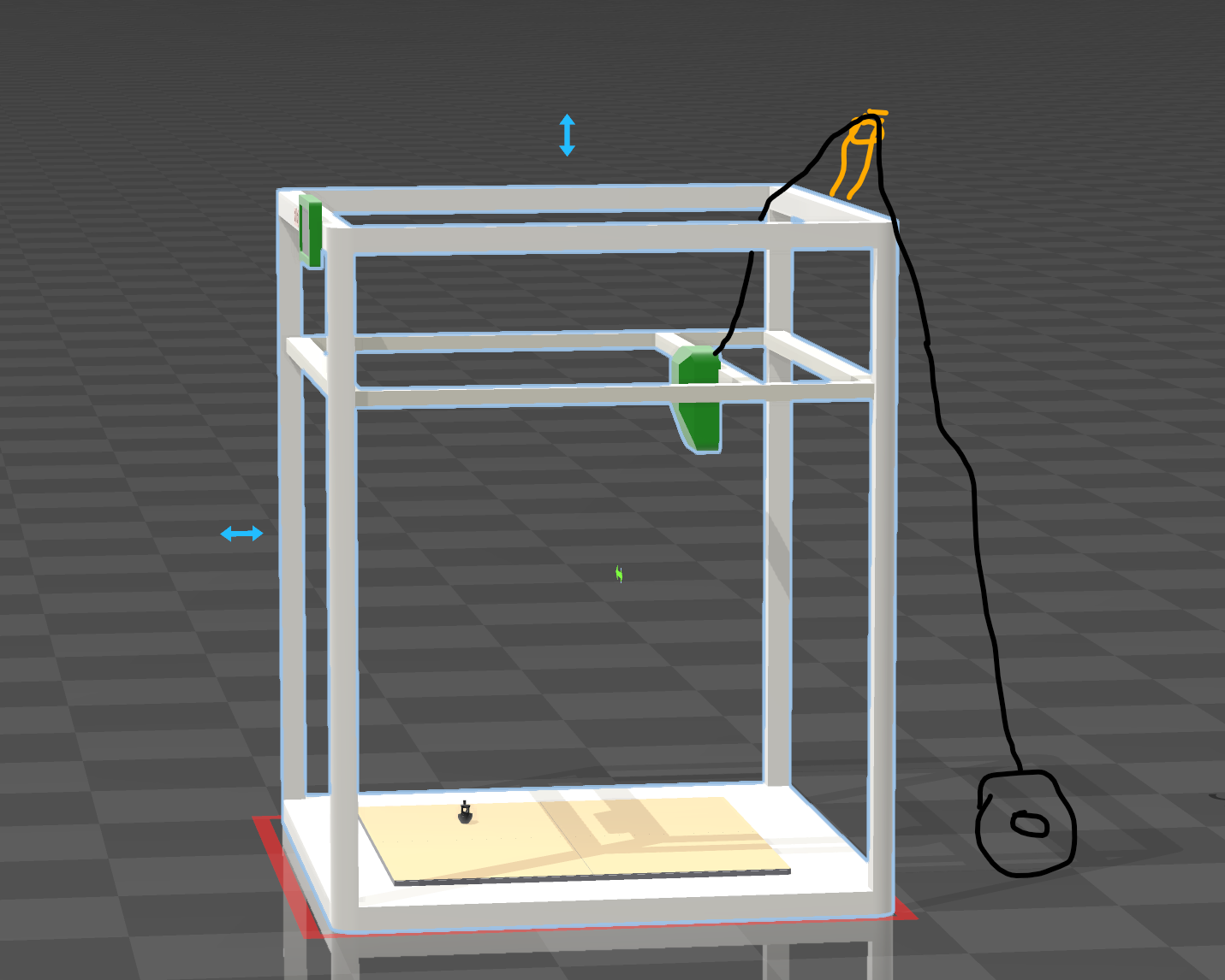

Due to the printer being so huge, the filament is fed to the head “flyingly”, meaning the spool sits behind the printer, the filament is routed through a wheel mounted at the back top of the printer and then goes down to the head. Here is a masterful schematic about it:
What I have done (and probably a lot others have or will too), is putting a “hat” and side panels on the machine, to avoid drafts on demanding materials.
The top panel or “hat” makes it so, that the filament doesn’t have a clear path anymore to the head and needs to be routed through the top panel, usually through a hole.
Now, this solution creates quite a lot of friction on the filament route and the filament is under tension when the extruder pulls on it.
This can lead to torque either clockwise or counterclockwise on the head and together with the play from the linear bearing, can lead to a movement of the nozzle of about 0.5 mm.
The probe is mounted further out (in front of the nozzle) which makes the effect even worse.
This all to say: if the filament is under tension while scanning or printing, the nozzle and probe might be lifted from the bed.
I’m currently working on a proper fix for the issue, but for now, the only thing that helped was either routing the filament differently, or having a PTFE tube going from the extruder through the hole in the top cover.
