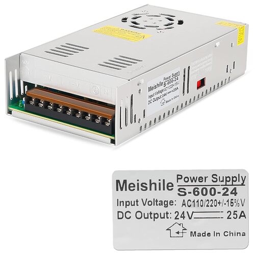

yes the psu is totally new, same voltage just 600w instead of the classic 500w from creality. the issues were present also with the old creality psu.
It’s already a pair of weeks i’m troubleshooting it with new parts and new ideas on config.
new psu:

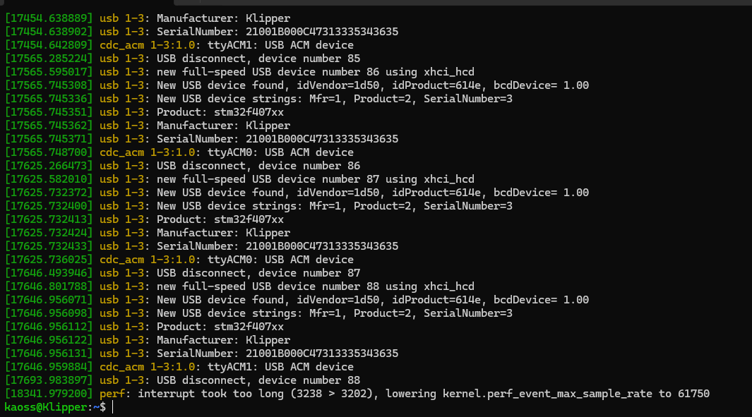

You may consult your Linux system logs and dmesg to see if there is anything shown on this level.
Blockquote You may consult your Linux system logs and dmesg to see if there is anything shown on this level.
Just issued a sudo dmesg and this is what i see:
log:
syslog.txt (144.0 KB)
