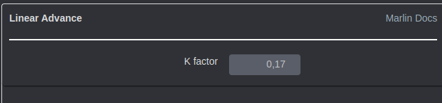

Also, these are my linear advance settings, they can improve the quality a little bit as well.

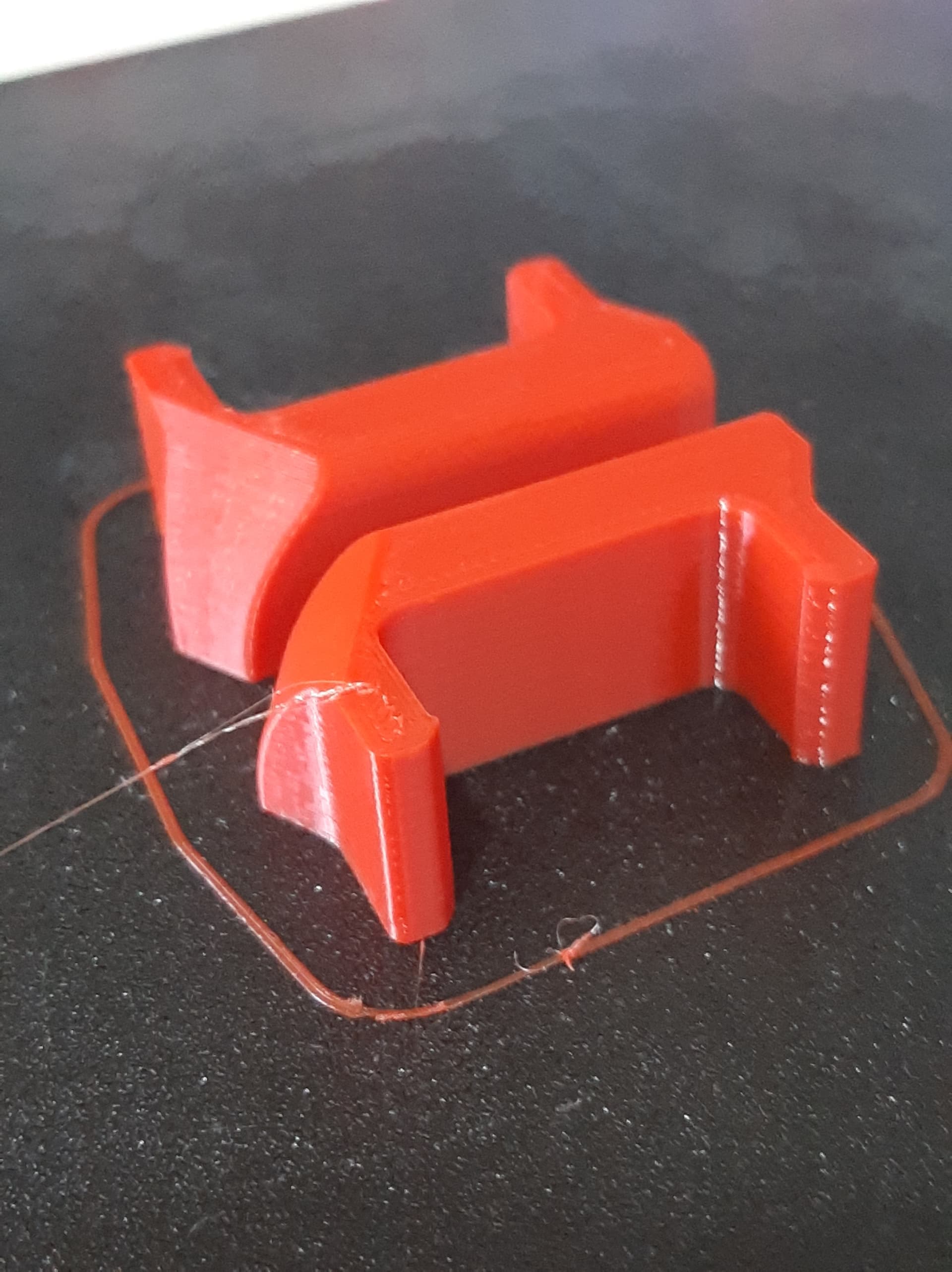

And this is a little print that i’ve done very recently. This is PETG at 222/80 and printed on 80mm/s for the outer perimeters and 120mm/s for the rest.

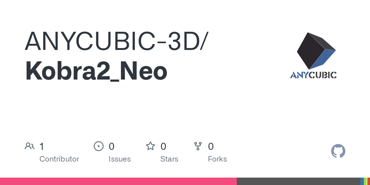

I saw that Anycubic has Just added the repo of kobra 2 neo on GitHub
POGGERS MANN :partying_face:
I CAN FINALLY MODIFY THE FIRMWARE AND EVEN RUN KLIPPER
ANYCUBIC THANK YOU :partying_face: :partying_face:
i’ll start working on klipper configs right now
