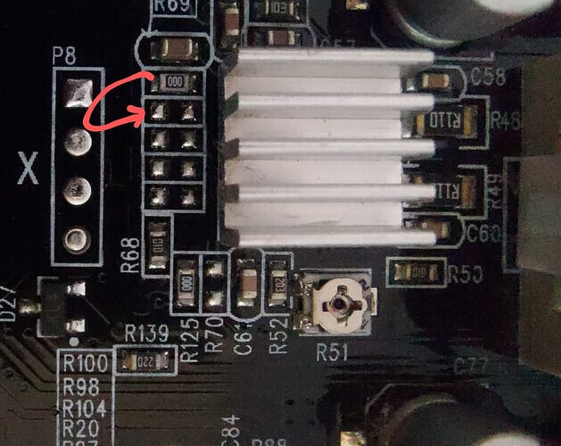

i have a question if i change the file values ​​in x and z would it work for kobra plus or would i have to change some other parameters
Did you have to re solder anything? If so what did you have to do?
Yes, you have to move R65 to R66 (jumper).
Hello #Crenwick35 , could you possibly answer two or three questions for me? background: I have a Kopra plus and the Sonic Pad. (but not working yet) to the questions: A.) how do I get it always flashed immediately, it doesn’t transfer anything to me. B ) I can take over your cfg file with the corresponding print bed dimensions. C.) do you have to use the same jumper for the Kobra plus as for the Max? Many thanks for the answer in advance +Digedi+
Hello,
Well from what I see (didn’t have a plus).
A : To flash the klipper FW you need first to change R65 > R66 , then flash the firmware.bin (should beep 4 times quick after flashing and stock display stops on splash screen, no control anymore) I removed the stock display because it’s disabled in Klipper.
B: I think you can take over my config file (just adapt the bed size and middle distance in probe section). And of course Z adjust / Bedmesh and PID tuning.
C:Yes

wow thanks for the quick answer👌 I found it out now… now both Pad+Kobra are communicating, but that will now be the problem of the jumper (which I haven’t resoldered yet because I wanted to try it first) because the Sonic Pad controls it However, Cobra displays an error when it ramps up the Z axis.
hey #mykeprredko maybe you have an idea how to do it without resoldering… simply that he can swap the axes in the software…:wink:
I’m glad that they’re communicating.
I’m not familiar with the boards and I’d always recommend to power down and disconnecting before attempting to do any soldering.
@Crenwick35 do you have any comments for @Digedi ?
hey, a.). The soldering is not a problem for me but I would like to avoid it.
b.) @both->> that he now gets out with an error when it’s moving the Z-axis is that because of the jumper? or at the cfg file.
Soldering here is mandatory, it’s due to UART communication.
No other solution known
