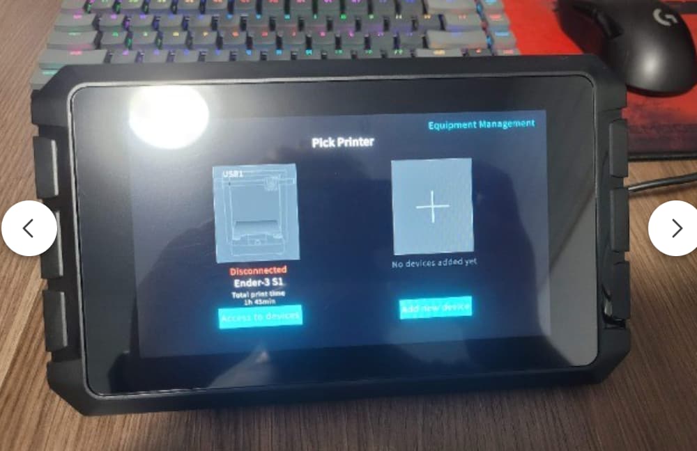

got the jumper resoldered …had flashed a klipper firmware to my kobra plus…had importet @Digedi s config into my sonic pad but that thing refuses to communicate with my printer …i ran out of ideas…can anyone help?
thx in advance
hello, I assume you have to select the USB port that the printer is on… (that was the error for me)
I don’t have another photo right now, but you can change that about here…
