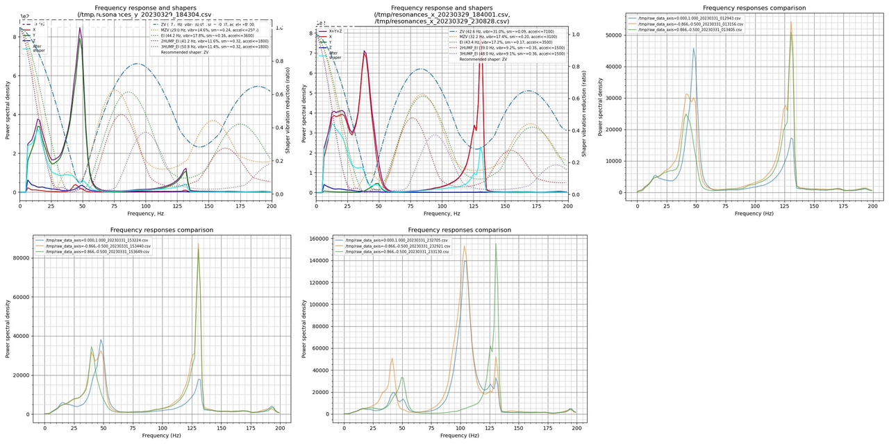

I wanted to add a update from all the mess in my first post.
Ive gotten the graphs alot cleaner now, but still many issues.
Maybe somebody can shed some light on these graphs?
X has 2 peaks?
and Y has a hill and peak? hehe
The blue is the back pillar (90 degree)
Orange is left pillar (210 degree)
Green is Right pillar (330 degree)
My guess is the orange en green should be the same, but green(right) looks dampening?
What have i done? tightened all screws, relubed the linear rails and balls from the effector and rods. swapped the arms around.
Where should i look next?
Thanks in advanced! :slight_smile:
Hard to judge for a delta since I have no experience with it.
On a Cartesian or CoreXY graphs like this would strongly point to a binding axis.
You are right, I took the linear rails out, and 1 (the green line) is binding not a bit…it doesn’t want to move only with force.
Here is a video about it:
Just finished the 3e rail, its even more bad lol, 2 out of 3 bad rails, nice flsun.

I wanted to update my topic again, to see where i am now.
And what the thought are from the forum members.
Shaper:
Its looking much cleaner now (still with the stock linear rails)
I also found a error in the printed housing to add the LGX lite extruder, i’ve used a other design now.
Im getting very exiting again, it looks much cleaner, but i do wonder what is the low hz noise in the graphs?
Al screws are tight, and all the wires are zip-tied, and taped there is no slack.
:+1:
Looks a lot better now. Also see the “Power Spectral Density” (left y axis), which increased by a factor of 10. This is an indication that your axes are running freely now.
Yes, its much better, do you have a idea what the low HZ noise is? it there something i can do about it, or are the rails to blame for this?
No shaper type is able to get rid of it, and i can see little waves like the see on prints
Low frequency resonances are the most detrimental in terms of ringing.
Unfortunately from the graphs you can only tell that they are existing but not from where they come. I have no experience with deltas, so I cannot really tell what’s normal and what’s not.
Generally speaking, the most important thing is your mechanics. If there is any binding, hard going, out-of-angle etc then you will have issues (not only with the input shaper).
There is not much to the mechanics of a delta printer, I have had one in one form or another for about 8 years starting with a rostock, tho haven’t used the current one for a year or so voron is now pride of place.
The places I would look is belt tensions, diagonal rods then possibly tower resonance.
Diagonal rod pivots points might also be a point of interest.
