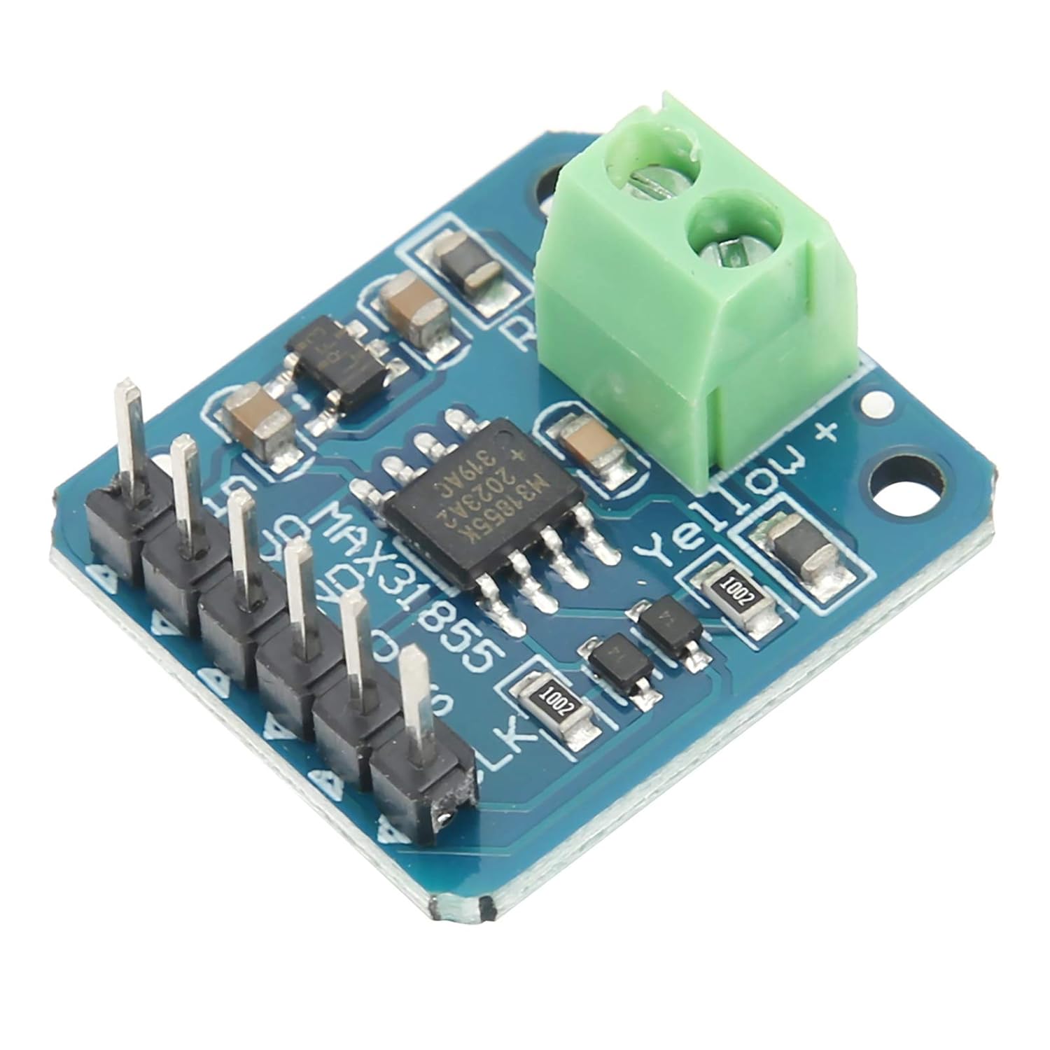

If you don’t want to mod the heater you’ll need something like this:
https://www.amazon.com/s?k=i2c+temperature+sensor&crid=1GU28DIRIOO0R&sprefix=i2c+thermocouple+amplifier%2Caps%2C233&ref=nb_sb_ss_saint-en-refocus-candidate_1_26

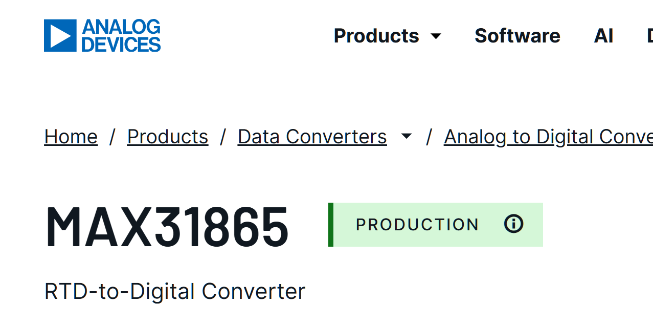

What MAX chip is available on board? I’m not familiar with the hardware you have listed. Some MAX chips are able to read thermocouples but unless it specifically has that capability (like a MAX31855) you will need additional hardware to handle it.
Something like this would probably be the easiest way for you to test that. I think the code could be done entirely in python, no mcu code needed. The chip handles all the hard parts of using thermocouples.
Did you have any luck with it? Looking at the EBB36 schematic, it looks like it should just work. The thermocouple code seems to initialize the right setting in the MAX31865.
