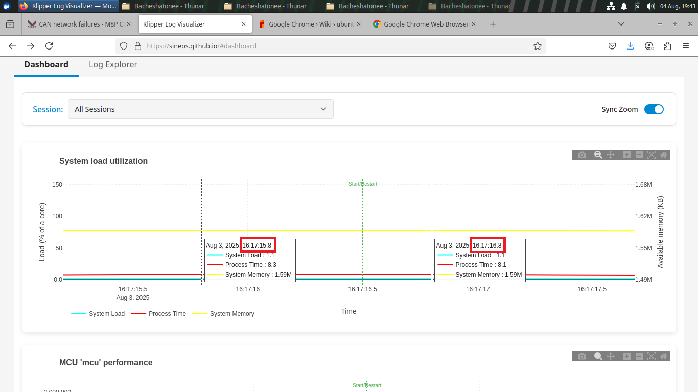

I started testing under Windows.
Firefox, Chrome, and Edge don’t work with/for your new Log Explorer feature. Looks like your program doesn’t react on my middle-click.
It took me a while to try above under Ubuntu since I had no machine with Linux installed handy.
Now I do. Works very well and stable with every browser mentioned above.
I would suggest another mouse-click. Maybe something like left-click + Alt or something. Nothing involving the middle mouse button.
Very cool feature. I’m curious what will happen with the new suggested features. Thank you.

I tried a larger klippy.log
Pretty harsh with my very old i3 with 4GB :joy:, takes forever.
Bacheshatonee stated this error:
MCU ‘mcu’ shutdown: Missed scheduling of next digital out event
I see this at line #51705
I wanted to find that line using your new Log Explorer feature.
Impossible with this log. These were the next points around line 51705.
Assembly!
When I mark the next left marker, I get line 50461 to 50661.
When I mark the next right marker, I get line 50465 to 50665 (did that one twice).When I mark the next right marker, I get line 50462 to 50662.
I don’t understand the result from the right marker.
When I switch from the zoomed “Log Explorer” tab back to the “Dashboard” tab, the zoom is back to “Autoscale”. If possible, I would avoid that.
Your program runs very stable, sometimes “I had the impression” it hangs, but it was my fault. Users just need to “train” a bit :wink:
