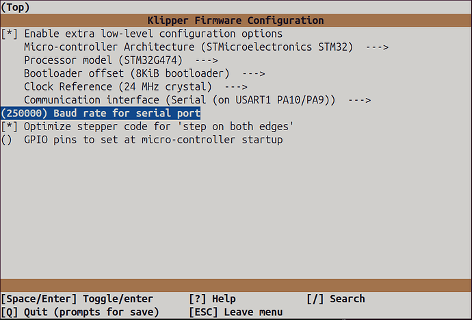

I am making my own custom 3D printer and using the STM32 NUCLEO-G474RE development board (having the G474 MCU), am using the Raspi 4B 4GB as my host. I used KIAUH to install Klipper (v0.13.0-433), Moonraker (v0.9.3-130) and Mainsail (v2.16.0).
I am also able to successfully flash the Klipper firmware onto the board using the st-flash command using the on-board ST-Link (for some reason it fails if I try to flash using KIAUH, probably because I’m not trying to put my device into DFU mode, but don’t need that anyways). The Klipper Firmware Configuration for the same has been shown in the image below :-
(I even tried using Internal clock as Clock reference and 115200 as my baud rate but that didn’t work either.)

I connect my Raspi and STM dev board using a USB-to-UART device. but when Mainsail tries to communicate with the firmware, the firmware doesn’t reply back and Mainsail throws an error like this (referenced from my klippy.log file) :-

Now, I have performed various check to verify whether all parameters are correct or not :-
  1. My TX/RX pins are connected the correct way, Tx→Rx and Rx→Tx.
  2. I have verified successful flash on the MCU using the STM32CubeProgrammer software.
  3. I even flashed my own firmware containing a small UART transmit code onto the same board to verify whether there wasn’t a hardware or pin issue.
So I have performed all the basic checks and still haven’t been able to pinpoint the exact problem. Also, there is no existing 3D printer that I could find that uses the same hardware configuration like mine, which makes this even harder. Now after days of debugging the issue I feel the problem could be either :-
  1. The Klipper firmware build itself has an issue, or
  2. My printer.cfg file is not upto the mark for my board.
I would be highly obliged if someone could help me out here, thanks!
Update: So I noticed in the Option Bytes setttings for my NUCLEO-G474RE, I had checked the nBOOT0 option, hence setting the nBOOT0 bit to 1. This caused the mcu to boot from system memory and not from flash. I corrected this, but still I am facing the same issue of MCU not communicating with host.

Typically, if the host can’t communicate with the micro-controller it is due to incorrect printer.cfg settings or incorrect “make menuconfig” settings. Unfortunately, it’s difficult to say what settings are the issue.
I’ve tested the stm32g431 on a local test dev board. I haven’t personally tested the stm32g474, but as far as I’m aware it should work.
Some random suggestions: don’t mess with baud as it’ll only lead to confusion - you should return to 250000 in both the host and mcu; it’s very rare to have a bootloader offset if you flash via st-link or dfu-util; if unsure of your crystal speed try using “internal clock”; double/triple check your uart pins; sometimes its easier to bring up usb than uart so you might want to try wiring the usb pins if that is possible.
Okay so the NUCLEO-G474RE didn’t have a USER USB port, so I went an made a separate circuit acting as the USER USB. After I went through with the configurations advised by you, the mcu started communicating perfectly!! I guess the issue earlier was that I was trying to configure it using the 8kiB Bootlader option, which would crash the firmware instantly. So, thanks a lot Kevin for helping me out here. I appreciate your help :slight_smile:
