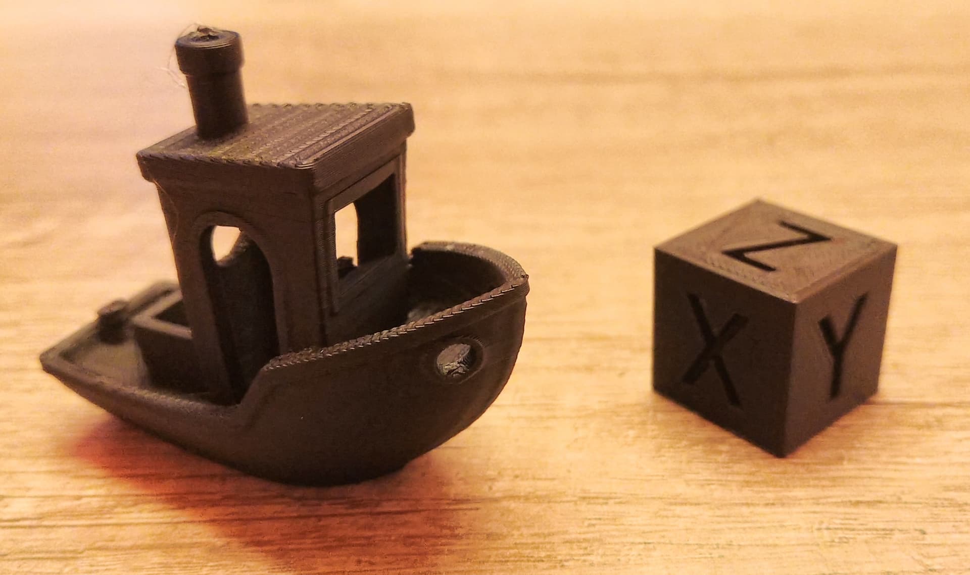

Finally, I did it. So I was right about my .cfg being the culprit.
I took a look into yet another delta printer.cfg and changed / add the following:
  • under [stepper] I added angle
  • I added [gcode_arcs] resolution: 0.7
  • changed under [bltouch]
    • samples_result from average to median
    • samples from 1 to 2
    • sensor_pin from ^P1.0 (PWRDET) to ^P1.26 (EODET)
And I also switched to Fluidd, but that didn’t fix it, what I already expected, I’m going back to Mainsail, I like it more than Fluidd. What exactly was the reason for the layershifts, out of those changed I don’t know, going to find that out later, I guess it’s the added line angle, which btw isn’t listed in the Configuration reference under [Stepper]. Maybe it was the BLTouch, not the changed Pin assignment, but doing two samples and doing median. And the rest i honestly just added because it were in the printer.cfg I looked into.
Anyway, I couldn’t be happier to finally got it working. For those who want to take a look into my current config, here it is again:
printer.cfg (9.1 KB)
Final question … at least for now, is there anything I could or should improve in my config, any questionable lines i should take a look at, unneeded or missing, overall structure?
Inputshaping is on my list, have to reinstall it yet.
These prints are PERFECT!
Glad you like it :slight_smile:
