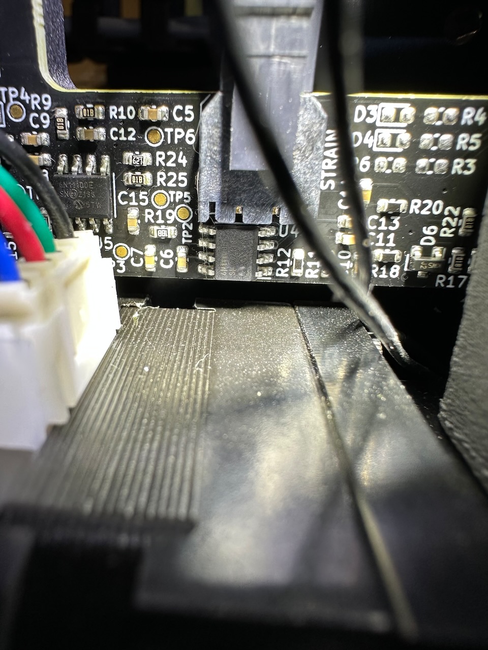

Here is a close up of that chunk of the board:
I haven’t tried to produce an electrical diagram, I figured I’d wait till they open sourced it.
Are both S0 and S1 pulled high? Beacouse in the picture it looks like S1 is connected to DGND.
Can you take a picture of the backside of the pcb?
The back side is no help, it’s just a solid plane with some vias. My guess is it’s 3 or more layers.

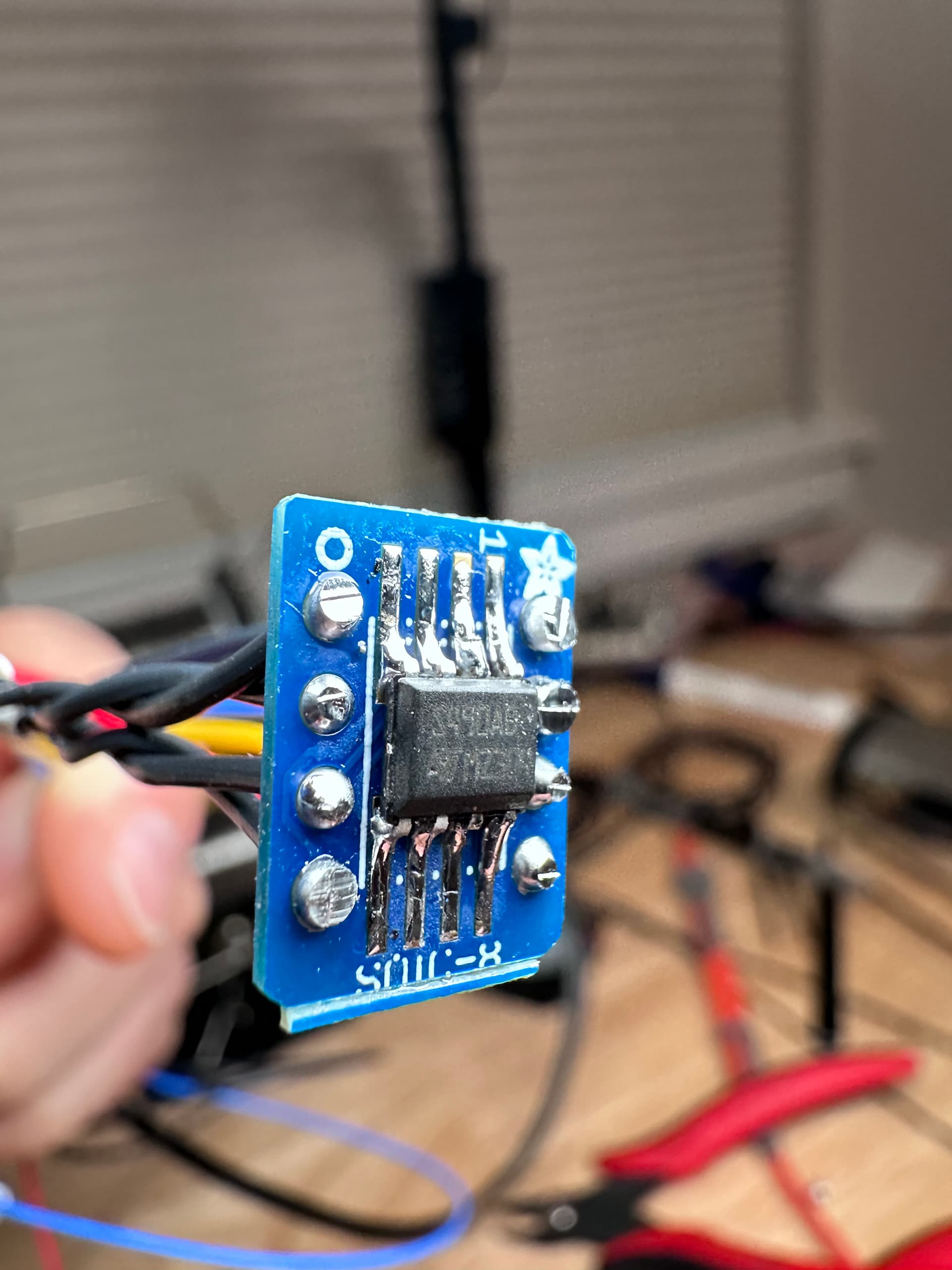

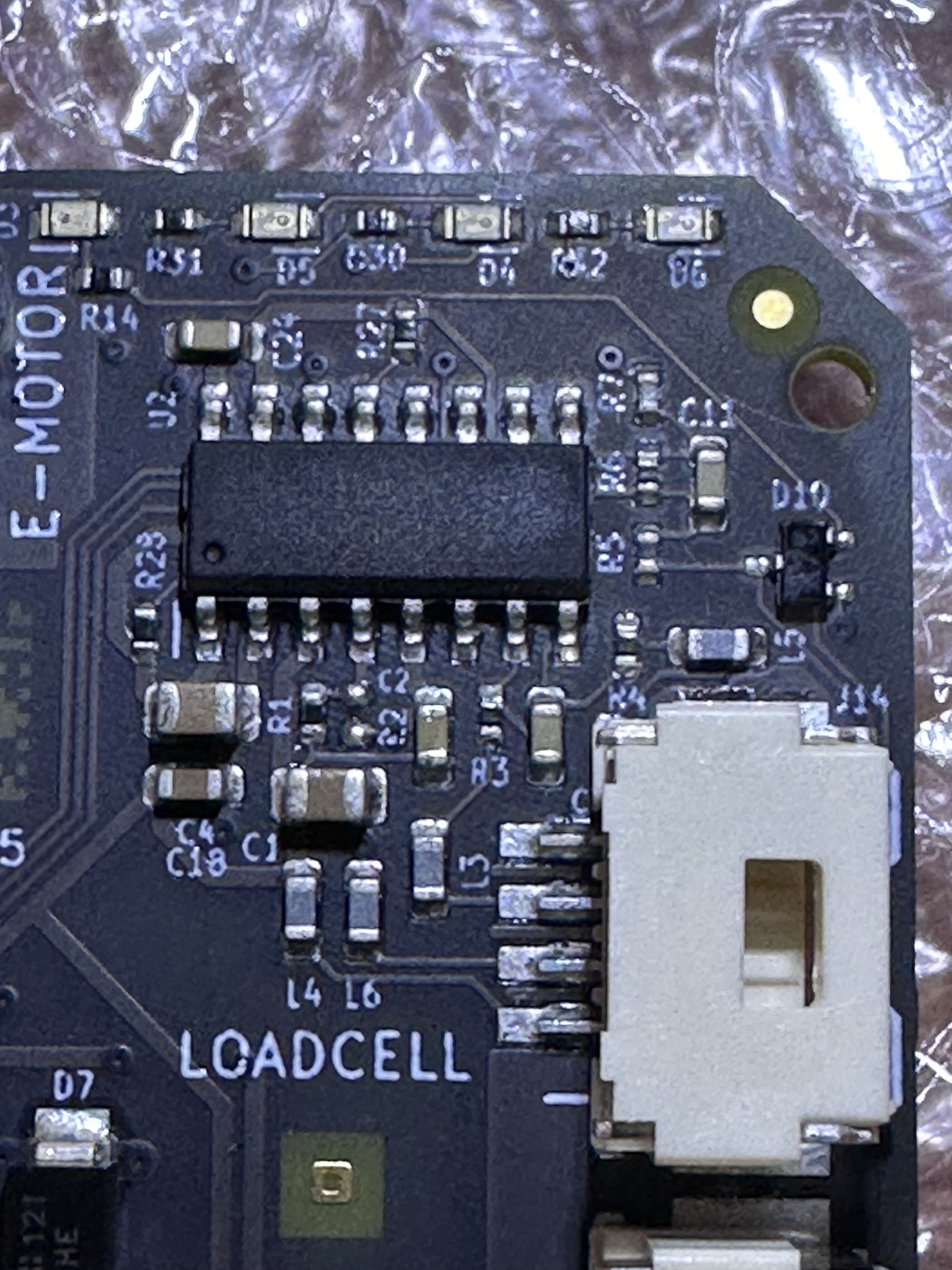

I just got my MK3.9 upgrade bundle with the MK4’s main board. There is a second ST490AB on that board and its hooked up to the pins for the one on the LoveBoard. So I need to find one of these on a breakout board that lets me connect it up to some I/O pins.
( Also, surprisingly, the ST490AB is like $3 each! That’s more than the HX717 is!!)
Edit: Adafruit has SOIC-8 breakouts so you can combine that with the ST490AB chip for a working solution

Success:
Prusa Love Board with HX717 talking to klipper. It homes, it probes and it quad gantry levels. I have the ST490AB on a breakout board and did the twisted pair wiring as per the spec. (looks gigantic but smaller than a postage stamp)

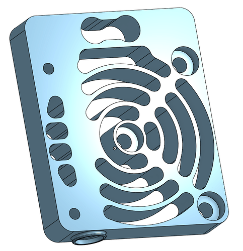

Messing around in CAD again:
I put the features on the end to support the Revo heater blocks and nozzles. I have no idea how to get it manufactured though. Those features are so small I guess you need a custom form tool ground to even cut them. I’d have to go to a machine shop with prints with tolerances on them to really communicate what I need done.
