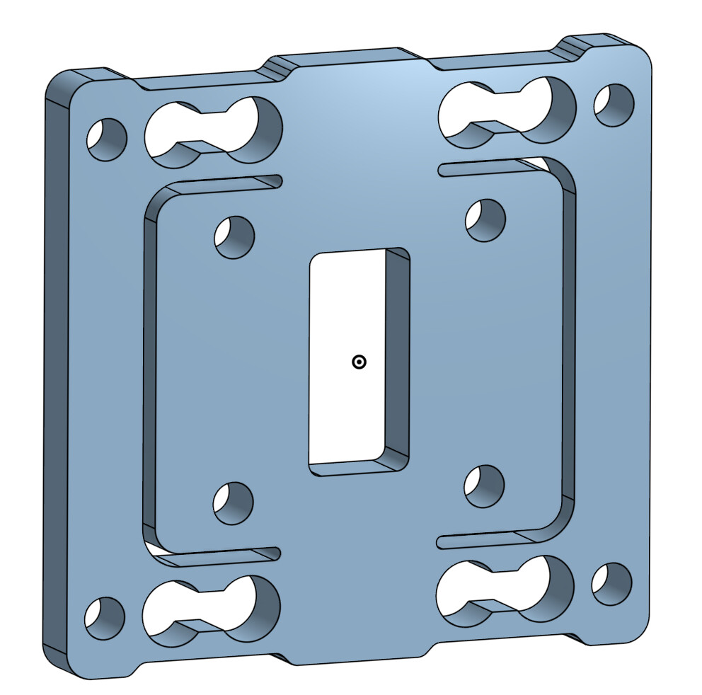

I really want a toolhead load cell concept that can be manufactured with a minimum of processes so its economical to test out. We will have to do a lot of iterations. Ideally just a flat block of laser cut aluminum with minimal to no machining. SendCutSend can do these for minimal cost.
I was idly sketching a 3D Printer concept in CAD and going over where I could mount the load cell and came up with this idea:
Its a plate that attaches to an MGN12H carriage via the 4 central holes. A 3D Printed part would be attached to the back to grab the belt teeth on a Core XY printer. The hole in the middle allows the belts to exit.
There are 4 outer 3mm holes to attach the toolhead to. So this is a “toolhead adapter plate”. You can use whatever toolhead design you can adapt to this.
There are 4 “dog bone” flexures but you only need to put a strain gauge on 1 of them. Its just symmetrical to carry the load symmetrically.
Negatives:
  • weight: this would add ~20g to the toolhead
  • Extrusion force cant be measured. I guess one fix for that would be to extend the structure upwards and attach the extruder to that.

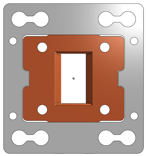

Riffing on this idea and trying to DFM for CNC process I came up with this:
I wanted really tight tolerances at those split lines to save as much space as possible. The easiest way to manufacture that is to just split the entire thing into 2 parts. Then you have easy access to all sides in 2 separate processes:
  • The outer silver/flexure part can be made out of Aluminum on a CNC machine with a 3mm endmill. It requires 4 holes in 2 ends now but at least there is lots of places to grab the part in a vise. No wire EDM needed. It could also be 3D metal printed. The outer holes are tapped so the toolhead can be mounted blind.
  • Added a feature to limit the travel of the flexure. If the toolhead crashes it will bend the X axis before it permanently deforms the flexure.
  • The inner part is 3D printed plastic. That means its easier to include the complex geometry to grab the belts against the face of the MGN12 carriage:
It also means your free to modify that part to suit your needs. E.g. adapt it to MGN9, or some other mounting.
The whole contraption goes together with 4xM3 bolts from the top/bottom. That adds some possibilities, like using these holes to mount the Extruder as well.
This looks manufacture-able and adaptable to existing hot ends and extruders.
interesting idea.
But if I understand this right, this works only if the x-rail is mounted sidewards on the x-beam like a voron style printer. If the x-rail is mounted on the top of the x-beam like a Vcore for example this design needs a change or implmented in the toolhead design between the frontplate and the top part that is attached to the rail carriage.
You could make a different plastic block to go in the middle that attaches to a top mounted rail. But I think you are right. For best space efficiency you could probably design something different for a top mounted rail.
I don’t like the top mounted designs because the cantilever distance to the nozzle tip is increased. (center of rotation is the center of the rail)
Yeah I know what you mean, but mind that the part fan is mounted on the backside of the toolhead and the motor of the extruder is placend above the x-rail, so the overall center of mass of the toolhead is more in the near of the middle of the x-beam, so the summary load ont the x-rail is more “pull downwards” compared to front mounted rail there you have summary more a “hanging mass”, that pulls the rail carriage sidewards if you know what I mean…
But no matter for sure we can create two version for these different designs
