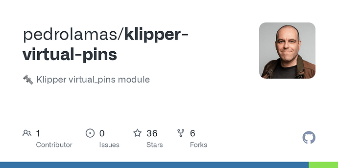

Could the endstop pin be a virtual pin?
Oh that I don’t know…
Unfortunately, virtual pins do nothing when commanded to home.
