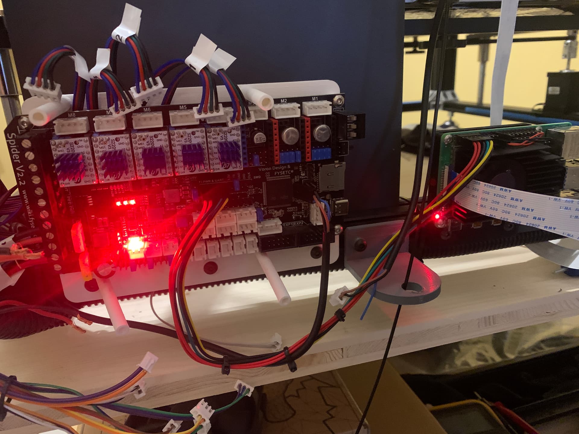

my Tronxy mit Raspi UART to Spider V2.2 certenly stops working?
I think it was an Raspi Update of OS via Mainsial, but not sure.
Maybe you can help me out, finding the big problem now.
) I installed a new sd on raspi with klipper, same error
) flashed the boot loader on Spider, “make” a new firmware file
still the error on mcu - printer is not ready?
actually nothing is connected ot the Spider board, only the USB-UART connection, that also powers the raspi.
printer.cfg (13.0 KB)
moonraker.log (76.1 KB)
klippy.log (76.7 KB)

my firemware.bin on the sd card was renamed to old.bin, I think flashing did work.
now the output changed

no, just some lines ar red
done these settings for firmware of the spider board
Spider
running again, did everything new, cannot say where the problem exactly was.
