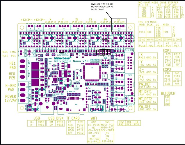

You’re great, I’m glad you answered. I appreciate your time. Is there any chance you could explain to me how to connect the jumpers in a diagram?
Yes I saw this but I don’t have much knowledge about MCU for this Marlin :frowning: That’s why when I read it it doesn’t remind me of anything like it does for you, that’s why I opened a support request. If you have time, would you like to help someone who doesn’t know :slight_smile:

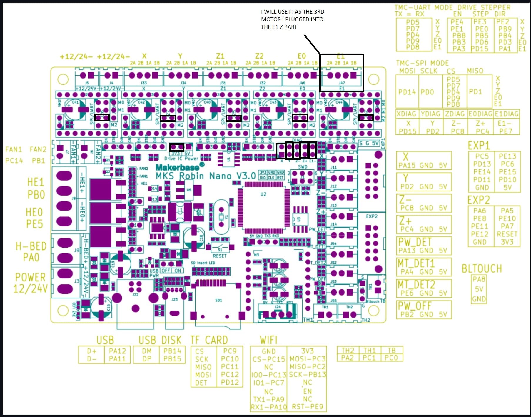

I think the connections should be like this, if I’m not mistaken
Finally, I apologize for giving me so much trouble. Do you have an example of a klipper print.cfg file related to this subject or could you help me make one? This is the first time I’ve used klipper, so please excuse me for that.

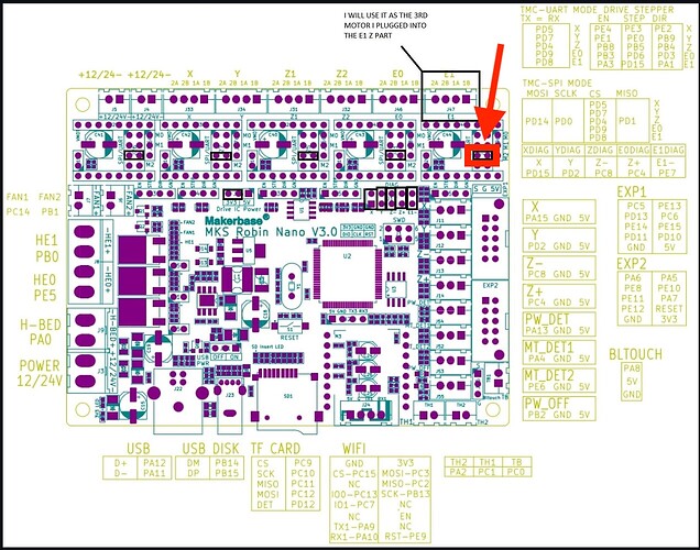

The four-pin selector you circled is to plug in the actual stepper. @Sineos is referring to the UART jumper pins. See the red annotation in the below picture.
I’m sorry, I didn’t understand what you meant. Could you please give me more details if you have time?
Could you try putting a jumper on the two pins indicated by the red annotation in the picture I provided?
