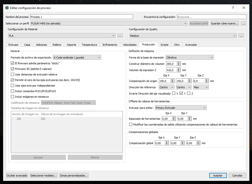

Hello everyone, I hope someone can help me with this. My machine gave me this error and it froze with the hotend on top of the print and I could not continue my print for 9 hours.
The gcode and klippy are in wetransfer because they weigh a lot.

Hello Eddy, thanks for your answer, I have tried it from below but not from above, but the problem was in the center, not at the ends.
I am going to do some test to prove that same thing that you tell me in the upper extremes.
The given error
Move out of range: 36.760 23.589 377.221 [129601.713]
refers not in the centre.
BTW, there are more out of range errors:
Move out of range: 0.108 -118.314 417.224 [-101.000]
However, the printer can’t reach that coordinates.
Anker
May 19, 2023, 3:49pm
5
And is it a problem of klipper or gcode itself?
More of the gcode than of klipper.
And if it is the gcode then it is an issue with the slicer not having the correct limits for the print volume.

Do you see any problem or error here?
I can’t tell if it is right or wrong, because I don’t know what the printer is really capable of.

In theory these are the measurements of the printer, what I don’t know is if there is something mis configured.

I tried to move the head from the klipper menu from home and I get these errors.
I see.
Now you can decrement the Z value in steps of 5 mm or so until you get access to the complete build area. That Z value is the maximum Z height.

I moved the z axis -5 towards the print area and then I moved the x and y axes and it threw me those errors at certain heights.

It seems to be a klipper error, right? it can be fixed?
Can you please post such long code with those tags:
You can not move in the X and Y plane when a Delta is at max height that is how deltas work not a klipper issue.
The print area cones to a point at max height.
Anker
May 23, 2023, 4:00pm
19
I understand then the measurements of the printing area that are given in the specifications of the machine are not correct: I, because they say that it prints up to 41cm in height. Thanks for the reply
