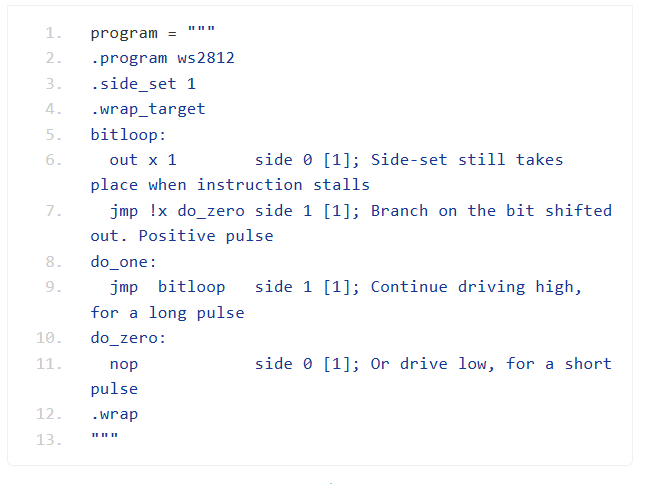

Every other neopixel library out there makes the 1 pulse at least 700ns and they don’t have any compatibility problems. I tested this Adafruit implementation with my problem LEDs and it worked fine.
This uses a 700ns 1 pulse. It use PIO so the speed of micropython does not influence the result. I ported it to C++ anyway. Note that Adafruit invented the term NeoPixel, so they are the ultimate authority on what a NeoPixel actually is.
This uses PIO with an integer divider meaning the timings are extremely accurate. With the BTT LEDs I could not reproduce the case where pulses are only sometimes recognized as a 1 with this set up. At 650 it is always 0. At 700 it is always 1. However switching to a fractional divider, which makes the pulses vary in length, does reproduce it.
With Klipper, the variance in pulse length seems to increase as you ask the firmware to do more things, so it is worse on a real toolhead than on my example which just has neopixels and nothing else. But it is still reproducible.

PR is done: neopixel: Increase PULSE_LONG_TICKS to 800 for compatibility by ali1234 · Pull Request #7113 · Klipper3d/klipper · GitHub
Thanks. Just out of curiosity, how did we get to 800ns from 700ns?
700 “works for me”, but “works for me” is the reason people have so much trouble with these LEDs, and as I said in the original post “it should probably be much higher.”
So I chose 800 for the reasons outlined on the PR (in the comments). It’s the standard for the one library that doesn’t let the user configure it, at least one WS2812B (the most common non-clone) datasheet calls for >750, and it is about as big as I’m comfortable proposing without tweaking the other timings too.
