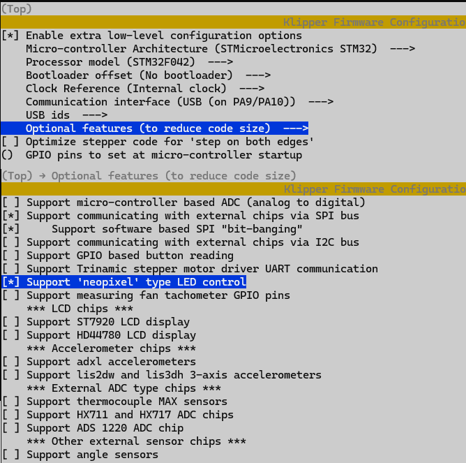

$ make menuconfig
[*] Enable extra low-level configuration options
    Micro-controller Architecture (STMicroelectronics STM32)  --->
    Processor model (STM32F042)  --->
    Bootloader offset (8KiB bootloader)  --->
    Clock Reference (25 MHz crystal)  --->
    Communication interface (USB (on PA11/PA12))  --->
    USB ids  --->
    Optional features (to reduce code size)  --->            # You want to look here
[*] Optimize stepper code for 'step on both edges'
()  GPIO pins to set at micro-controller startup
[ ] Support micro-controller based ADC (analog to digital)
[ ] Support communicating with external chips via SPI bus
[ ] Support communicating with external chips via I2C bus
[ ] Support GPIO based button reading
[ ] Support Trinamic stepper motor driver UART communication
[*] Support 'neopixel' type LED control                      # Do make sure that it is checked
[ ] Support measuring fan tachometer GPIO pins
    *** LCD chips ***
[ ] Support ST7920 LCD display
[ ] Support HD44780 LCD display
    *** External ADC type chips ***
[ ] Support HX711 and HX717 ADC chips
Hope that helps.

Yes, it is and it is not cool, of course, but I suspect it has nothing to do with neopixel:
Git version: 'v0.13.0-152-gf54b7b937-dirty'
Untracked files: klippy/extras/autotune_tmc.py, klippy/extras/motor_constants.py
So, from my humble point of view, it is the MCU config issue.
In my (admittedly limited) experience when building the Klipper Firmware image for a limited Flash device you will get an error if there isn’t enough space in the selected device for the built Flash.
Now, I just tried to build for the SMT32F042 without limiting any of the build options and the make failed as expected and when I looked in ~/klipper/out there is no klipper.bin firmware image file:

Now, in the OP, @mullemeck seems to indicate that he was able to build an image for the STM32F042 - I think there needs to be an understanding what happened there.
@mullemeck the ball’s in your court. I guess what we’re looking for is:
  1. An explanation of how you built the firmware for the expander board and what were the results.
  2. The latest/correct printer.cfg and expander.cfg as well as any other *.cfg files that you are using. I’m asking this because Klipper can be a bit funny with device/operating statements that are not in printer.cfg. If you have something outside of printer.cfg then it may not be picked up and I’ve seen some cases where they aren’t applied properly. The rule of thumb that I use is that everything with the exception of macros should be in printer.cfg.
  3. A Klipper installation that is “dirty” is often problematic and could mean that the Klipper image was loaded from a third party site and has been modified for some specific reason. Please reload so that it is no longer reported as “dirty” or explain where you got the version of Klipper that you’re using and why you’re using it.
Thank you for your coments.
I have been out of town so hav not been able to test your suggestions untill today.
Since my latest atempts there has been some updates for klipper, but stupid as I am i did not dokument what they were about, I just applied them.
And after I had read all of your comments I recompiler the firmware for the expander board, with the same settings as before, I think, and now everything works!
Maybe I did some thing different this time but I think it was the update of klipper that made it.
The reason the klipper is dirty is that i have instaled Klipper TMC Autotune.
Here is the settings I used:
You may find a bit of documentation here: Region ROM Overflowed / Region Text Overflowed
