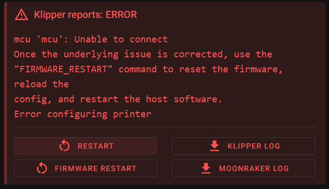

New mcu board but error
Printer Model:voron 2.4
MCU / Printerboard:BIGTREETECH Octopus Max EZ
Host / SBC:raspberry 4
klippy (2).zip (31.8 KB)

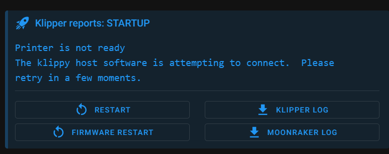

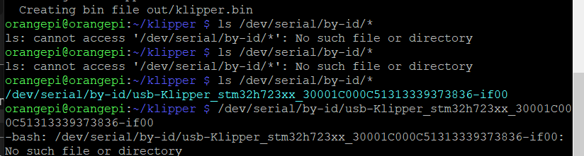

After three minutes, the following screen will appear. Thank you in advance.
What is the process you used to determine the device serial that you put in your printer.cfg?
When I look at your klippy.log, it indicates that:
mcu 'mcu': Unable to open serial port: [Errno 2] could not open port /dev/serial/by-id/usb-Klipper_stm32h723xx_30001C000C51313339373836-if00: [Errno 2] No such file or directory: '/dev/serial/by-id/usb-Klipper_stm32h723xx_30001C000C51313339373836-if00'
What do you get when you SSH into your system and execute:
ls /dev/serial/by-id

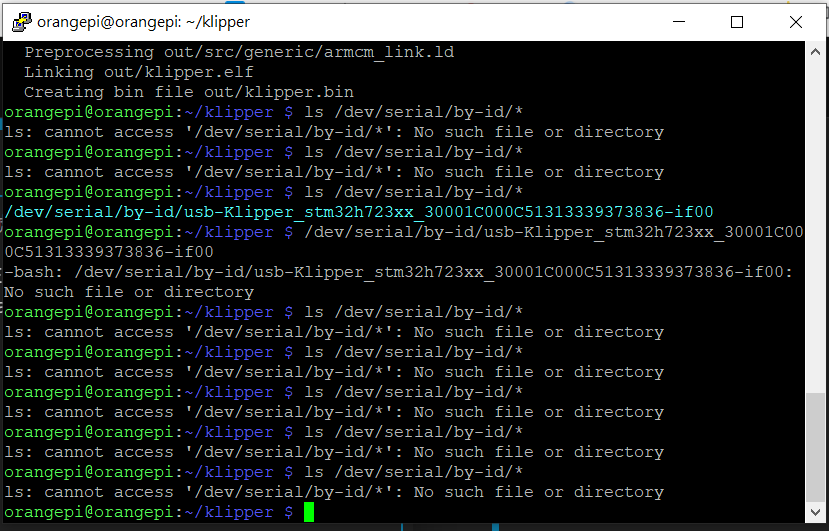

What am I looking at here?
First off, it looks like you’re not using a “raspberry 4” that you indicated in the OP. What is the host system that you are using?
Next, what is the process you used for loading the Orange Pi and building the Klipper firmware image as well as burning it into the Octopus Max EZ?
Finally, what do you get when you currently just put in:
Yes, it’s a Raspberry Pi 4. I followed the video exactly.
Finally, I ran ls /dev/serial/by-id/* and modified PRINT.CFG.

I’m asking because in your screen grab:
You’re UserID is “orangepi” on hostname “orangepi”. Are you saying that when you imaged your Raspberry Pi 4, you set things up with “orangepi”?
Next, I asked for the process you used to set everything up and you’ve provided me with a 26 minute video.
I’m not going through the whole thing - but I did scan it and I see that the person making the video seems to use a very non-standard way of imaging the Raspberry Pi. That’s a big red flag.
Again, could you write out the process you used for imaging your host and how you built your firmware and loaded it into the Octopus Max EZ?

Did you run the ls /dev/serial/by-id command in the last half hour and what did you get?
Trust me, I have three printers, two of which are ORANGEPI 2 ZERO. I set them up this way to avoid having too many passwords. As for the RASPBERRY installation, it’s exactly the same as the video instructions. If you can, please watch the video. The steps until 24:02 are the same.
I just tried again: ls /dev/serial/by-id/*
It seems unsuccessful. (See the picture above.)

I noticed line 75 of klipper.log:
serial = /dev/serial/by-id/usb-Klipper_Klipper_firmware_12345-if00
This serial number is the same as the one in Octopus-Max-EZ/Firmware/Klipper/generic-bigtreetech-octopus-max-ez.cfg at master · bigtreetech/Octopus-Max-EZ · GitHub . I’m curious. I’ve already updated print.cfg with the new serial number.
serial: /dev/serial/by-id/usb-Klipper_stm32h723xx_30001C000C51313339373836-if00
If there is no simple way, can I re-burn the firmware?(firmware.bin )

Hi, mykepredko, thank you so much! I just tried the instructions in the video again, and everything works fine. Thank you for your thoroughness. I have a printer, but I’ve never used this process before. I used a SPIDER board before, but it got stuck at this step, which is why I switched to an Octopus MAX EZ. There are so many internet resources these days, and everyone’s talking about different things. For example, I’ve tried at least three or four versions of the Raspberry Pi OS you mentioned. Not to mention ORANGEPI. I’m really new to this. As for your question (how can you use three printers with the same hostname “orangepi”?), I actually used the IP address to determine. As for KIAUH, I’ve also tried it, and it works really well. It just gets stuck at the last step: ls /dev/serial/by-id/* (I always use it on a SPIDER). Unfortunately, I’m very frustrated and still stuck at the flashing process. **Your method is actually similar to the video, but as a newbie, I’m still confused by the instructions (each step should be a paragraph of text and a photo). (This explains the hardware connection changes.) Perhaps this is something the manufacturer should provide, but sometimes manufacturers themselves can’t explain it clearly, even giving you URLs. Please read them carefully. I’m sure I’m not the first person to ask this question, but thank you. I may not have a substantive and direct answer to your question, but the internet needs people like you, who can help us newbies solve problems. Thank you again. If possible, do you have a method for booting the SPIDER?
