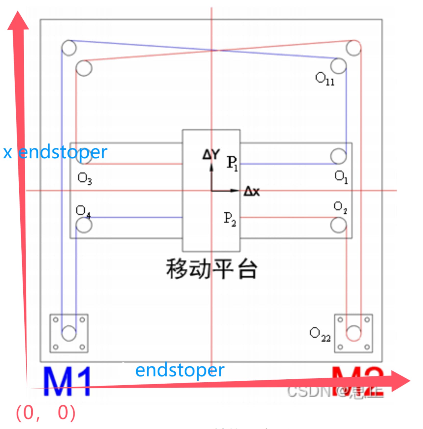

Please help corexy can not home zero
The physical structure of my MACHINE is like this PIC
HERE IS THE STEPPER CONFIGITION

Now I’m facing a problem that I can’t correctly HOME to zero. The specific situation is as follows:
when I set the motor DIR direction
dir_pin:PA5 dir_pin:PB0
OR
dir_pin: PA5 dir_pin: !PB0
HOME zero X , the print head will move towards the x+ direction of the physical machine,
HOME zero Y , the print head will move towards the Y+ direction of the physical machine.
dir_pin:!PA5 dir_pin:!PB0
OR
dir_pin: !PA5 dir_pin: PB0
HOME zero X , the print head will move towards the Y- direction of the physical machine,
HOME zero Y , the print head will move towards the X- direction of the physical machine,
SO PLEASE HELP ME ,

Ah just saw you have the wrong config or something thrown together:
homing_positive_dir:True
position_endstop: 0.2
position_max: 30
homing_speed: 20
First is, there is only a travel of 30 mm and that overwrites the former 200 mm.
Second and culprit here: homing_positive_dir:True That causes homing to max and not to 0.
So just remove that and check the whole config section for stepper_y.

If you want to home to 0 you need to comment or delete homing_positive_dir:True so it defaults to false.
