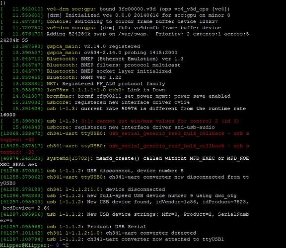

In DMESG I found everytime the error:
ch341-uart ttyUSB0: usb_serial_generic_read_bulk_callback - urb stopped: -32
Maybe some of you have a solution for my issue.

DMESG log
[ 1884.027186] mmc1: Controller never released inhibit bit(s).
[ 1884.027338] brcmfmac: brcmf_sdio_read_control: read 2048 control bytes failed : -5
[ 1884.027364] brcmfmac: brcmf_sdio_rxfail: abort command, terminate frame, send NAK
[ 8643.983957] ch341-uart ttyUSB0: usb_serial_generic_read_bulk_callback - urb s topped: -32
[15534.420863] ch341-uart ttyUSB0: usb_serial_generic_read_bulk_callback - urb s topped: -32
[87869.071197] systemd[22090]: memfd_create() called without MFD_EXEC or MFD_NOE XEC_SEAL set
Klipper@Klipper:~ $

Your dmesg output points to some hardware instabilities regarding the USB connection. Unfortunately, it is not clear what is causing it. Typical issues are listed here: Timeout with MCU / Lost communication with MCU
I solved the issue.
The Raspberry was a bit older and sems to be have a deffect.
Wit a thin client everything runs fine.
