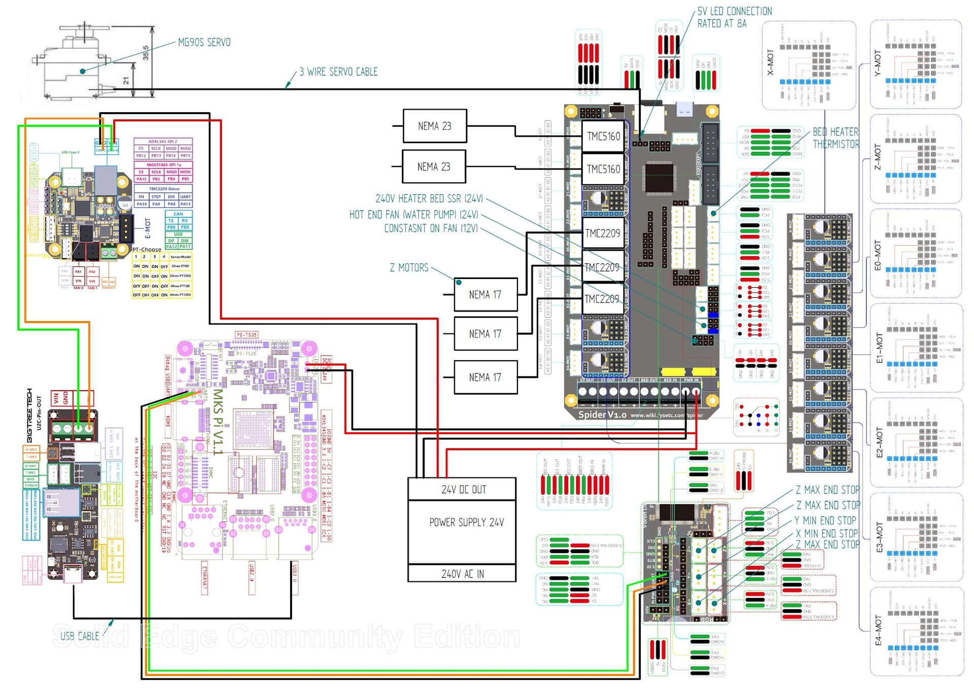

Please post a drawing (with pictures) of how you have wired your printer.
Here’s most of the wiring…
I’ve attached it as the PDF below, that’s probably easier to read.
Schematic.pdf (3.2 MB)
Let me know if details are missing that might help, I’ve left off the parts connected to the tool-head board as they’re probably not relevant for this.

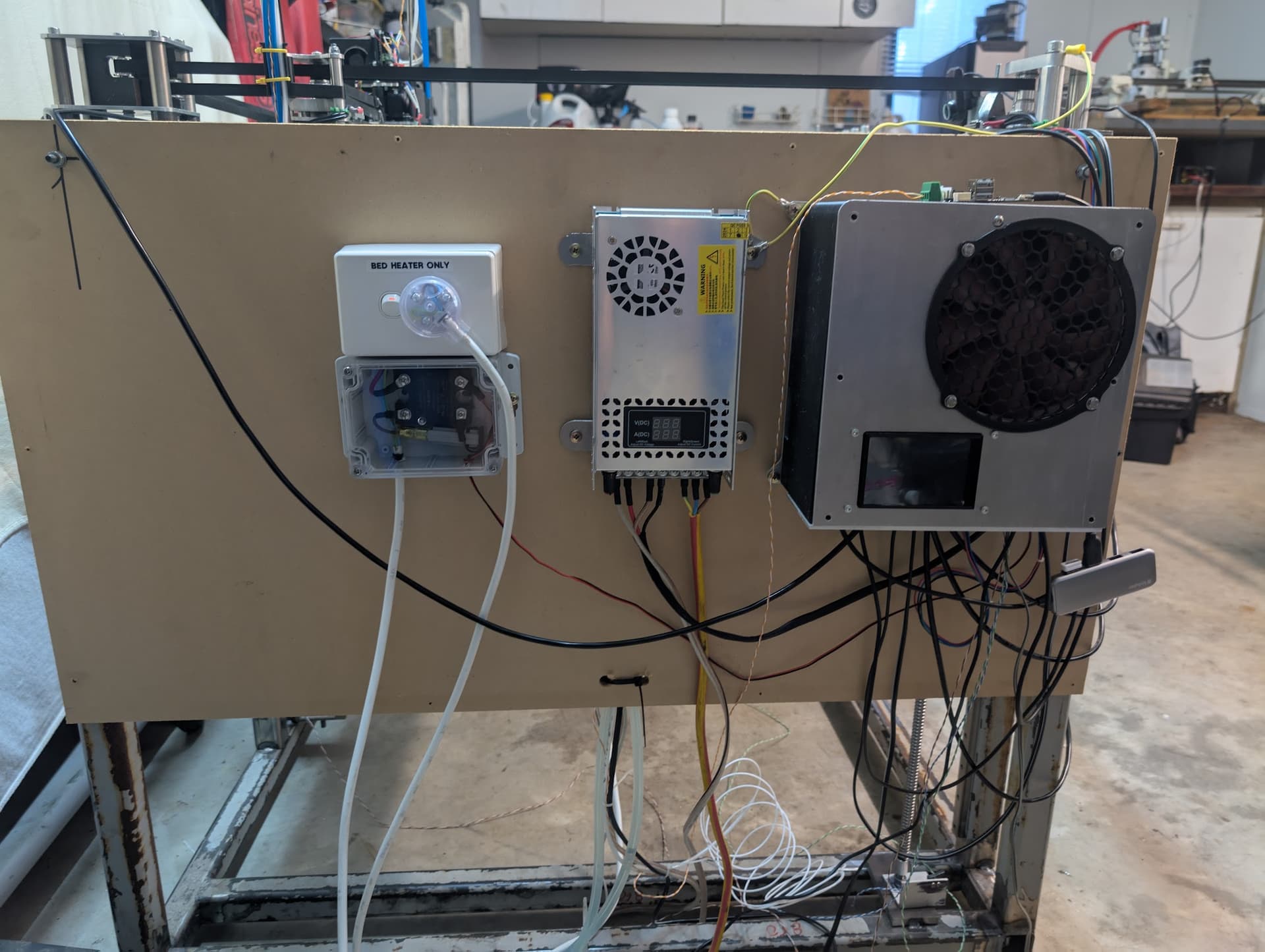

Here’s the setup on the side of the thing, this is all prototype so still messy.

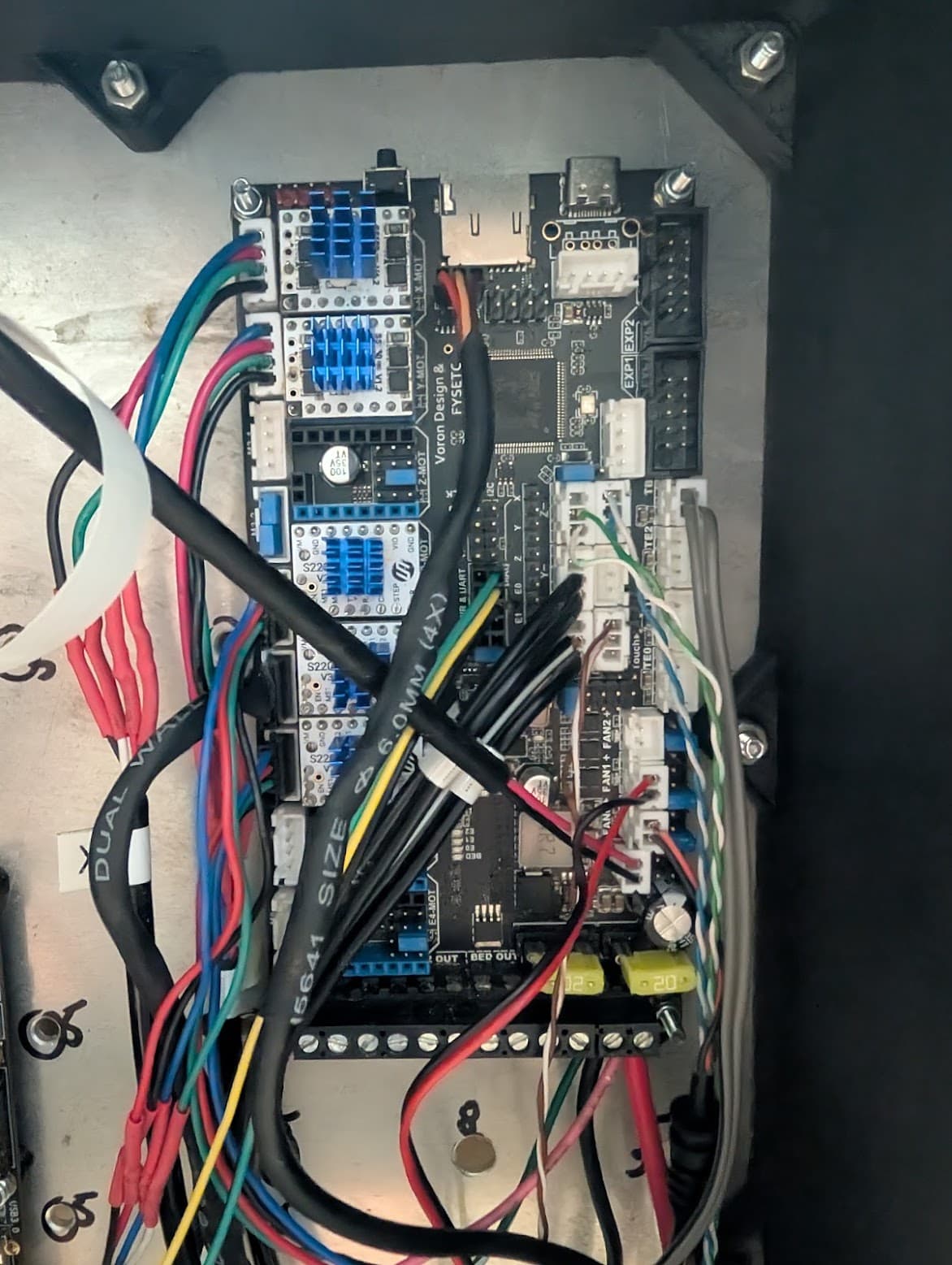

The mcu:
The MKSPi:
An overall view of the thing:

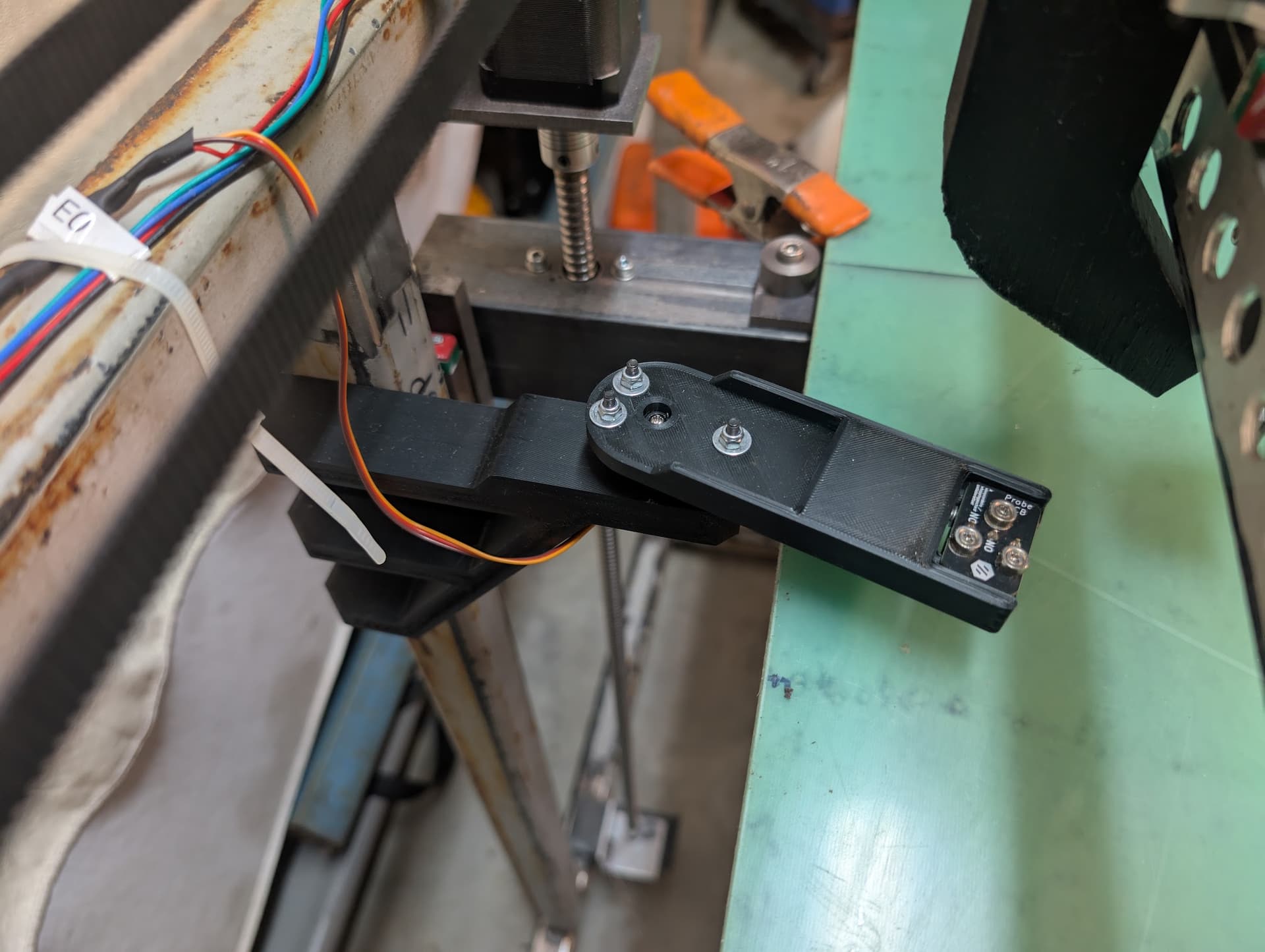

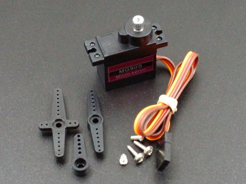

The offending servo:

Thank you - that’s a great amount of information and just what’s needed to help diagnose the issues.
A few things that aren’t clear:
  1. what is the communications connection between the MKS Pi V1.1 and the Spider board? I can see a serial connection from the MKS Pi V1.1 and the board at the bottom of the wiring diagram, but I don’t see one between the MKS Pi V1.1 and the Spider board.
  2. You talked about grounding the frame but you don’t show any indications of that in the schematic or the photographs.
  3. What is going on with the board at the bottom of the wiring diagram? It looks like it’s just being used for endstops but when I look at your klippy.log, I don’t see a [mcu ...] statement for it and the endstops all seem to be defined on the Spider.
  4. When I look at your klippy.log, you have endstop pins defined for each of your Z Axis stepper motor definition - you only need one for the z stepper, nothing is required for the z1 and z2 steppers.

@mykepredko Thanks for looking into this, the smaller diagram on the bottom right of the picture is a zoomed in section of the spider board, if you follow the green line up it’ll get to a dotted square that it represents.
On the grounding in the first photo you can see the yellow/green wires going from the PSU to the base of the controller box and the frame.
on the Z max end stops with the 3 Z motors, on homing the bed will drive down to trip all 3 which gets the bed basically level, then it comes up and I do a Z tilt adjust. I’m more comfortable doing that, that trying to launch straight into the Z tilt and I think the bed can tilt enough that the klicky switch would struggle to work at the extreme, and then things would get really messy.

Okay, that wasn’t clear to me that the box was part of the Spider.
Knowing that, I have to point out that you have a ground loop between the MKS Pi V1.1 and the Spider (Ground connected on the two boards from your bulk power supply and another ground connection on the two board’s serial ports). I’m pointing that out because you’re not using shielded wires and you have some pretty long wire runs. Honestly, I would have thought that a commercially available (even from a dollar store) USB cable would be superior.
The only reason I would think that the servo could be a problem electrically is if it is stalled and even then, it will only draw 700mA:
