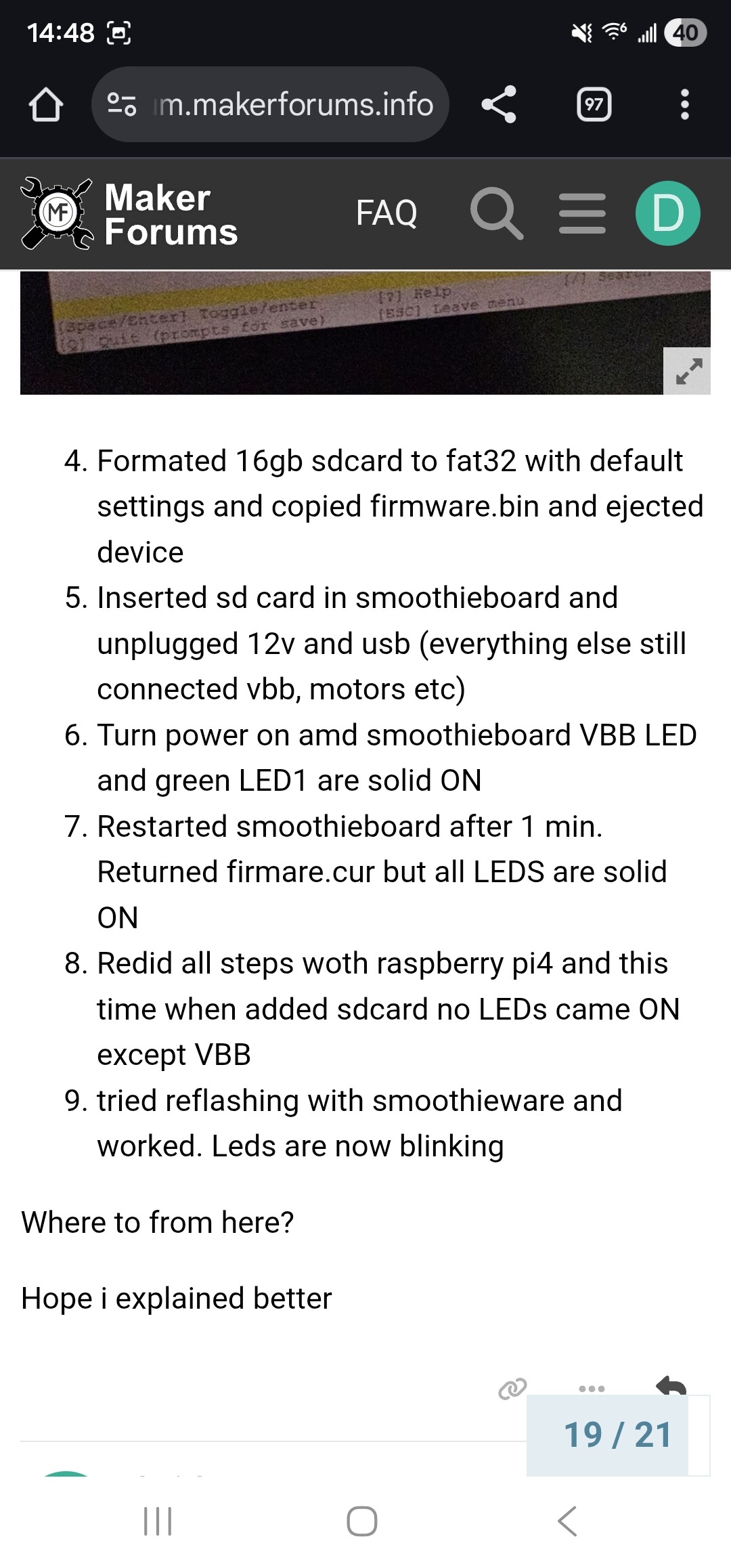

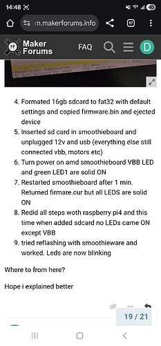

I installed klipper on my raspberry pi3 (and 4) and tried to create klipper.bin
When i put on sd card from pi3 or pi4 (tried 3 diff sd cards) and turn on amoothieboard (vbb connected and usb disconnected) vbb and LED1 are solod on. If i restart all leds are going solid ON

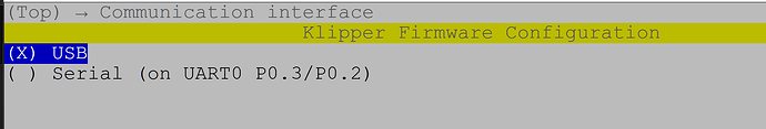

Created klipper.bin as
Lpc1769 120mhz
16kib bootloader (tried manually 32 amd 64 with no lick)
Usb com
And never flashes BUT if i flash with any .bin from frimwarebin on amoothie website it flashes
Any ideeas what m i doing wrong?

Have you tried alternate “communication settings” in makemenu?
Yes i tried woth 1768 100mhz as well.. with bootloader and without
Still no luck :frowning:
Can i install klipper via uart mode? From isp pins ?
Not the clock speed the communication settings
See: [klipper] Support for "make flash" on lpc176x (Smoothieboard and similar) - klipper - FreeLists
I choose USB.
