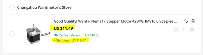

again, try the Wantai 42BYGHM810 - its a game changer
Hi thanks,
but that’s not a solution, not everyone has and can’t have this stepper.
Petr
You are in the US? Is there no local store?
It’s not a local store, I’m from the Czech Republic
Maybe this store?
thanks, but from Germany it is for the same money as from Aliexpress
Can you elaborate in which specific way is this stepper a game changer?
