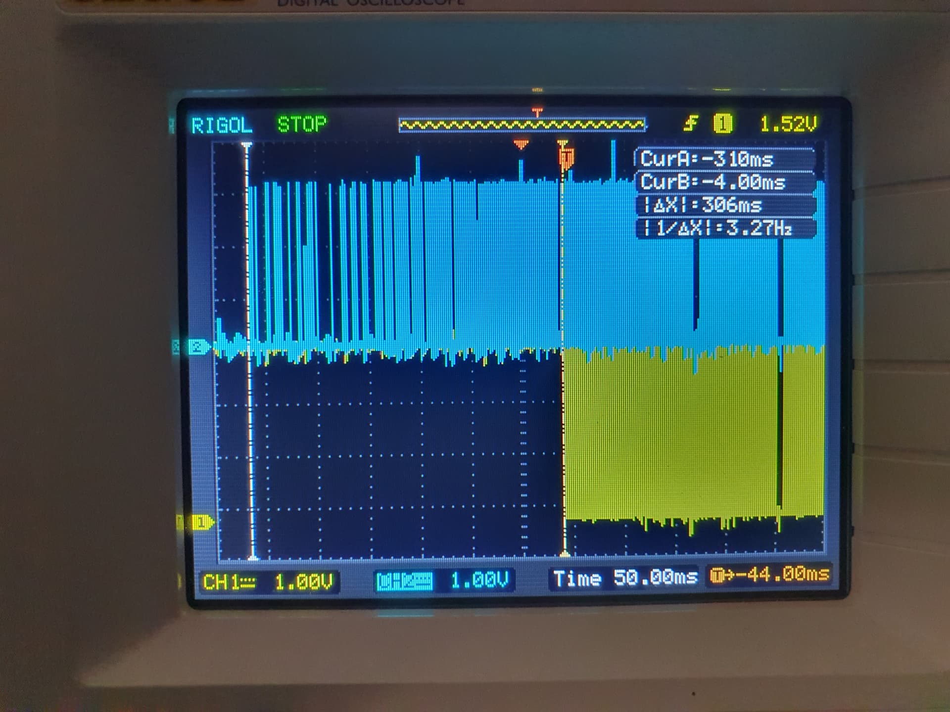

Hello together, I did a lot of testing in the last weeks so here is an update to this topic.
Since my last reply I tested a lot of things, such as different USB cables, config settings etc.
Nothing changed, the X and Y axis are going out of sync after a while.
Now I wanted to test if the error comes from the motor drivers / servo motors. So I borrowed an oscilloscope from a friend and hooked it up to the step signals of X Y and Z (only two at a time). Then I wrote a small macro which drives the toolhead diagonally and the Z axis down. I recorded the step signals of the axes at the start of the macro. In theory all axis should start at nearly the same time.
Here are my measurements after the printer was homed:
Y is the blue line, X the yellow one
So everything seems fine. (The small time delay of 4.6 ms maybe come from the different rotation distance). The Z axis is also in sync with X and Y.
But now comes the interesting part!
If I repeat the same procedure without homing after a print job where the issue of “oval printing” occurs, the result look like this:
Y is the blue line, Z the yellow one
Z is the blue line, X the yellow one
The step signals of Y are over 300 ms off compared to Z and X. And the really strange part is, that the steps of Y and Z are generated on the same board.
Does anyone have an idea what could cause this behavior?

I purchased two new Arduino Due to check that these are working properly. I made the same tests as described in my previous post. Sadly the printer is again going out of sync and the the step signal of X and Y are not starting at the same time.

Yeah the pictures could indicate this, but my measurements with the oscilloscope indicate that the step generation is not in sync.

Hello together,
I tested the above mentioned points and got the printer reliably to run!
In the end it was the programming port that made problems. As soon as I switched to the native port, everything worked like a charm. Changing the RTC or NTP settings didn’t had any effect.
If you are using an Arduino Due use the native USB port!
Thanks everyone who helped finding the source of the issue.
I will mark this as the solution. Maybe this information will be helpful for someone in the future.
