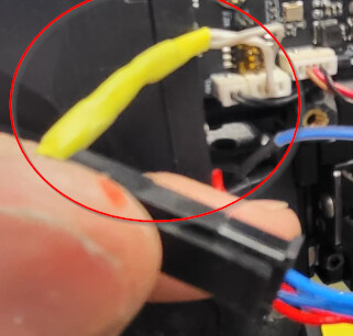

  • A PT1000 increases its resistance as the temperature rises.
  • You apparently get accurate values at room temperature, correct?
  • With rising temperature, the value displayed in Klipper “lags behind,” meaning it is lower than the actual temperature.
  • The higher the temperature, the greater the difference.
  • This suggests that the measured resistance of the RTD is lower than it should be and appears to be nonlinear.
Carefully check this connector cable. Inspect the crimps on boths sides. Measure it. Also measure the end of the connector cable against the other two pins on the connector (the pin connector on the board).
As an alternative you can try connecting the PT1000 directly to TH0:

This would be interesting to verify the PT1000. Generally, it’s an alternative, but I would really like to know the reason for this strange behavior.
I do get accurate values at room temp. I am currently at work, but will try this after work. Thank you
I have tested the connection for continuity of my jumper cable for the thermistor, all connections are testing good. I tested the pin out on the board sensor_pin: EBBCan:PA4 on the multi meter set to ohms and i get a fluctuating 8.96 ( not sure if that is the right setting to test it?)
I noticed that after a re-boot when i disconnect the thermistor from the sb 2240 the temp jumps to 300. If i recall correctly previously if i had disconnected the thermistor while printer is powered up it would normally report a thermal error.
I have changed the config as described above as well as moved my connector to PA3, i get an error for the Pullup_resistor: 4700 saying it can’t be under the extruder block.
Just omit it. It is the default anyway, and I have verified that the board actually uses 4k7.
