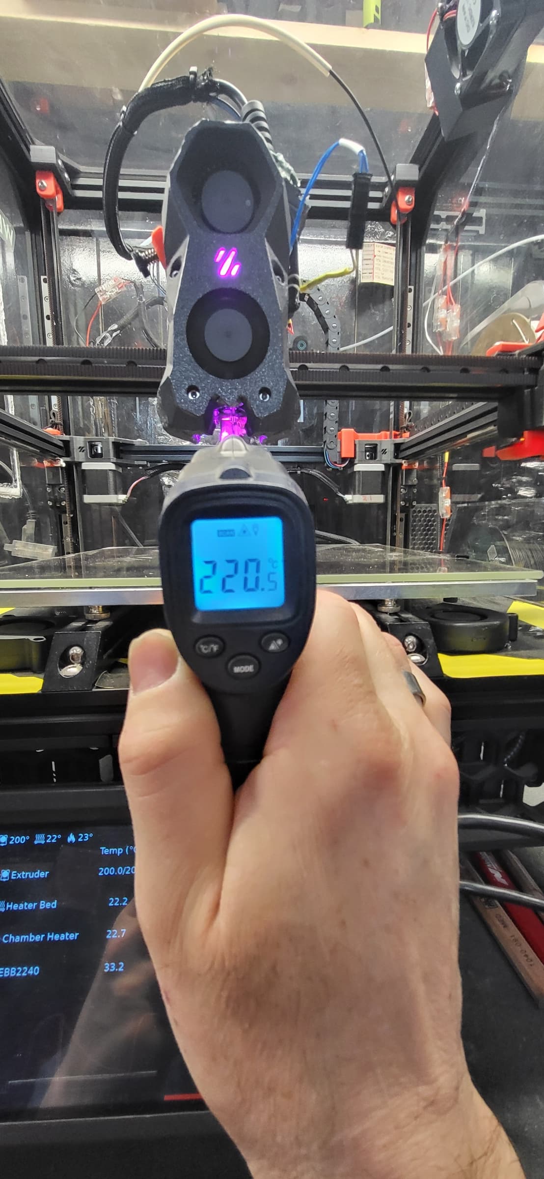

Using a IR thermometer
Test 1 @ 200 in klipper and 220 on the thermometer
Test 2 @ 210 in klipper and 250 on the thermometer
Not sure if the IR thermometer is acurite but that gap is more drastic the higher
i go in klipper.

Now we’re getting somewhere. Away with mindless trial and error, and towards systematically analyzing what is happening. :+1:
Your resistance values at room temperature look good.
The significant difference between the IR measurements and the Klipper readings is certainly surprising; I haven’t seen such a discrepancy before. So, at least I’m curious to see what it turns out to be.
  • Have you made sure that the probe is securely connected to the two innermost pins of the RTD connector?
  • Triple checked the jumper?
This is to be expected. Klipper is receiving a value that is too low, and Klipper can only react to the temperatures it “sees”.
The PT 1000B is fastened into the heating block. It is secured.
The dip switch: 1,2 and 4 are on. 3 is off.
