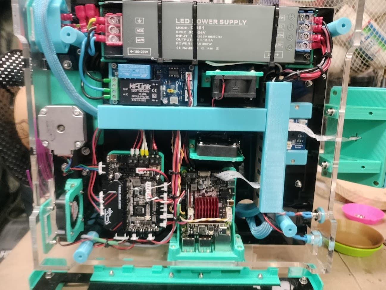

This is the inside of two of my machines

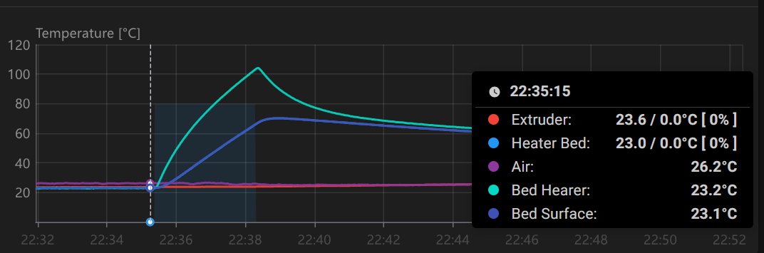

First I started the printer, and decided to look how the heating up curve looks like.
(bed surface thermistor is a control input)
Chart
We can observe, that on idle, both thermistors are in a good agreement between each other.
Then during heating up the difference becomes massive. I even had to turn it off, because heating pad exceeded 100C.

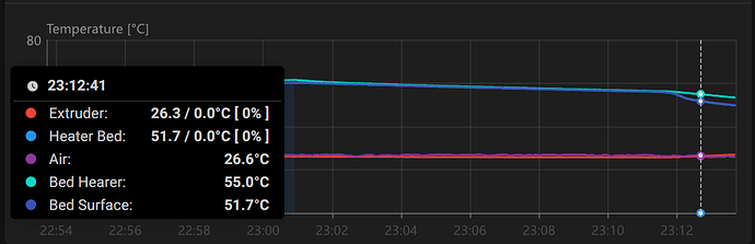

After i turned it off, the bed started to cool down naturally, but the bottom side of the bed is insulated, and the top side is not, so there is still a temperature gradient. It’s smaller than when the heater is on, but it’s still there.
Chart
As we can see, surface now reads measurably lower. And that depends on temperature.

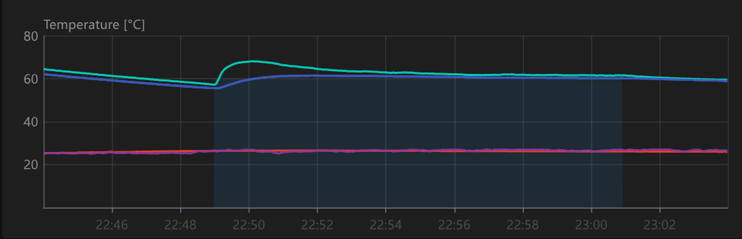

Ok, but what if you were right, and the difference is explained by different linearity of the thermsitors. (i mean linearity after a software compensation, since thermistor by itself is very non linear sensor of course)
Then i had an idea. I took blanket from my sofa, folded it a couple of times, and insulated the top of the bed with that. Than i turned the heater on (now on a lower target) waited a bit, and turned it off.
Chart
Now we can see, that even with the heater on, the difference became smaller. And when the heater is off, thermistor reading become almost identical, but now it’s on target temperature.
So we can now say that it’s not so much a linearity difference issue.
But the most interesting thing happened when i removed the blanket.
Chart
As we can see, after removing the blanket, very pronounced divergence between readings can be observed again.

You did a good job, my pictures are just for you to see some thermistors placed wherever, mainly in both power supply units, in one of them, three plastic straps are only to hold the white cable, in the other case, look for white tape next to a small green piece, every fan in pictures is running in a temperature controlled way, but the small ones over mosfets, that only works when the mosfet is working

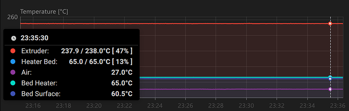

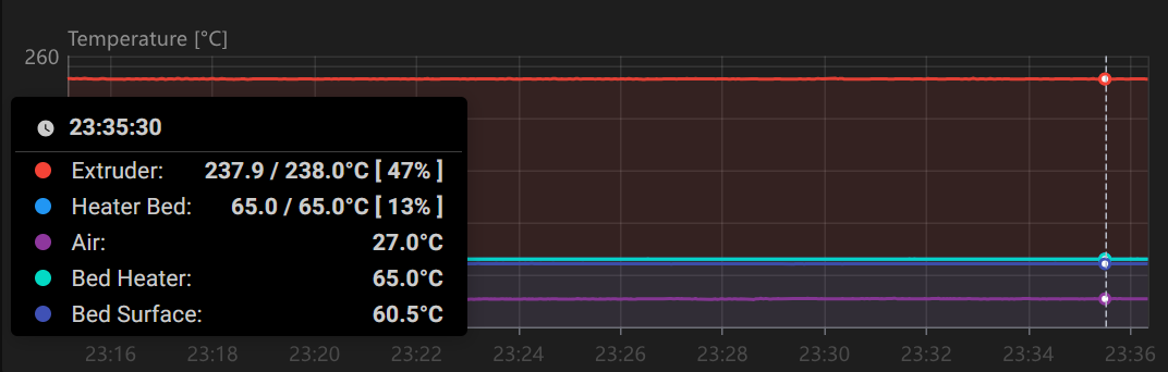

The issue is that observed shift is not constant. After yesterday’s experiments I’m pretty sure that it’s caused by the assembly thermal resistance, and that meas that the shift is proportional to the heat flow thorough the assembly. (Same as the voltage drop on the resistor is proportional to the current). But the amount of heat flow depends heavily on how much power is dissipated from the bed surface, which strongly depends on environmental factors. So it can not be statically compensated.
Meantime, today i needed to do some printing, so i reverted to heater thermistor for the bed control.
And here is how the situation looks during the print:
As we can see, when everything is stabilized long into the print, it’s close to 5C difference for 60C target now.
And by the way, If you are interested why it’s almost 240C on the extruder for PLA print, it’s because I have a rapido uhf style extender, an full cooling, so the same effect as on the bed is most likely taking place. I just don’t have a themistor over there.
