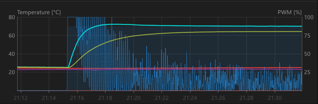

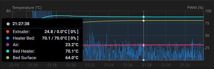

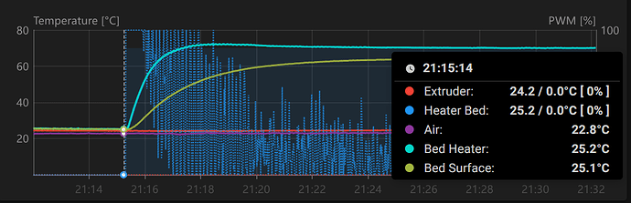

So before changing anything i did a control test by heating up to 70C:
Charts
As we can see it took 5 minutes to heat to 60C and the best it was able to achieve is 64C in about 12 minutes.

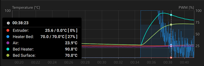

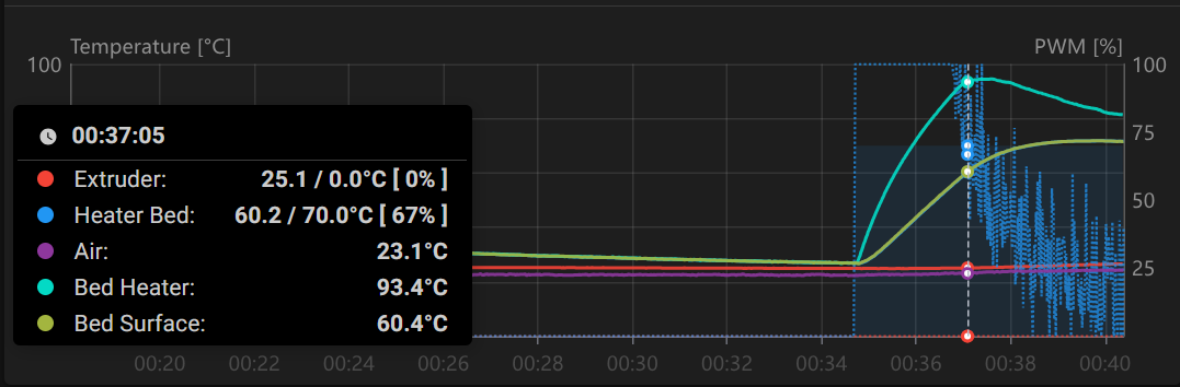

Then I repeated the same test
Charts
As we can see now it reached 60C in 2.5 minutes, and then it’s target temp of 70C in about 3.5 minutes.
As for me it’s quite noticeable improvement!
It was a bit of overshoot for about 1C, but it’s not that much critical.

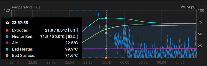

However, despite limiter action was present, it was not very pronounced. So i decided to repeat the test with higher setpoint of 85C to look into limiter in more details.
Chart for 85C
Now limiter action is much more visible.

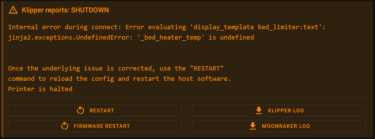

Template validation test
I intentionally did a mistake in my template, and now can confirm that the error is highlighted during klipper startup:
Error
