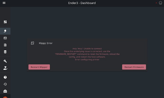

Hello.
I had a little electrical incident with the hotend, now I don’t get any communication through UART.
can you please tell me where is the problem?

In general, your board is simply not responding to the connection request. So, either:
  • Dead
  • Wiring issue
  • Wrong serial path. You seem to be switching between AS3 and AS5
  • Wrong settings on the host side
Since all are connected, of course a power peak can kill something on both sides.

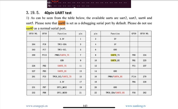

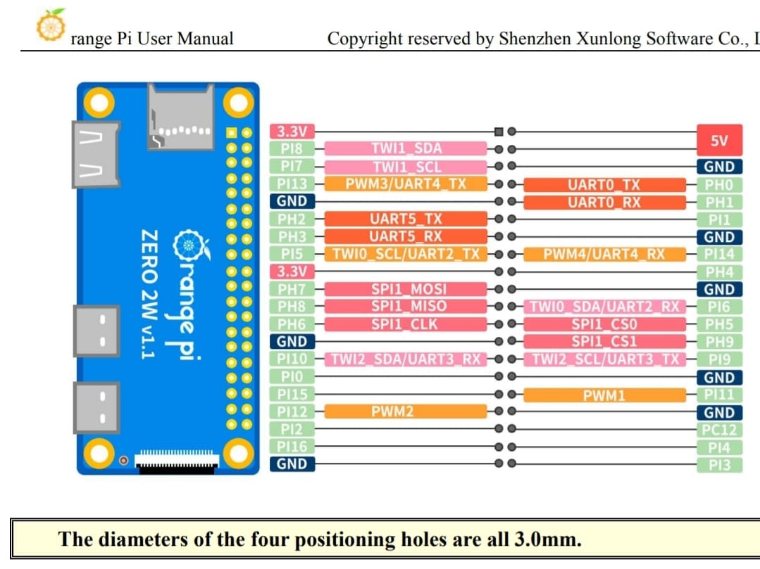

How have you wired in your Orange Pi Zero 2W?
The various UARTs to show up at different pins, but are you connecting to them?
Normally people connect the UART0 pins, along with 5V and GND (so the host can be powered by the main board) when using a device with the Raspberry Pi 40 pin connector.
I’m wondering why you are fooling around with UART3 & UART5.
First time dealing with pi in general, and manual mentioned not to connect to UART0

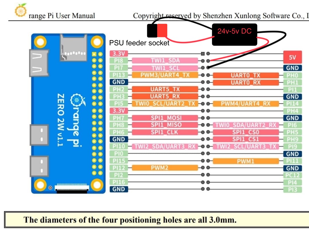

5v and GND to 24v-5v converter connected to PSU socket, UART5 to USART2 on printer board and I was connecting one accelerometer to SPI0 on the Pi and the other on printers board.

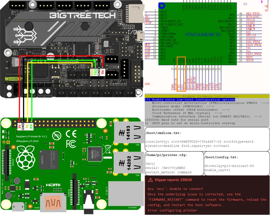

This is the traditional way to wire a BTT SKR Mini E3 V3 to a rPi 40 pin connector (note that the power from the BTT SKR Mini E3 V3 is being used to power the rPi):
Can I ask what your wiring for your Orange Pi Zero 2W and BTT SKR Mini E3 V3 along with the 24V/5V DC/DC looks like? Ideally a drawing and photograph.

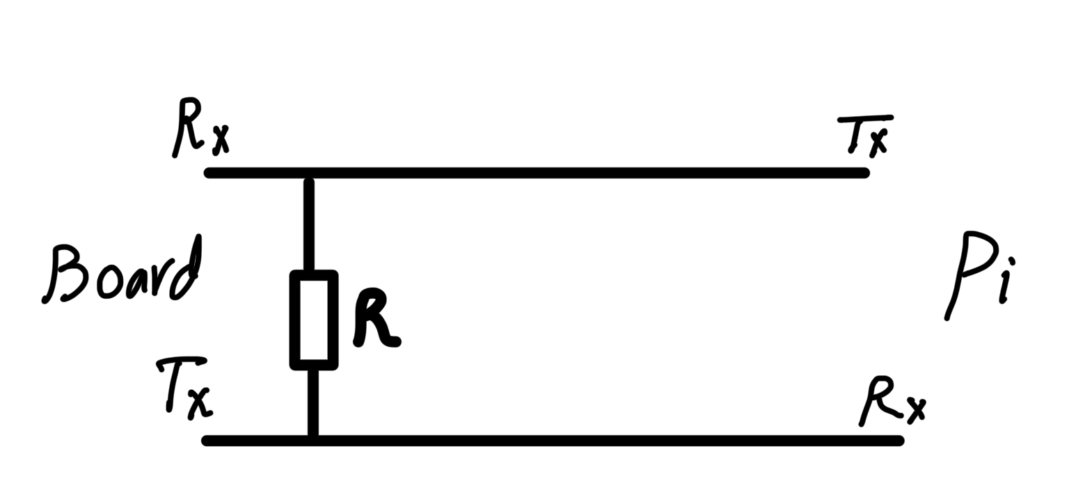

Just small question.
Will this prevent further voltage spikes?
or am I getting it wrong?

The problem was most likely something other than noise if things stopped working during the PID. A simple resistor would not have prevented this problem.

Reading more, I think my problem was not connecting ground between board and Pi
even though it’s not feeding through 5v on board “which is wrong I think” GND between pi and board UART was a must for common ground.
Maybe I’m mistaken.
Live and learn I guess.
That’s correct - you must have a common ground for all the components you’re connecting together.
