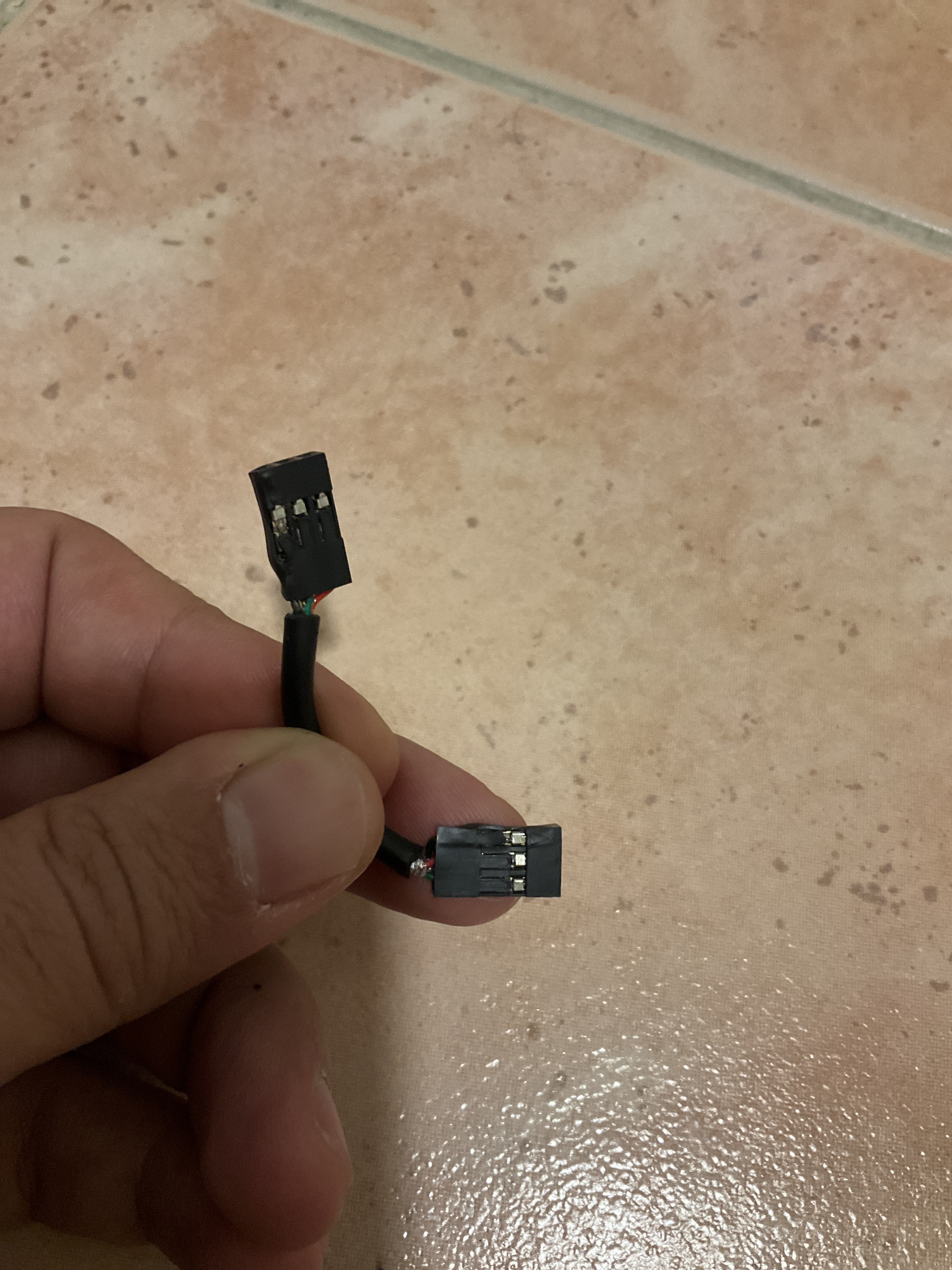

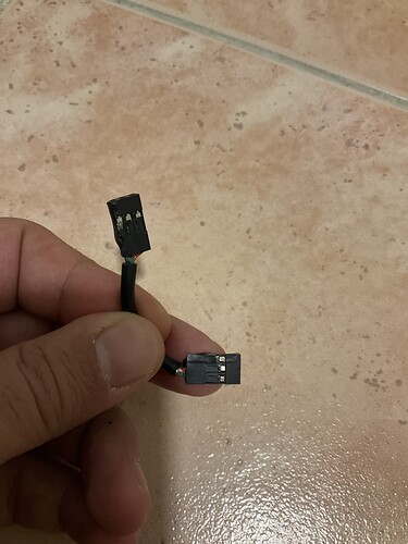

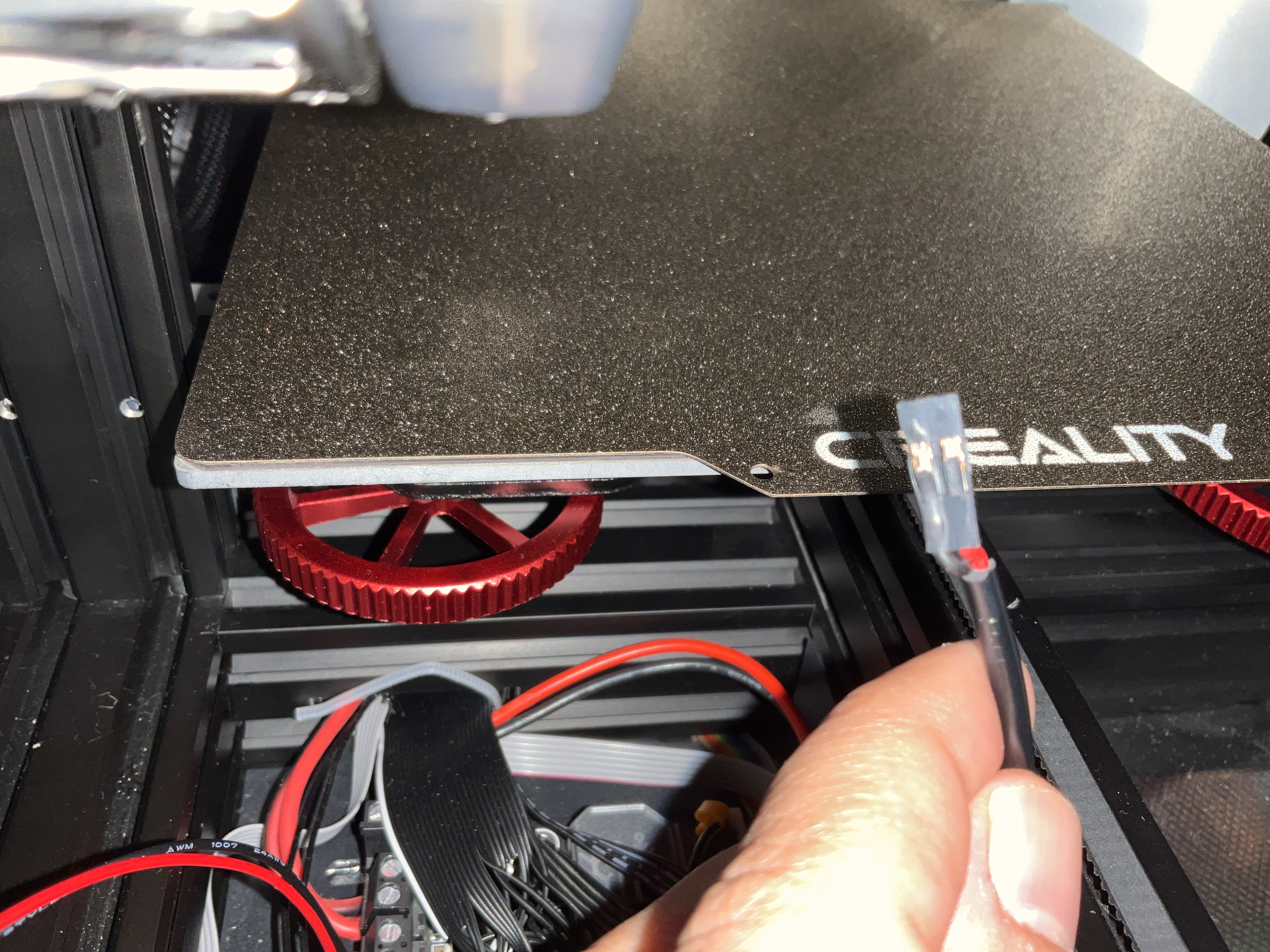

GND wire in power pin and UART are burnt
Printer Model: Ender3
MCU / Printerboard: BTT SKR mini E3 V3
Host / SBC: Orange Pi zero 2w
klippy.log:
klippy.log (7.4 MB)
sudden disconnection this what I found while inspecting.
This is the second pi I got, please tell me it’s fine.

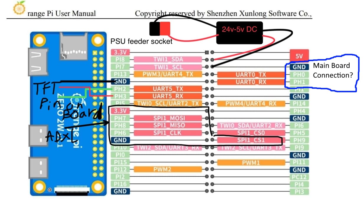

How are you wiring the power in your system? I’d like to see a drawing.
From your pictures, it looks like there are three connections in the cable: GND, UART TX and UART RX. Since is no power then there is current flowing through GND (and maybe the other lines) which indicates a problem with how you to powering things in your system. There shouldn’t be any current running through GND - it’s just a reference between the two circuits.
Again, a circuit drawing is needed.

Where does the TFT get it’s power from and is there a GND to the PSU?

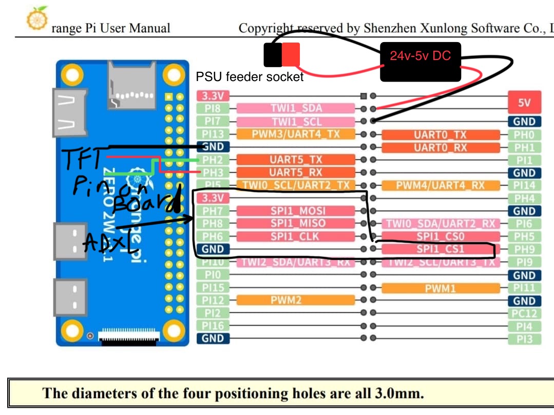

Thanx for the quick drawing.
How is the “TFT” Pin on Board" powered? You’re only providing GND and two UART lines to it.
The ADXL board is only powered by the Orange Pi Zero 2W?
Can you confirm that the Orange Pi Zero 2W is connected to the main controller board as shown here:
I suspect that you’ve been drawing current through the GND line to the main controller board for a while. As time goes by, the wire will break down, little by little increasing in resistance until it let go.
Let’s see the TFT power and see if that’s where the problem. Otherwise, we’ll keep looking and maybe have you do some probing.
Did you connect the grounds at the power outputs of ALL your power supplies, as the Voron wiring examples show? If not, there is a ground potential forming a grounding loop through your RPi, which can destroy most electronics.
If you followed the Voron wiring then I would check the ground connections, also don’t make this mistake, the frame should be AC (earth ground) power supply input side and its metal shield, don’t connect any of the power supply output grounds to any of the frame or metal shields.
I’m only using the available UART there, connecting GND so i get a common ground, the plan was not to burn the whole UART like last time.
apparently not :sob:
You’re not answering the question - how is the TFT powered?
Again, a drawing will be helpful and, from there, we can suggest how to wire things so you don’t have this problem again.
You mean it’s -5v not GND ??
Please provide a wiring drawing and we’ll help you sort it out.

There is no TFT , im using USART2 and GND from that location as klipper UART communication
So the wiring diagram you provided above isn’t accurate?

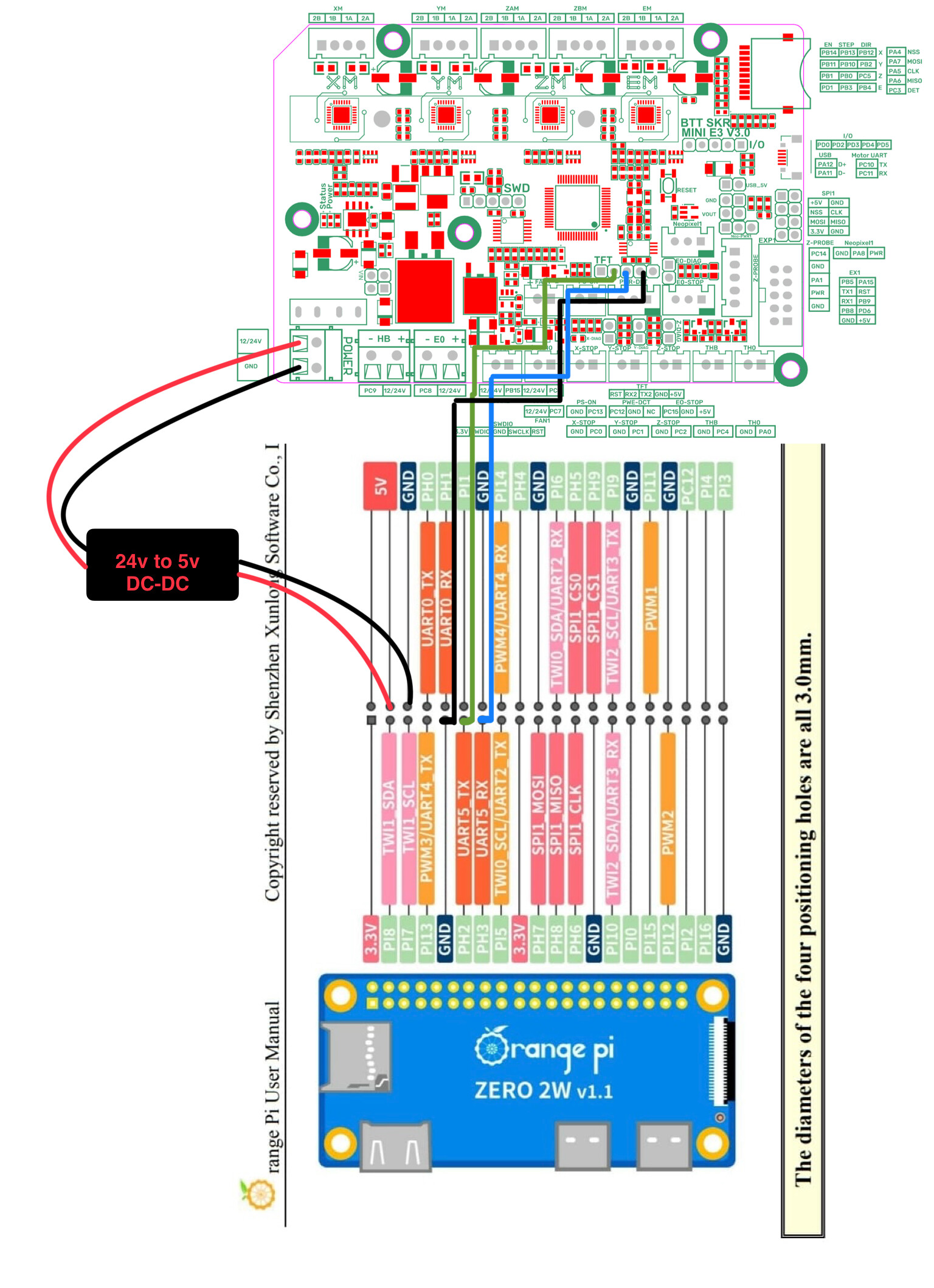

This is how things are connected.
The spi are connected to the adxl345 even though there is no power, so I assume it’s irrelevant.
But for reference the connected pins to adxl345 are:

Maybe we misunderstood each other.
Hopefully the diagram clear things
There is no TFT, I’m using it’s pin for UART connection
Check if Output-GND and Input-GND of your DC-DC-Converter are connected to each other (-> DMM shows close to zero resistance).
@WeissNicht has the right idea here - check the resistance on the Input/Output GNDs of the DC/DC.
Just to be clear, the ADXL345’s SPI pins are just hanging off the Orange Pi Zero 2W and there is no Power or Ground connected to them?
It shows 1.8 ohm, is this good?
The mentioned pins are connected, 3.3v & GND are not
