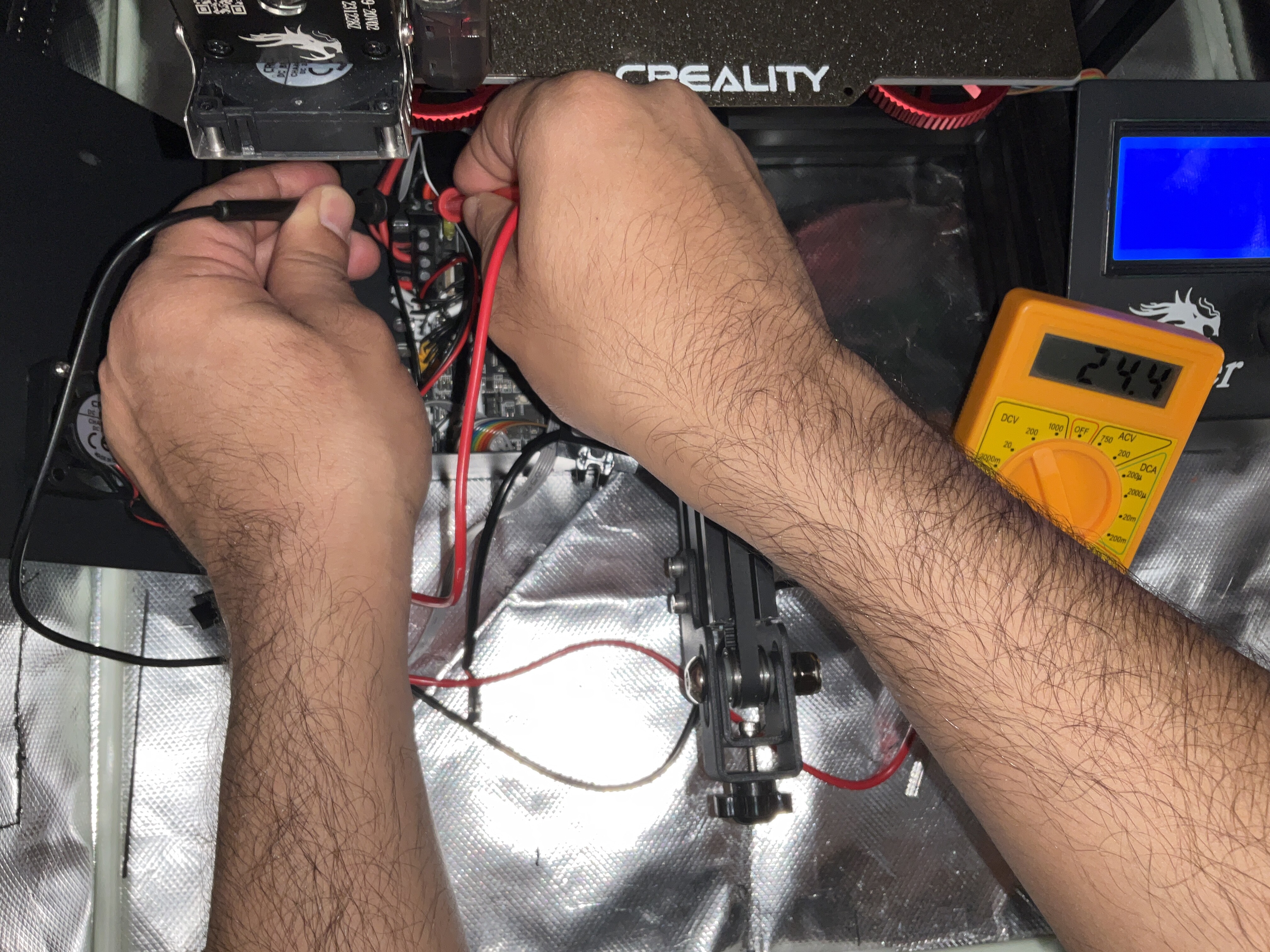

What is the resistance when you touch the two DMM leads together?
How are you powering the ADXL?
It varies from 1.6 to 2.2

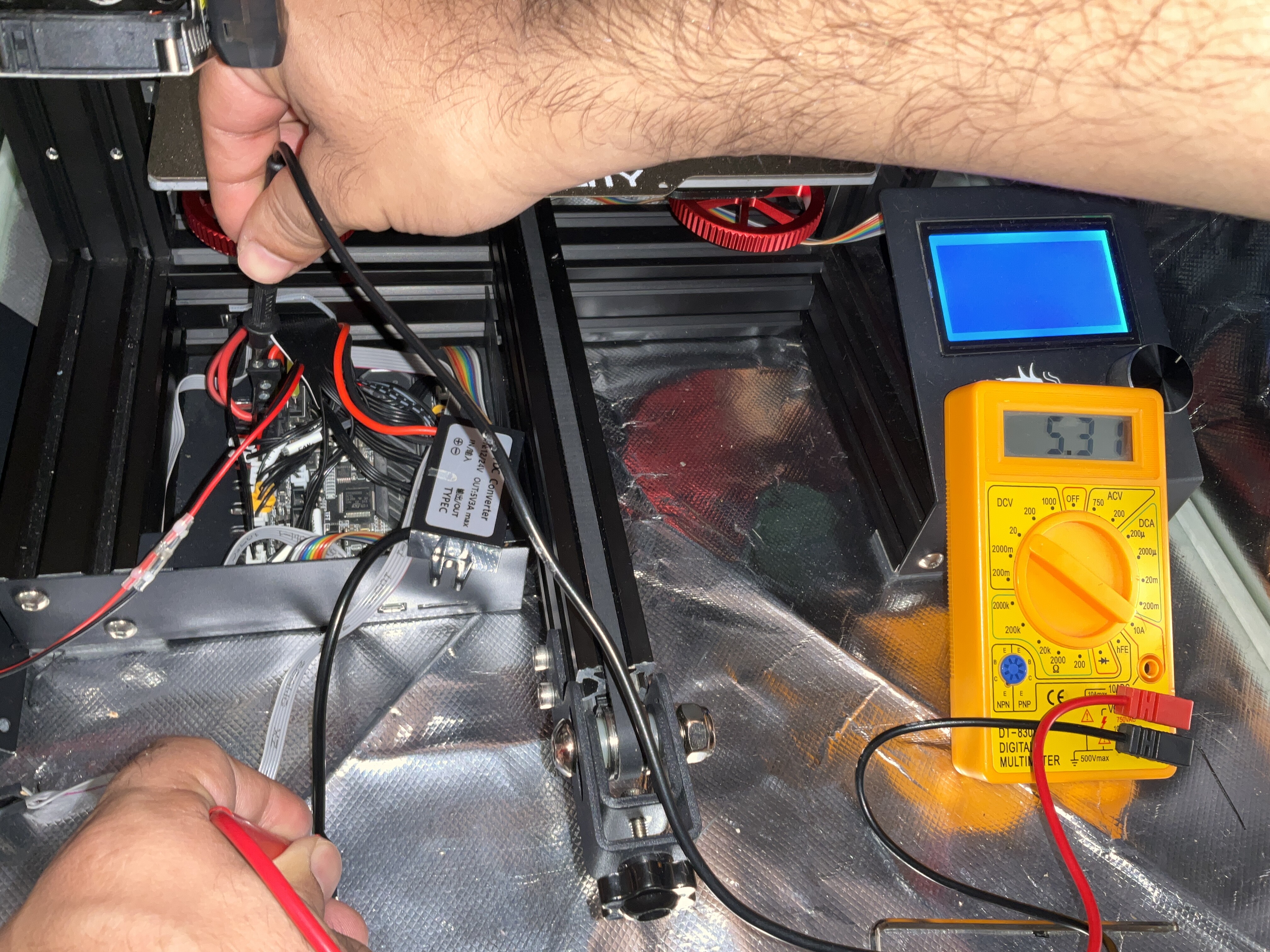

Can you disconnect the 5V DC/DC but leave it connected to the 24V supply and measure the voltage, relative to ground of the main controller board, of “V+” and “V-” of the 5V DC/DC?
What are you trying to show here?
Yes, that seems to be ok. Just to clarify, the DCDC wasn´t connected (in- and output) while measuring?

It was connected to the PSU but it was off

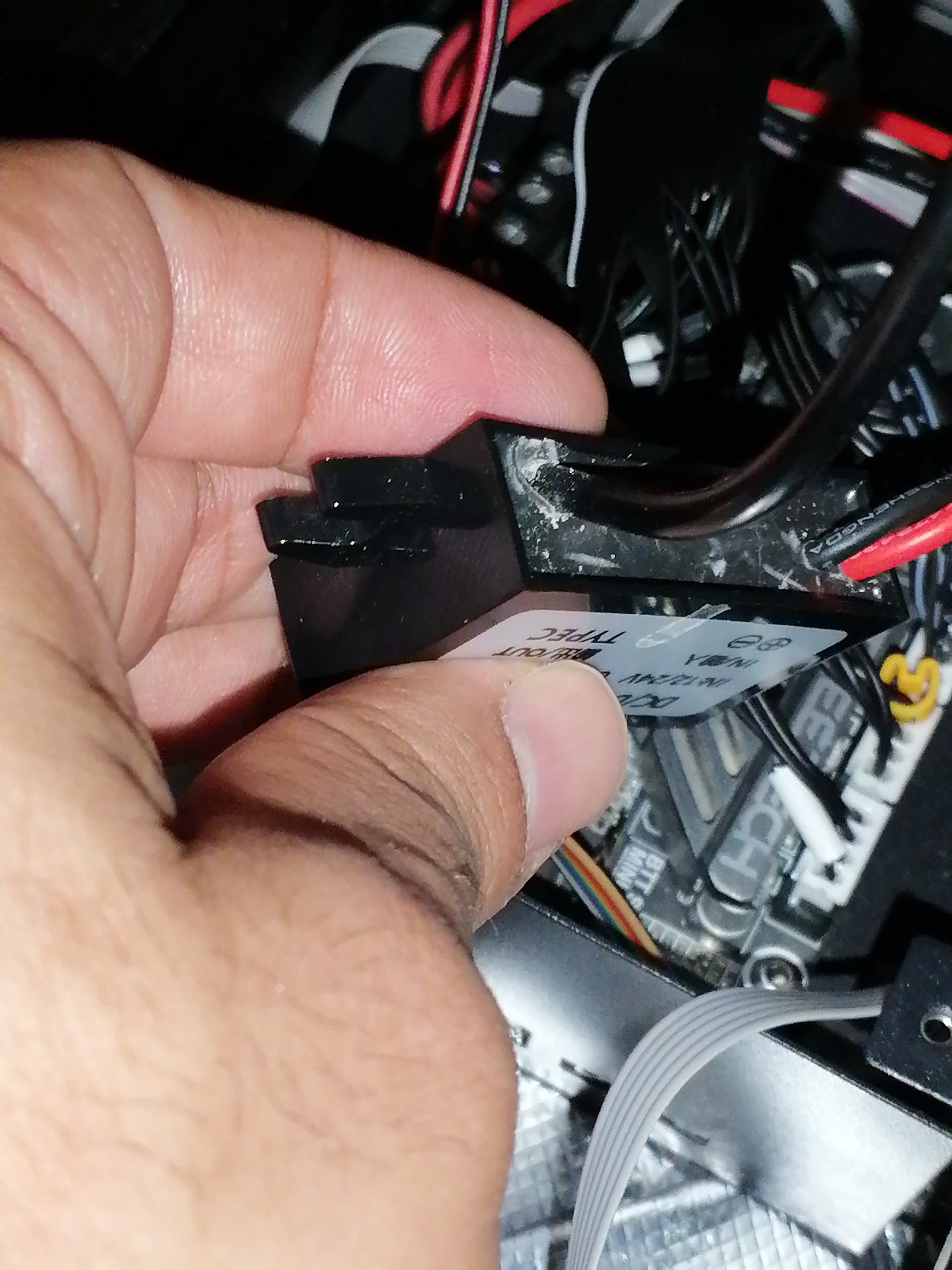

This is bad isn’t it?
What is “it”?
Can I ask you to be as clear and explicit as possible? Even if you think you are repeating yourself it would be helpful for us to understand exactly what you are talking about.
Those cracks in the compound are no clear indication of something bad going on. It seems to just be some stress on the cabeling entering the compound.
When all cables where attached while measuring, you won´t be able to measure the internal connection between the Input and Output GND. At least the Pi-Side has to be disconnected in order to measure the internal resistance. There are some DC/DC with galvanic isolation; the measurement is to see if this is the case on your DC/DC.

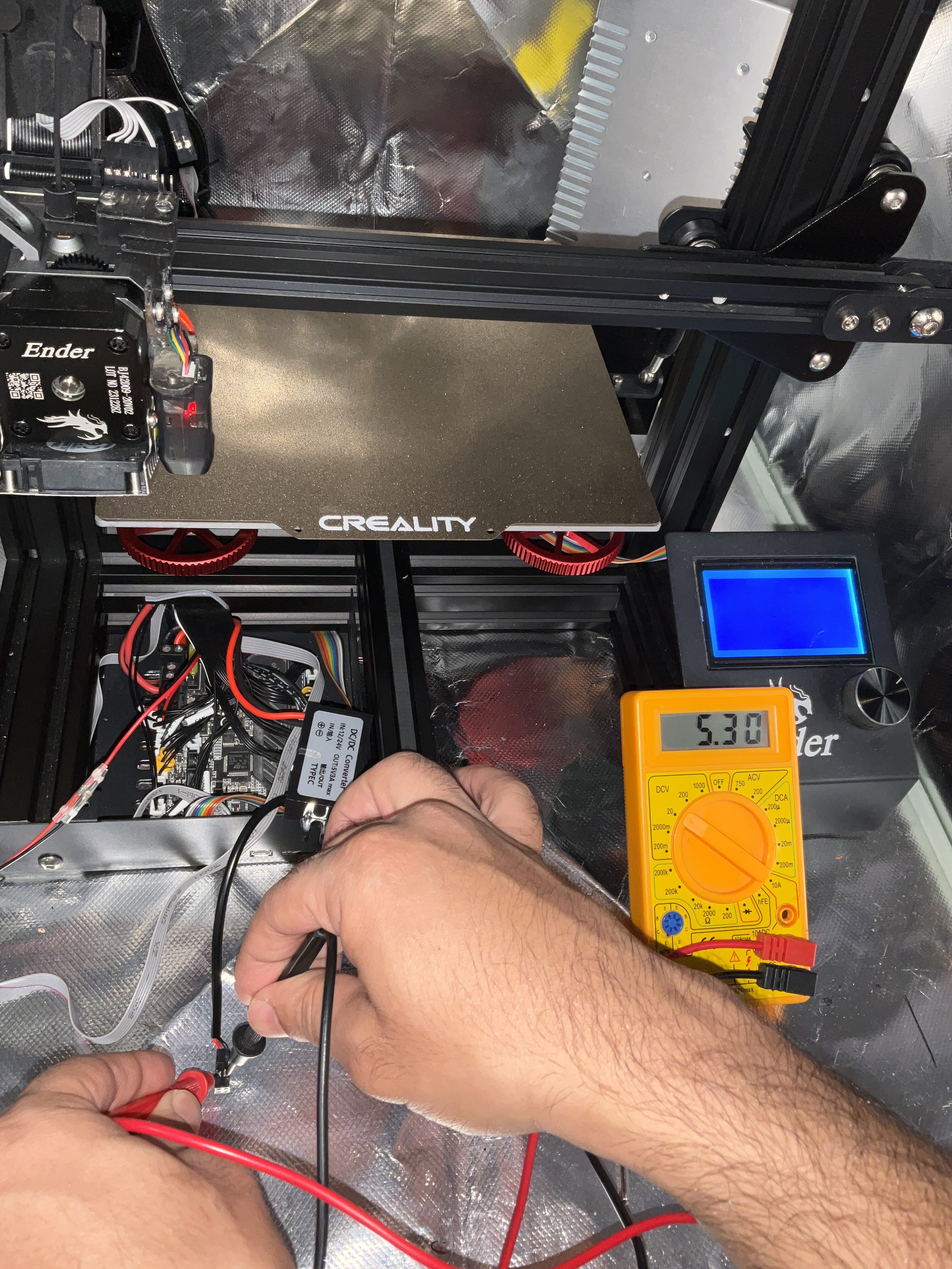

You are measuring the output of the 5V DC/DC relative to its Ground not relative to the Ground of the main controller.
You should have your Red lead on the output of the 5V DC/DC and the Black Lead on the Black wire going into your main controller board (I believe that is where you are getting the input power to your 5V DC/DC.
As a secondary point; that 5.30V shown on your Voltmeter is concerning. The Orange Pi Zero 2W is a very low end device built the cheapest parts possible to do the job.
The ETA3409 (I went through the Orange Pi zero 2W’s schematic) used to drop the (nominal) 5V input to 3.3V used in the device is really marginal for this application.
If possible, I recommend that you dial down the output of the 5V DC/DC or replace it with another that outputs something closer to 5V.

Can you measure the voltage between the main controller Ground and the 5V DC/DC Output Ground?
i did, it’s 0v, couldn’t take pictures though.

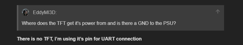

What is this LCD? When asked about the “TFT” you replied:
Again, you need to be absolutely clear on the printer configuration and how it is wired. This is post 34 of this thread, it’s gone on about three times longer than I would have expected and it’s due to you not being accurate, clear and consistent about the printer’s configuration and wiring.

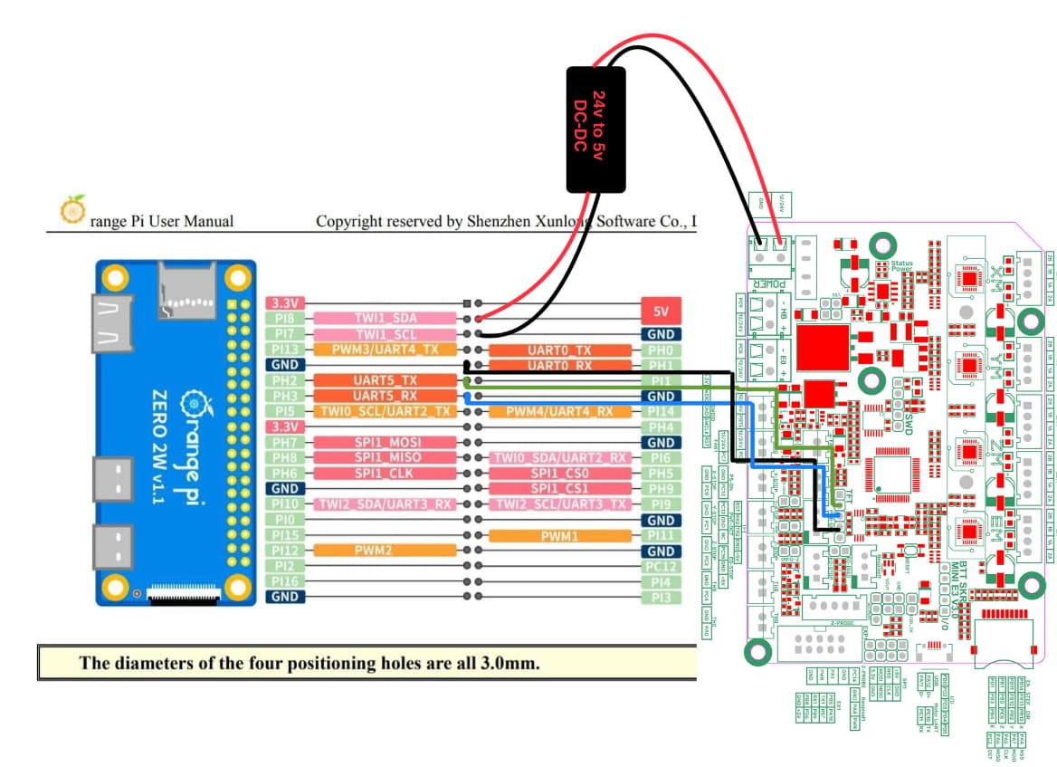

You have put in two incomplete wiring diagrams and I am assuming that the second one:
Is correct. There is no LCD or TFT. There is no ADXL.
If this drawing is not correct, then you need to clarify things now and provide information that is absolutely correct.

stock LCD, EX1 pin have UART1, which appears to be working.
I did mention the modifications added to the printer in this post, meaning everything else should be stock.

Please do a diagram
Before we can go forward, you need to provide a single, accurate electrical drawing of your system. In that, all the peripherals connected to both the main controller board as well as the Orange Pi zero 2W need to be included.
I asked for this as the second reply to this thread and you have provided conflicting information on what is in the system, how it is wired as well as two, incomplete, wiring diagrams which show different connections and peripherals.

my guess is that voltage caused VCC-IO burnt in both boards, I will make time to inspect for marks and hopefully finding a technician with the right tools to do the job, hopefully it’s something repairable.
Also there must be a potentiometer in the printer PSU, hopefully is easily located to bring voltage down to acceptable limits, thus bringing down that 5.3v in converter to acceptable limits.
