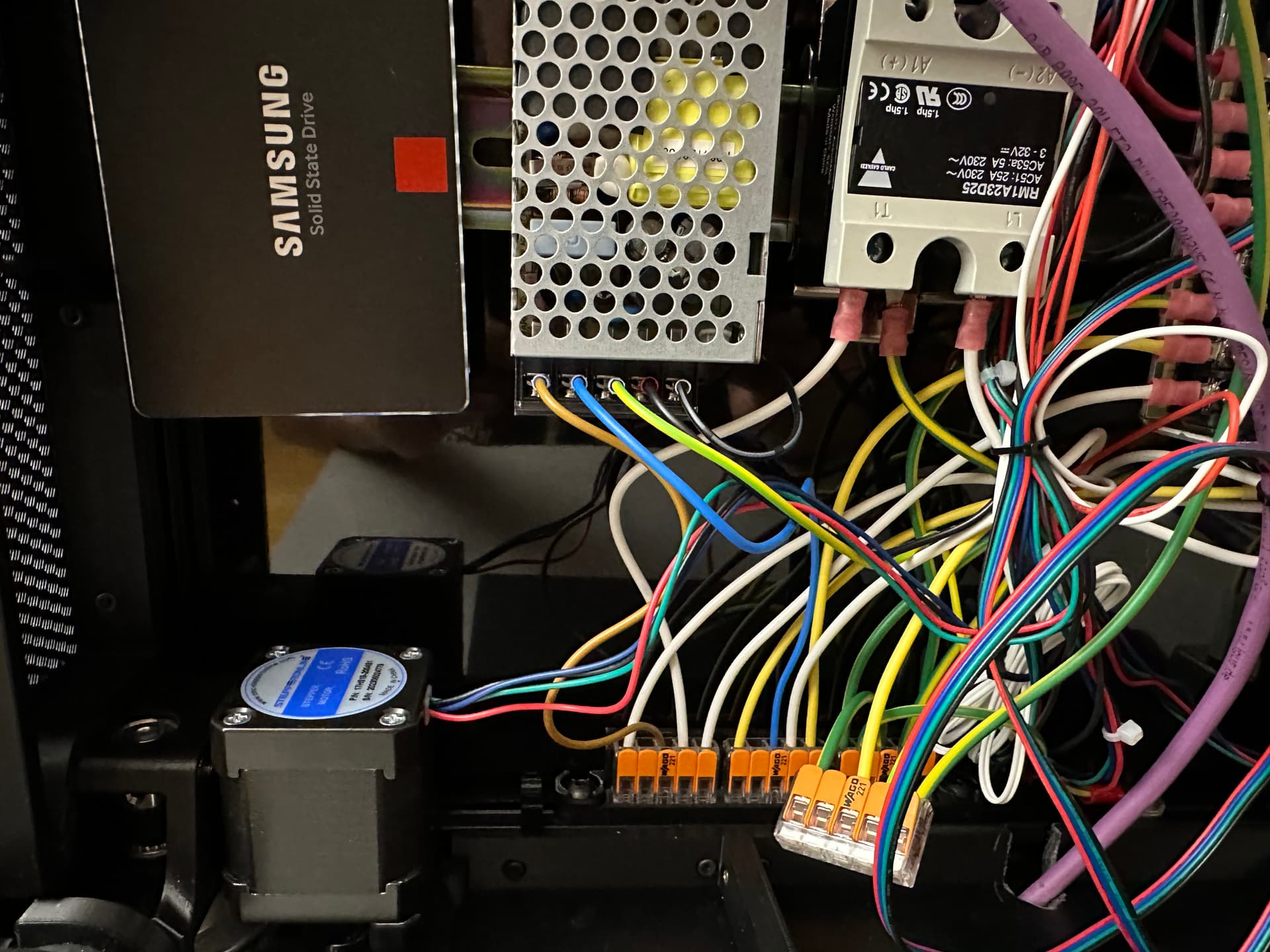

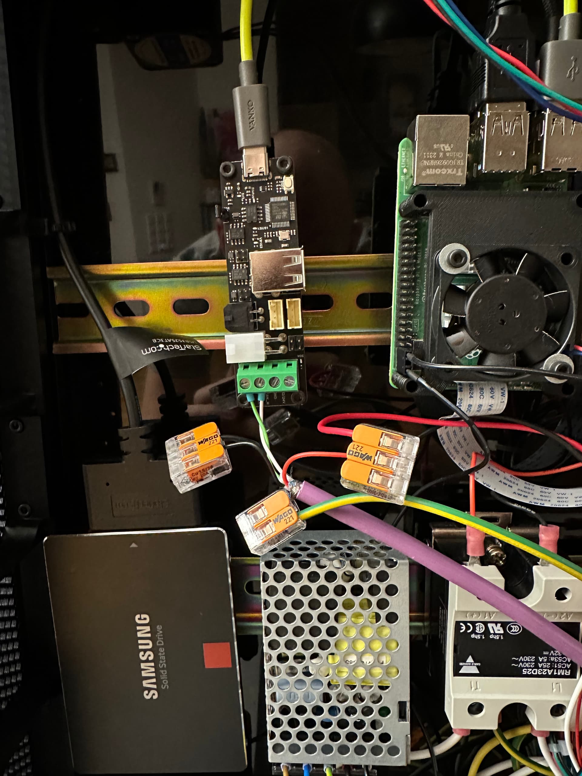

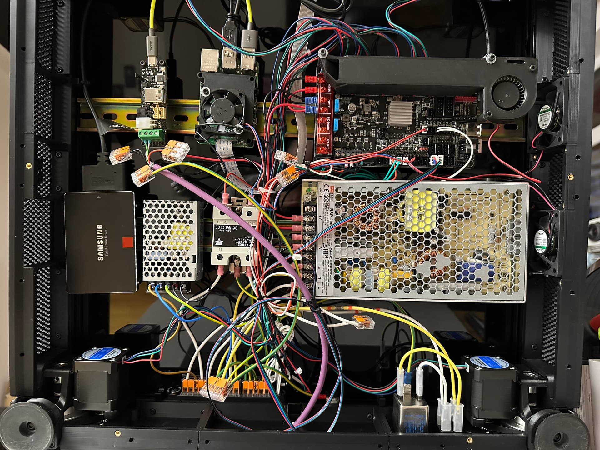

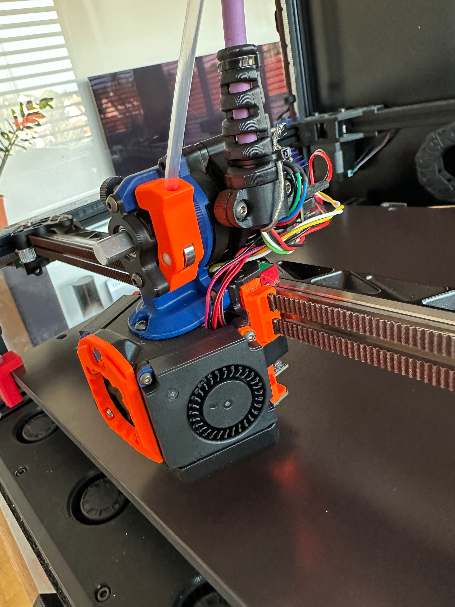

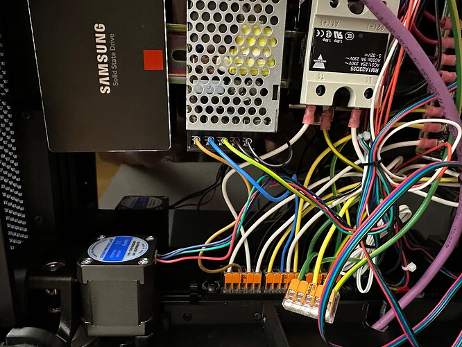

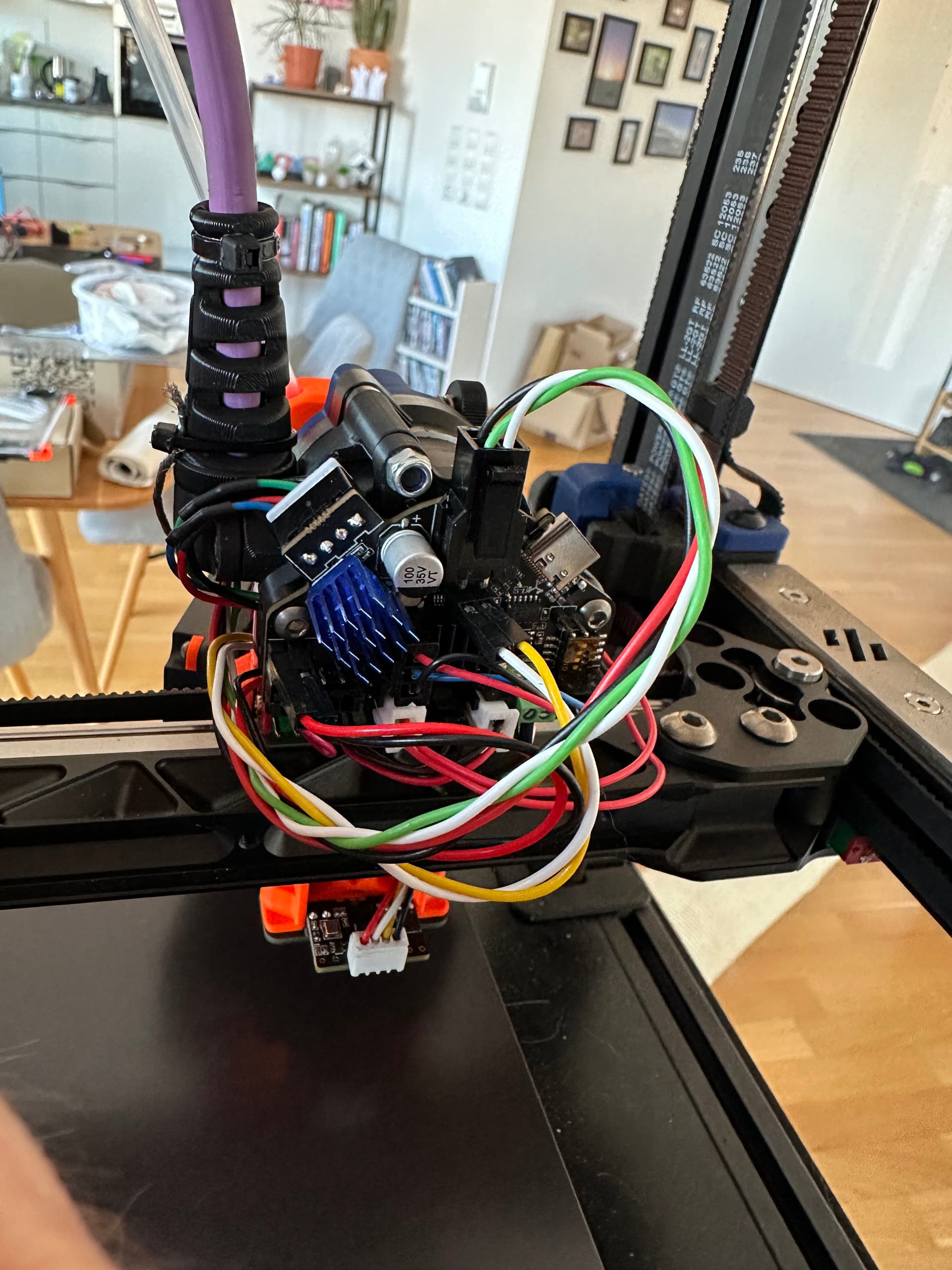

Here are some pictures of the wiring:
The Can umbilical is AWG20 for the 24V. This could be a bit small right?
I have problems with the can bus only. No other problems.
I changed quite a lot in the last few weeks. I swapped my Aluminium bed plate against a graphite one, changed from XOL with G2E and revo voron (also with EBB36) to a self designed extruder with G2E and EBB36. Problem is, I’m not really sure when the problem started. I think it started after I swapped to the own extruder. But I haven’t changed any electrical hardware…
Some things here to work with:
  1. “The 24V PSU is a meanwell RSP-200-24”
    – That’s going to a bit tight to provide enough power for your system - That bulk supply will provide a maximum of 8.3A.
    – I presume you have your steppers set to around 0.8A each (that’s what I have), so when X/Y are moving you’re drawing the full amount and probably around 0.5A or so for your Z axis steppers when they’re idling/keeping position, you’re probably drawing 0.5A for your extruder - that’s 4.1A right there. You’ve got a number of fans and they probably take at least 1A. Then there is the Octopus, U2C and EBB36, together they’re around 0.8A. I presume you have at least a 40W heater on your extruder - that’s another 1.7A when active. The big difference between what I spec’d out above and my system is that I run with a 50W heater (which would add another 0.4A).
    – This works out to around 7.6A and I don’t know if you have anything like extensive LEDs or a TFT display running (it looks like you have display attached to your rPi). You don’t have a lot of current margin here - less than 10% of the rated output with what I’ve listed here.
    – Personally, I run with a Mean Well LRS-350-24.
  2. What is the “Samsung Solid State Drive” doing in there?
  3. The changes you’ve outlined shouldn’t have resulted in any issues.
From what you’ve outlined here, I would recommend getting a heftier bulk power supply.

There is a separate 48V 70W power supply to power 2 TMC5160, which drive those motors.
So, if I measure the current from the PSU to the drivers, it is always the sum of the current to each motor. Assuming both motors do an equal job in standstill or moving the portal, I can also simply assume that the RMS current (and the power) would be split equally between them.
Hope that clarifies my calculations.
